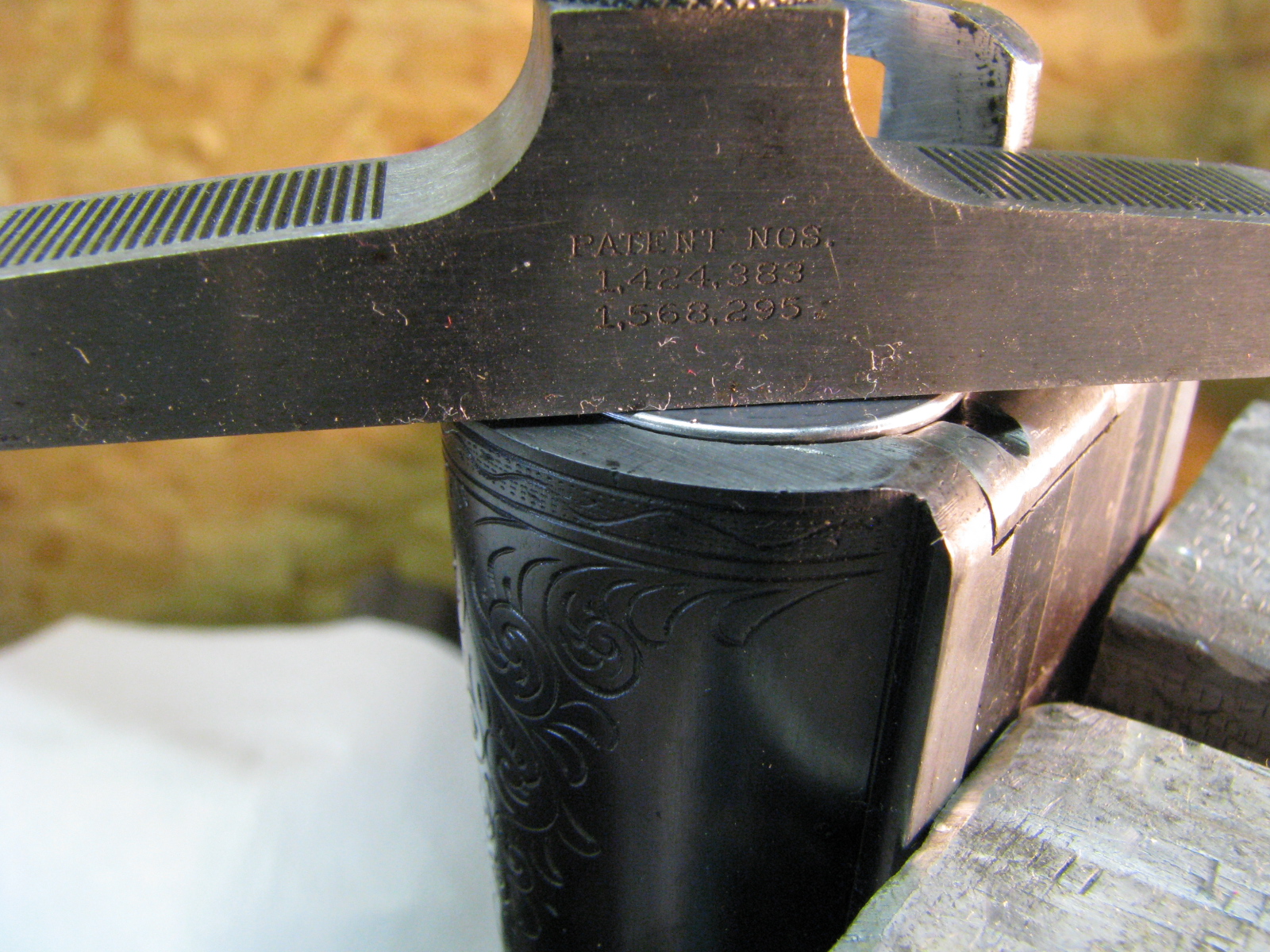

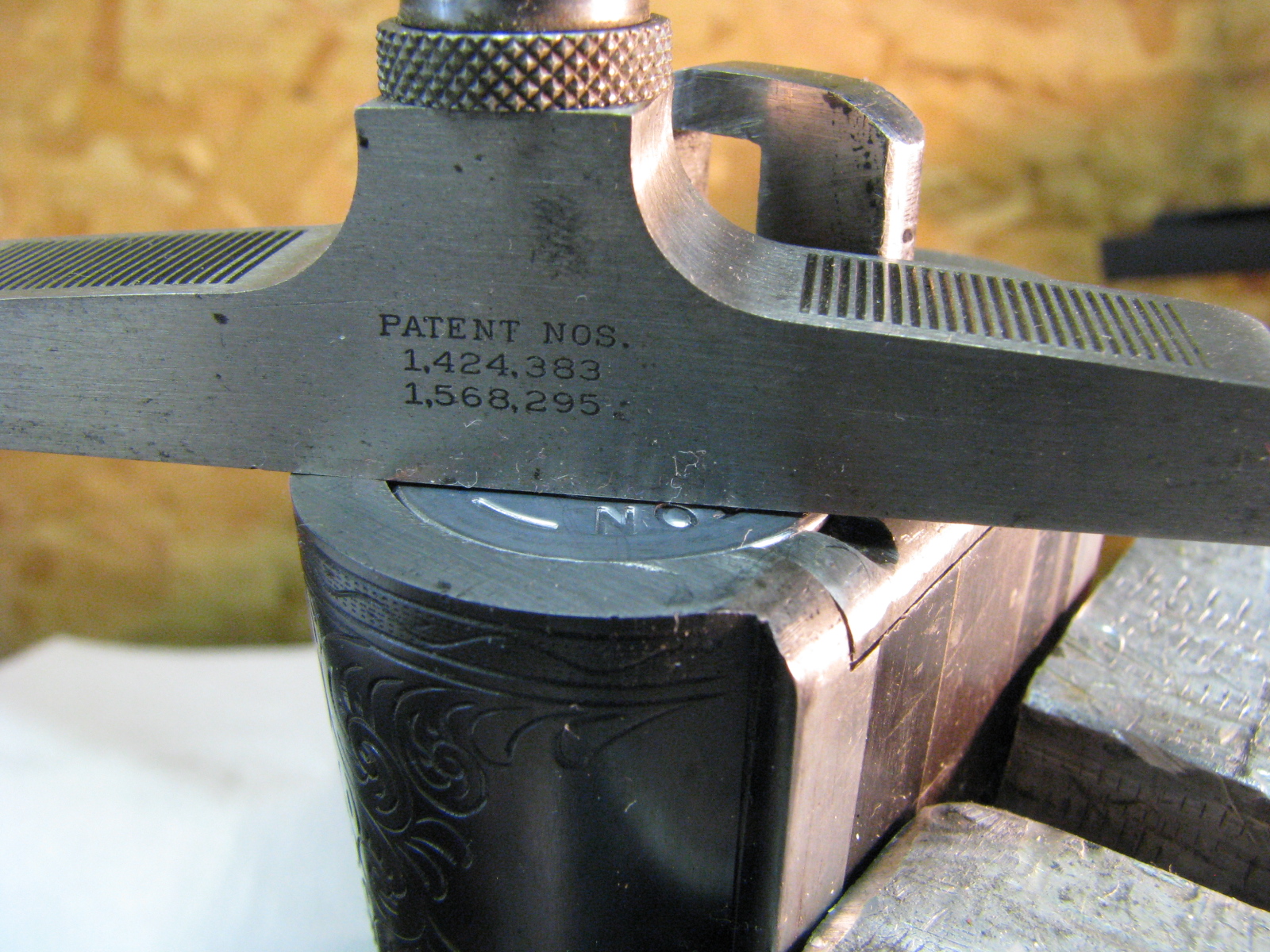

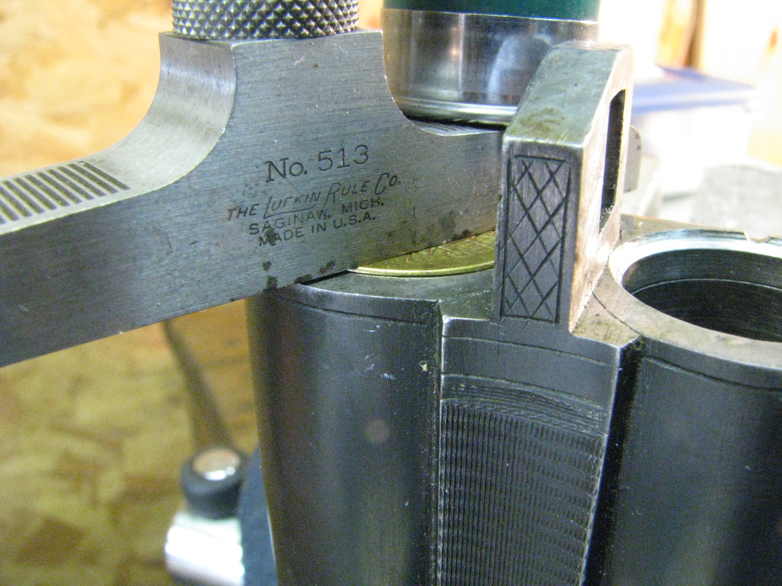

Kevin, I never saw your HE and not sure what Orlen did on "recutting" but rim cutters are commonly available from Clymer and others to true, deepen or to cut shotgun rim countersinks into virgin barrels. The cutter pilots in the chamber and is turned with a large tap wrench while the barrel is held vertical in padded vise blocks or similar. I have a 12-16-20 gauge set of cutters and have used them many times to true and deepen rim cuts that weren't deep enough for modern shotshells and were causing hard closing and forcing the barrels off face when shells were chambered. Ever see guys slamming their Fox or whatever closed to get the locking bolt to engage? Keep shooting that way and eventually the barrels will be sprung off face permanently. That condition is far more common than many realize. A depth mike is used to check for proper spec as on this Fox CE 12 bore, before and after pics below. frank

Another Fox “as found". As Kevin replied, some few vintage guns by orher makers also left their factory with shell rim countersinks a bit too shallow for modern shells. You can check your guns with a 6" steel pocket ruler or anything similar with a straight edge.

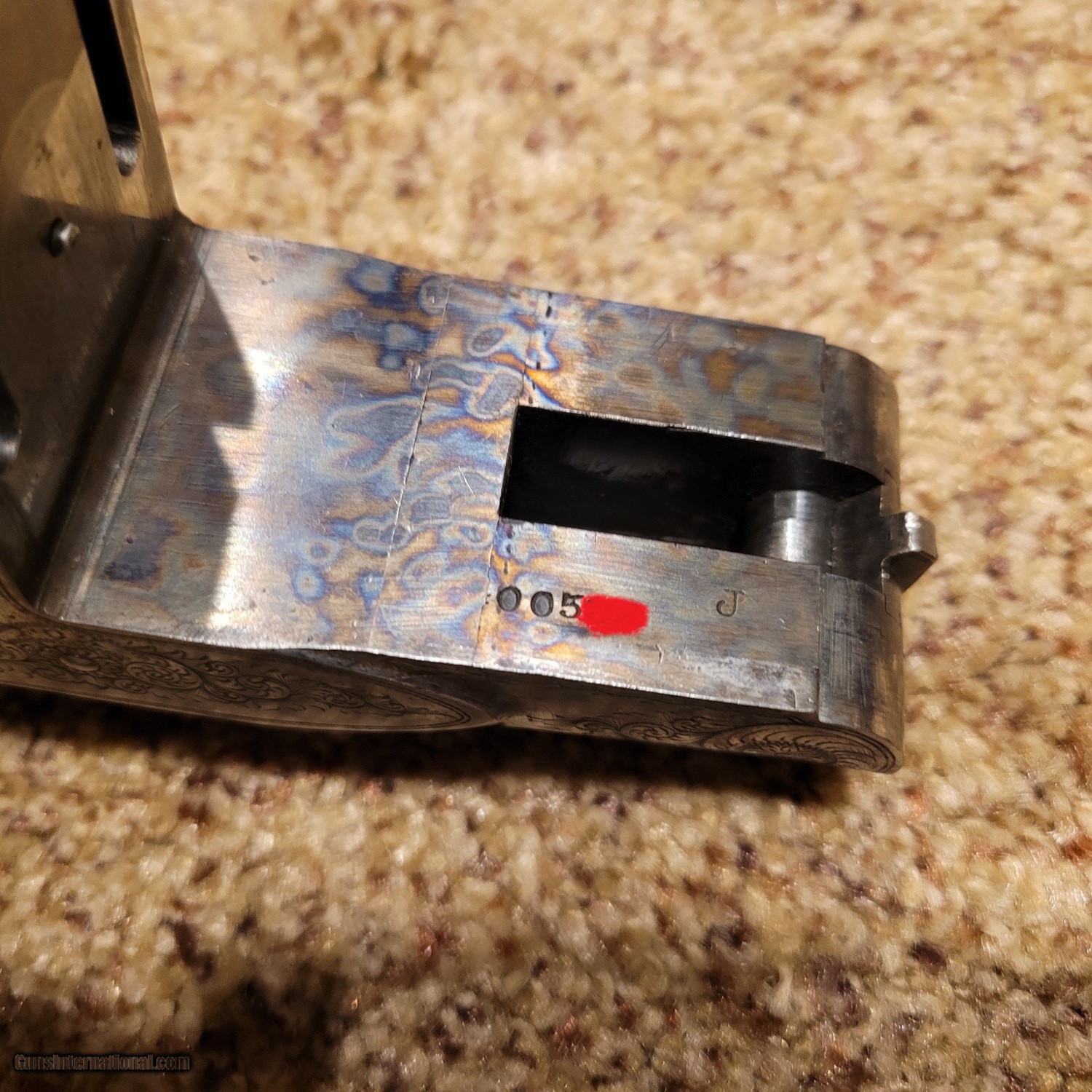

Not the worst I've seen but here's a Fox J-Grade SBT gun that was advertised a while back with an insert over the broken out web in the frame where the cocking slide presses when barrel is heavily opened. Serial number partially cut out which is a no-no; seems like the guy could have stamped a leading "4" to at least try to comply. Also nicely recolored with an oxy/fuel torch. :wink:
Obviously the machinist used a milling machine to do the the insert and I wonder why he didn't do a smaller cut along the long axis of the frame and microweld over the edges of an insert before finishing flat? frank
