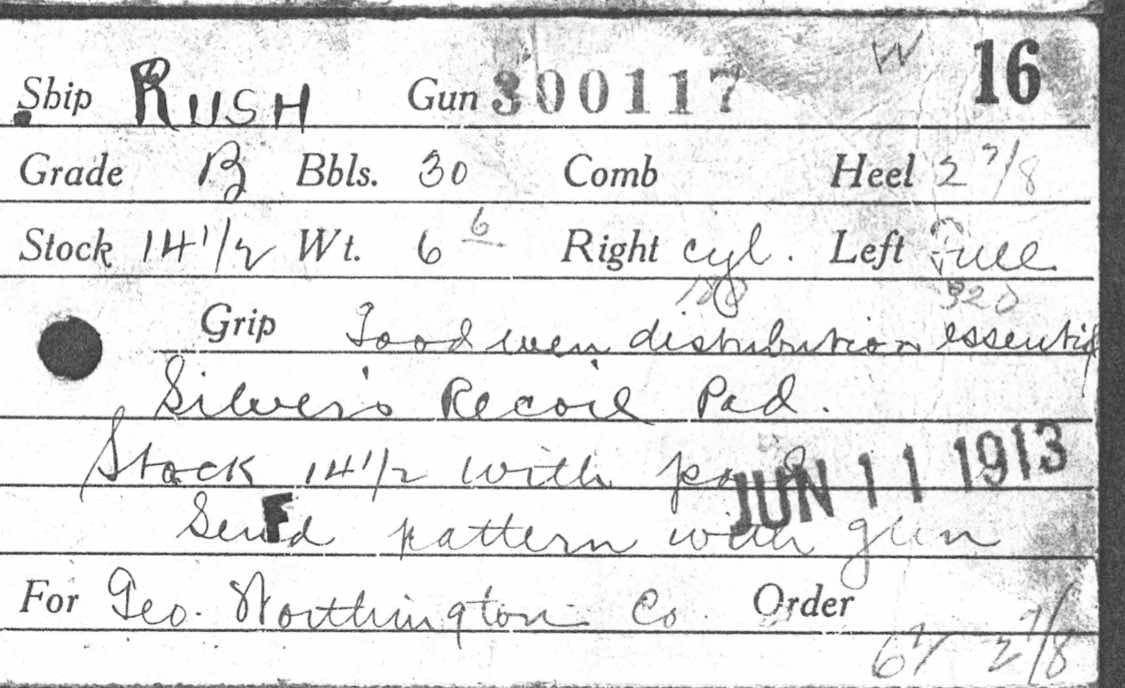

I had a question I thought this group might be able to help me with.
I recently purchased a lovely little B Grade 16 gauge. The stock was broken and needed some work, but I felt comfortable with that. After I received the gun and posted on Facebook, a member sent me a photo of the build card that indicated this gun’s 26” barrels had been specified as 30” barrels on the build card. Disappointing, but because I bought the gun to hunt with as well as appreciate for its history and character, I don’t feel completely heartbroken.
Now to the question - from looking at this card and other examples I’ve seen online, there appear to be certain specs that were written down twice - stock dimensions and weight. My curiosity is if this duplication is for specs written down when the order was placed (darker writing in the named fields on the card) and documentation of the same specs when the gun was finished (at the bottom of the card in lighter writing). I have seen these duplication of specs on multiple Fox build cards and the example at the to of the Fox forum shows these as well.

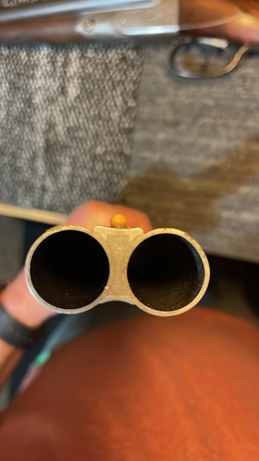

If this duplication is for ‘ordered’ and ‘finished’ specs, the photo of the card for my new gun shows 6lbs 6oz at order, and then 6lbs 2oz at time of build completion. The interesting thing is this gun currently weighs 6lbs 1.5oz, and I would think lopping off 4” of barrel would remove more than half an ounce of weight. I have measured the barrels, and there is no choke or taper whatsoever - a true CYL & CYL, so I’m expecting these barrels were cut down at some point. That said, it seems whoever cut them did a very tidy job and I’m wondering if maybe they were done at the factory. The build card does specify “Good even distribution essential” and so maybe the 30” barrels were too front heavy…
I know this is incredibly speculative with maybe a dash of foolish hope. Is there any benefit of ordering a letter for this gun, or will they simply look at the build card and tell me what I already have in this photocopy? Is there more information that can be referenced to tell more of the story on this gun?

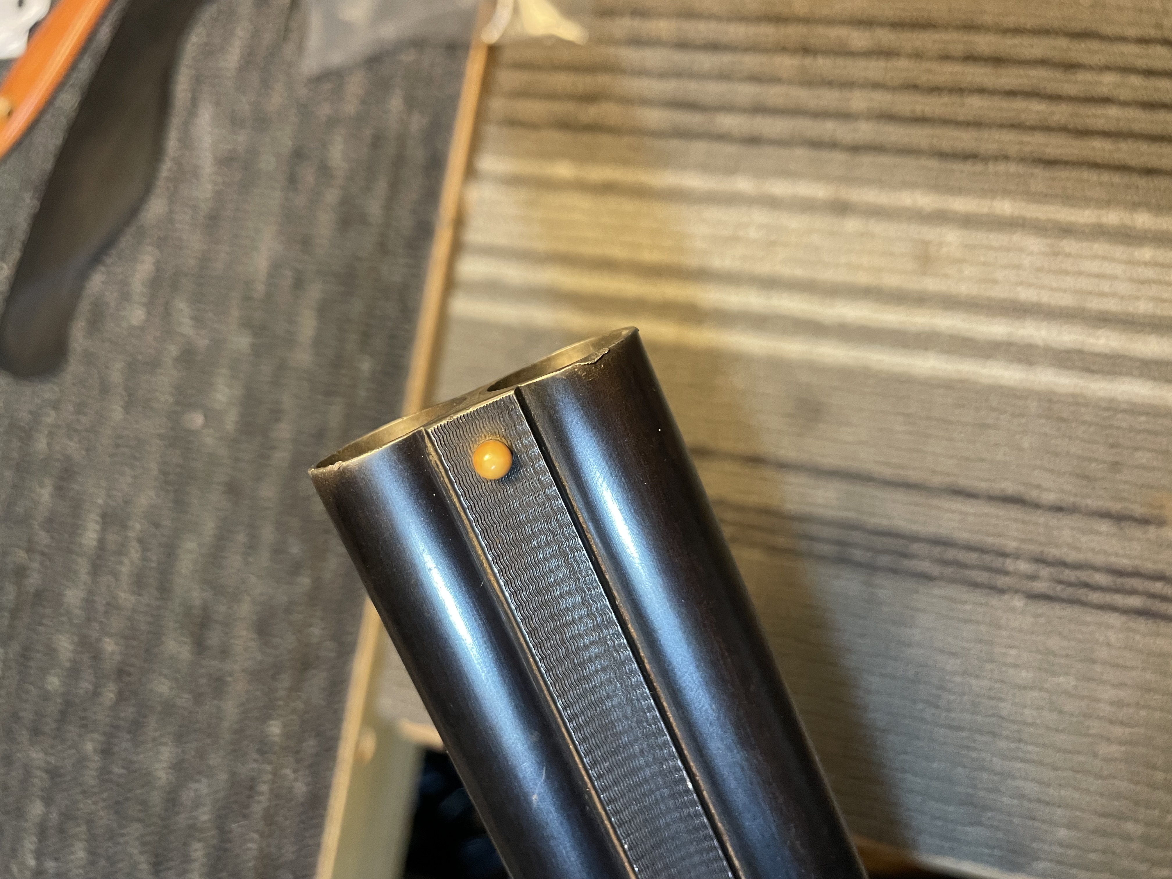

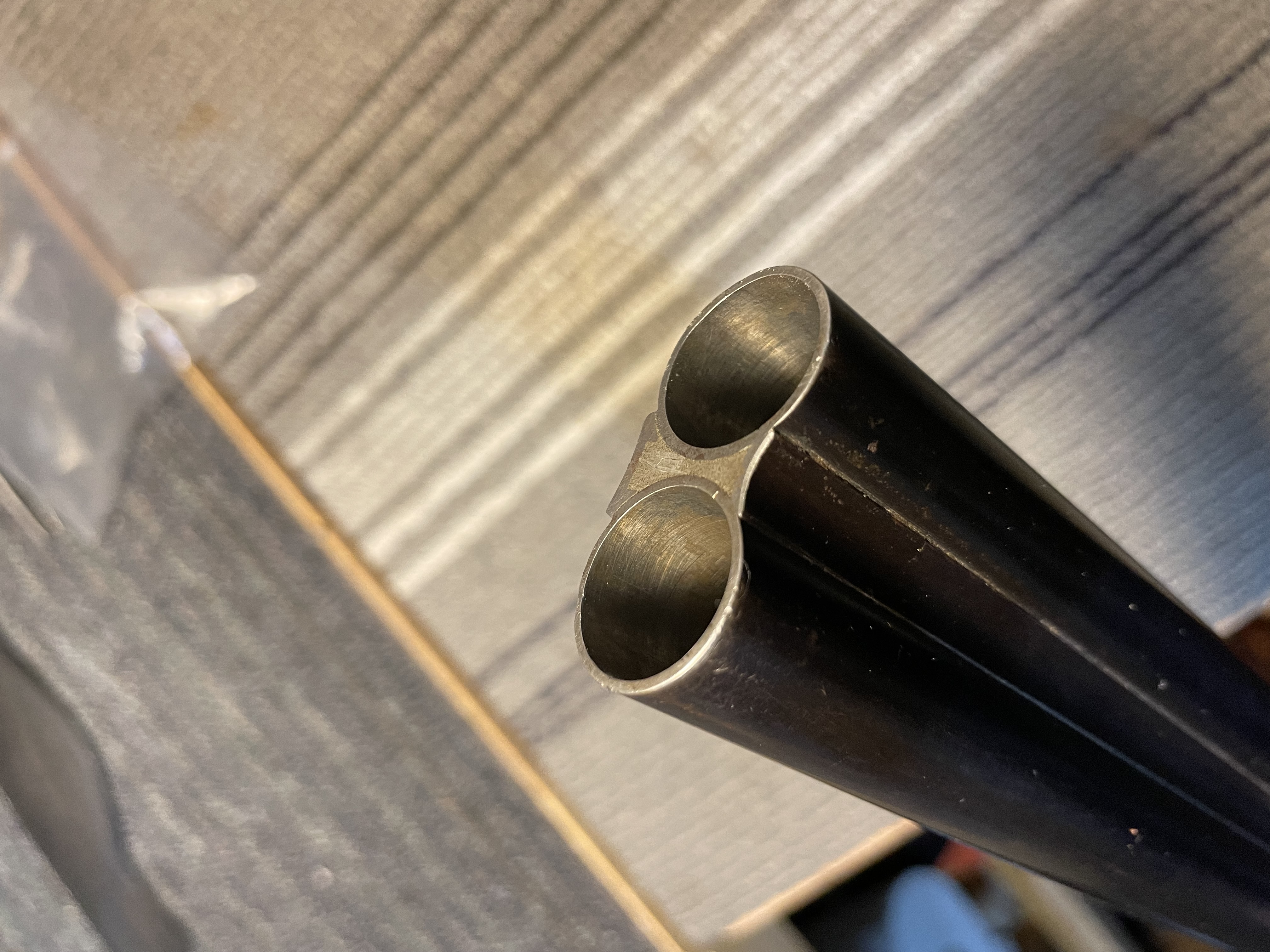

No question the barrels were cut in my mind, sorry. To me it appears the as finished weight was 6.7 not 6.2. We believe the dimensions at the bottom of the card were "as finished". Could the factory have cut the barrels maybe, but I think it's wishful thinking. I would think if the factory cut the barrels they would have replaced the keels, not sure.

My understanding is a letter will provide the same info as the order card. The exception is when there is additional information written on the back of the original order card. We (Fox Collectors Group) have a CD containing photo copies of the factory order cards. We however don't always have a copy of the rear of the order card. Just the way it is. Cody has the actual order cards in their possession, so if there is info written on the back of the order card, they would add it to the factory letter they provide.
PS. In my mind the barrels have been cut. That said Fox chokes are so long I would have thought there would be some choke remaining.

The numbers under the Choke designations are the pellet counts presumably as tested with the original Cyl and Full chokes and both counts coincide with what would be expected from those constrictions. And as Craig indicated the factory would have replaced the steel barrel keels; what I see in the pic is solid solder. Barrels have been cut, period. But from the look of that aged ivory sight I'd say that had been done long ago.
I searched for 300117 here on the site and don't see where any member asked for that Card copy from the AHFCA. So, someone on Facebook is issuing Card copies? Those who bought the Card CD's from the AHFCA agreed in writing not to use the info except for their own research. I suggest that our Exec Director look into this. Brett, aren't you on that FB group? I think our BD member Jeff is too. Likewise with VA Tom though he isn't a BD member. What's up here gents? frank

Thanks all. I also don’t disagree the barrels have been cut. Just curious if there’s a chance that might have been done at the factory. That said, if they’re taking the time to note finished weights and stock dimensions, they would probably have made a note of the barrel length changing. Maybe I’ll send in for a letter anyway and see what comes back.

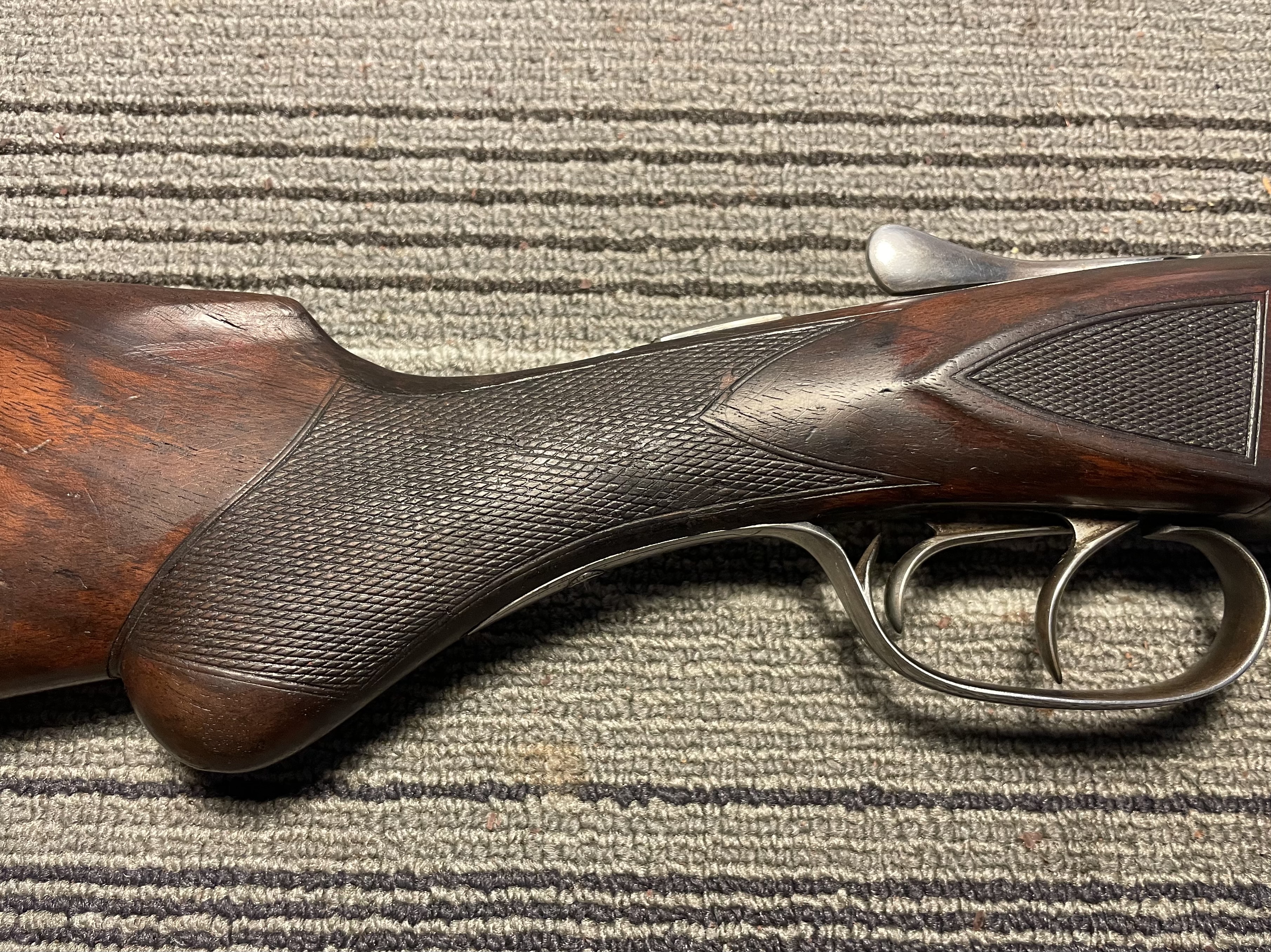

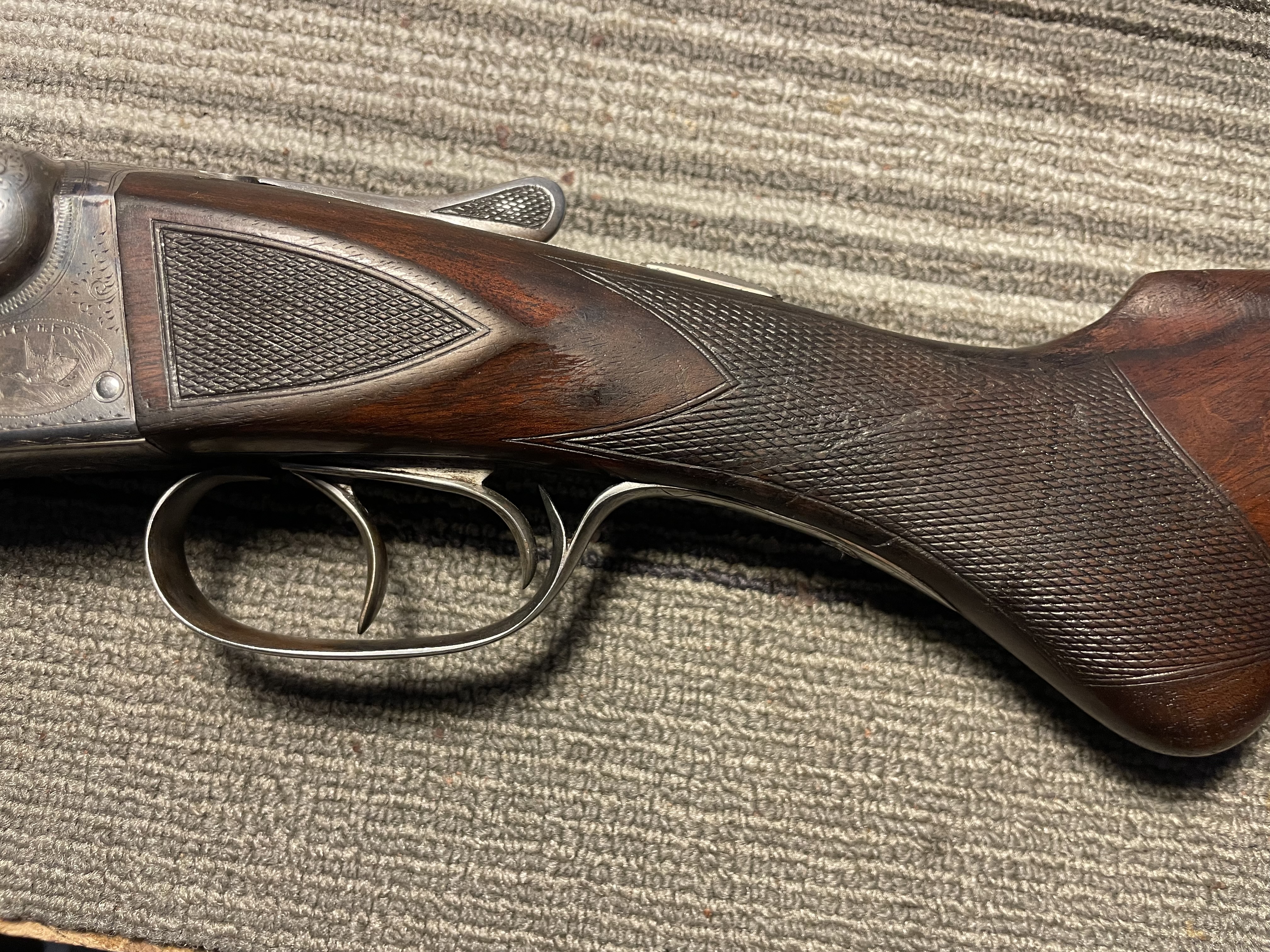

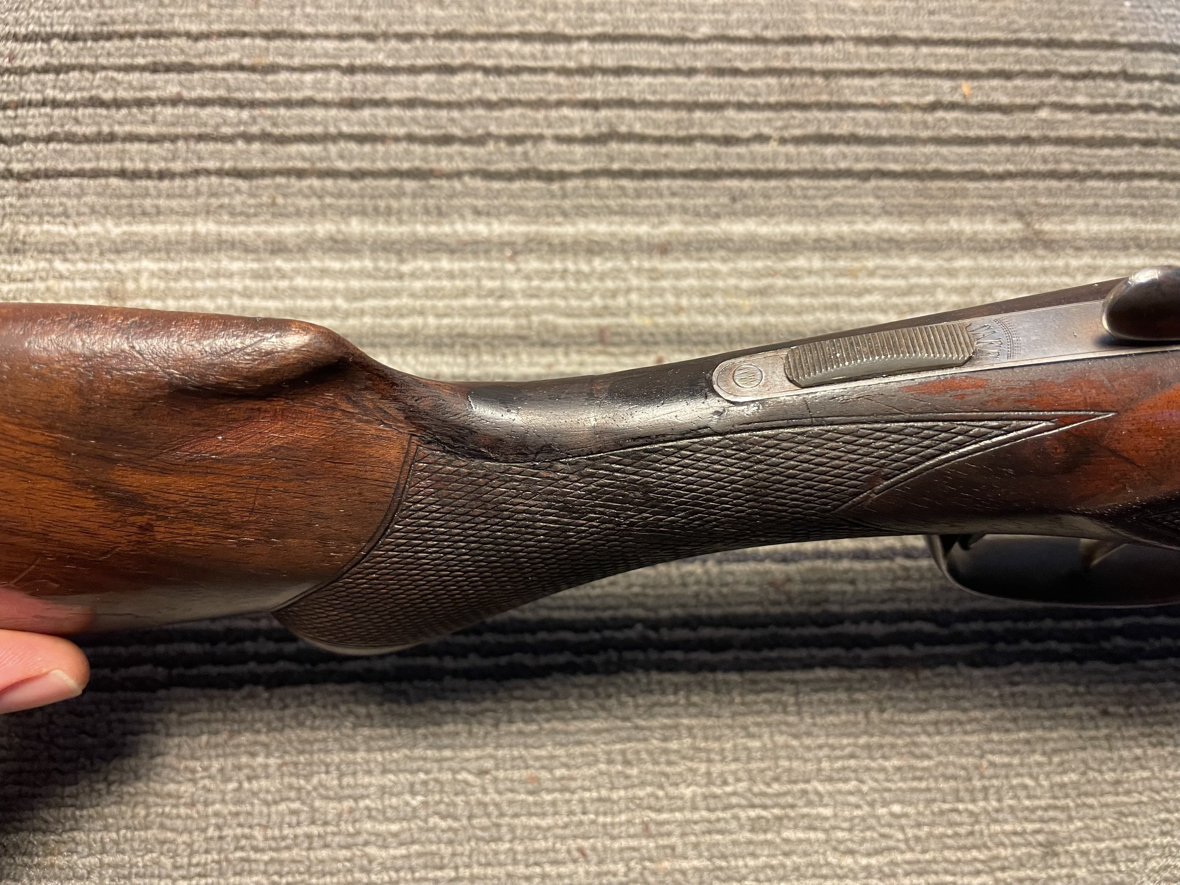

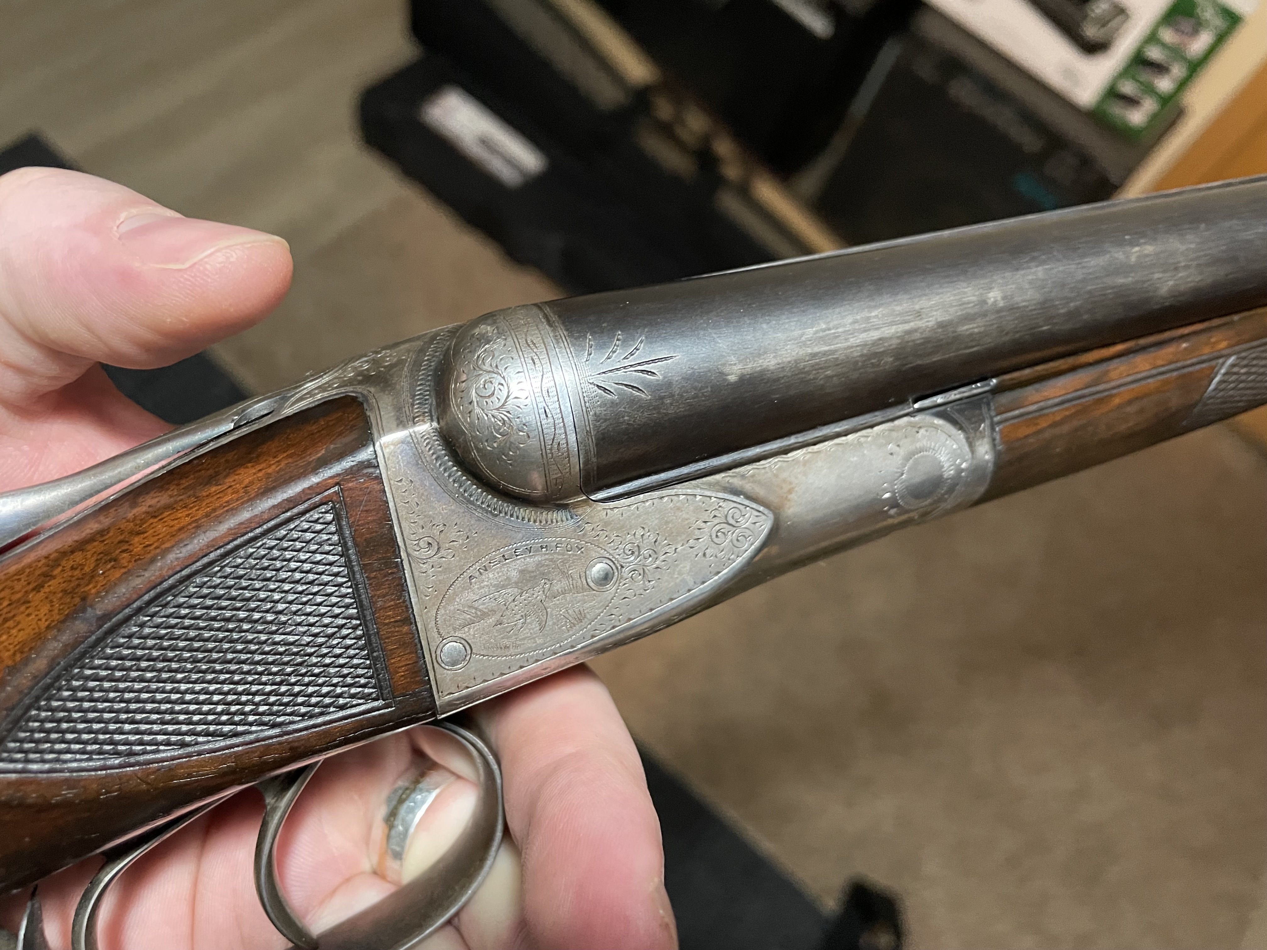

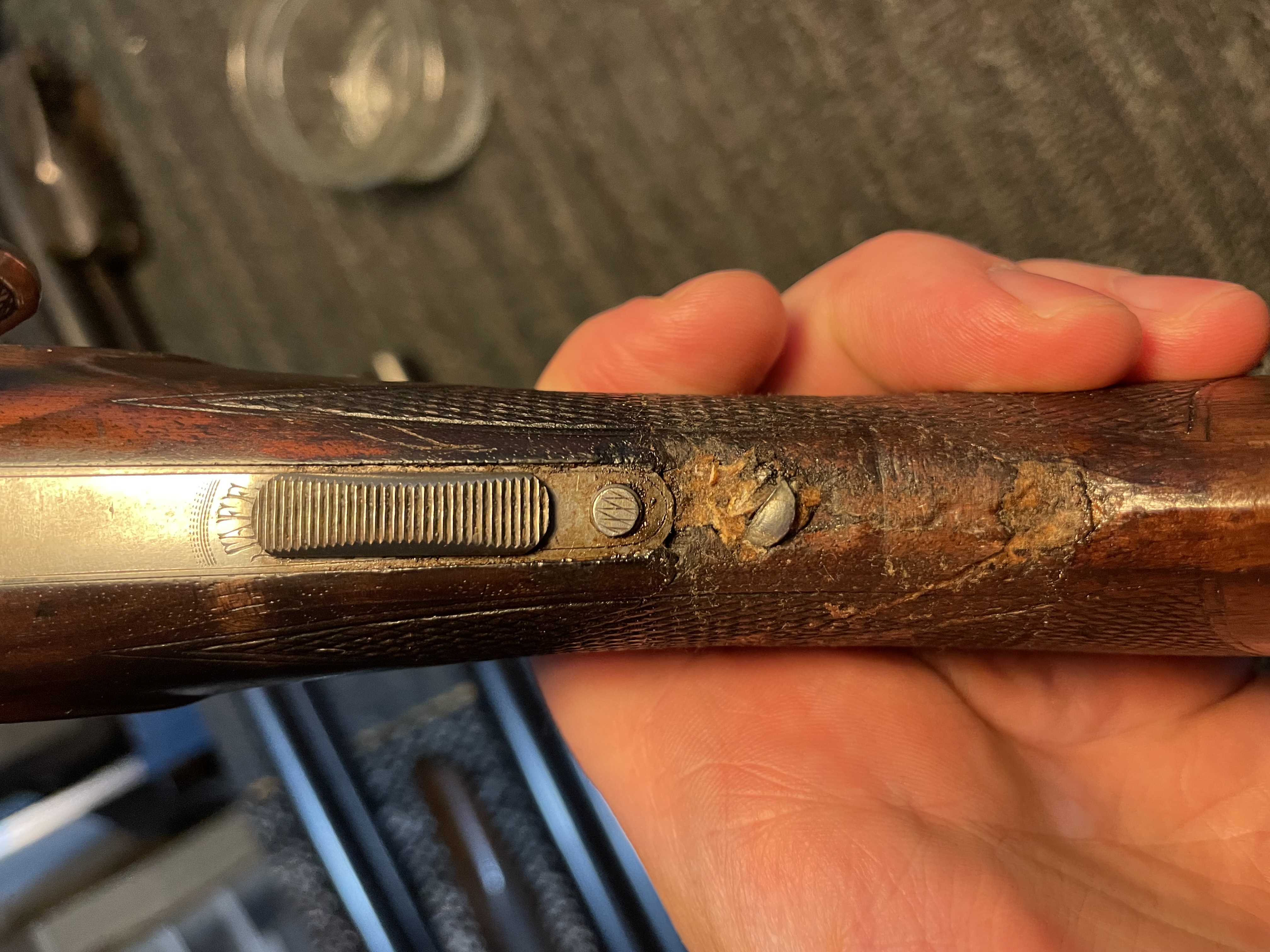

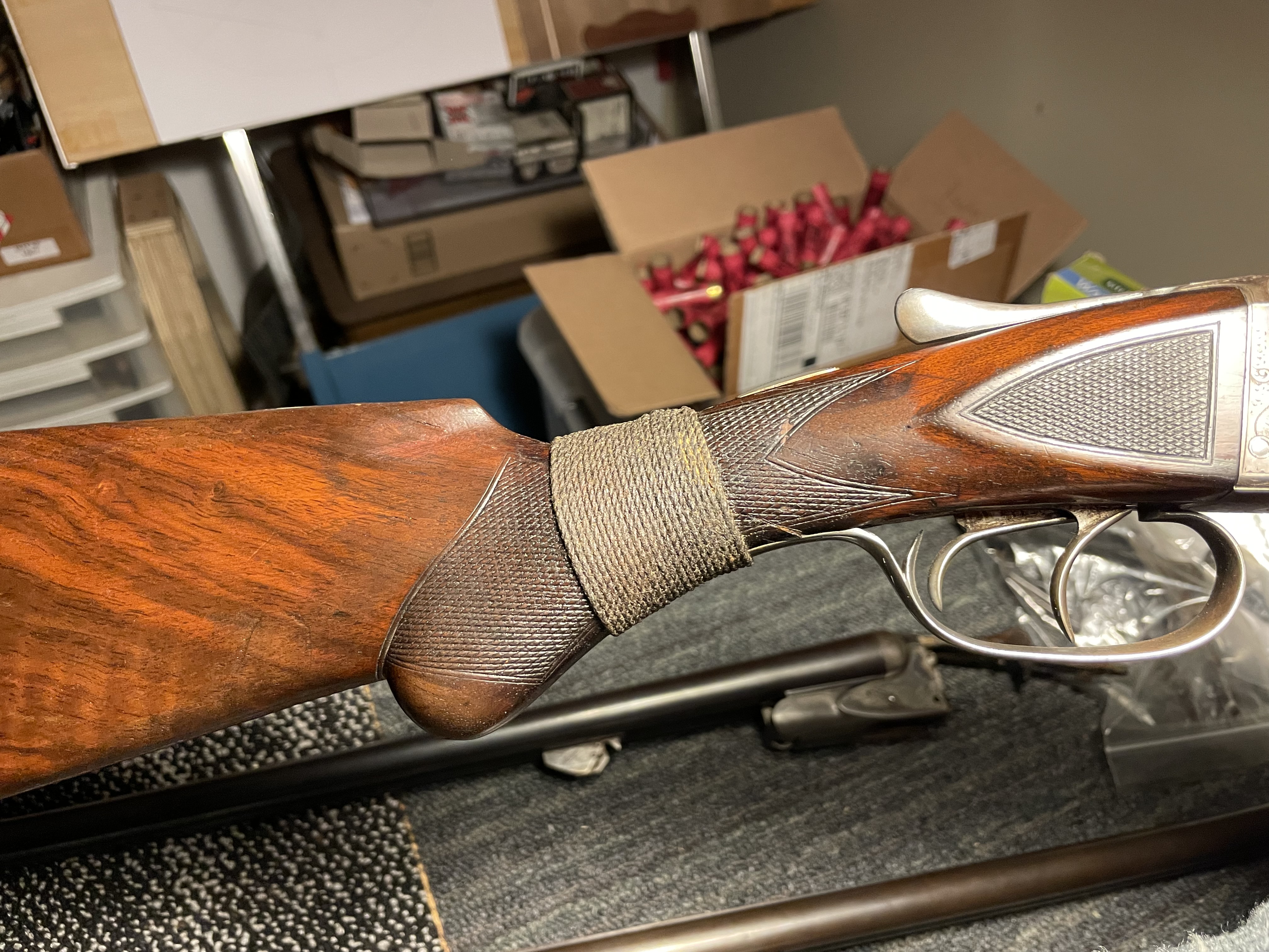

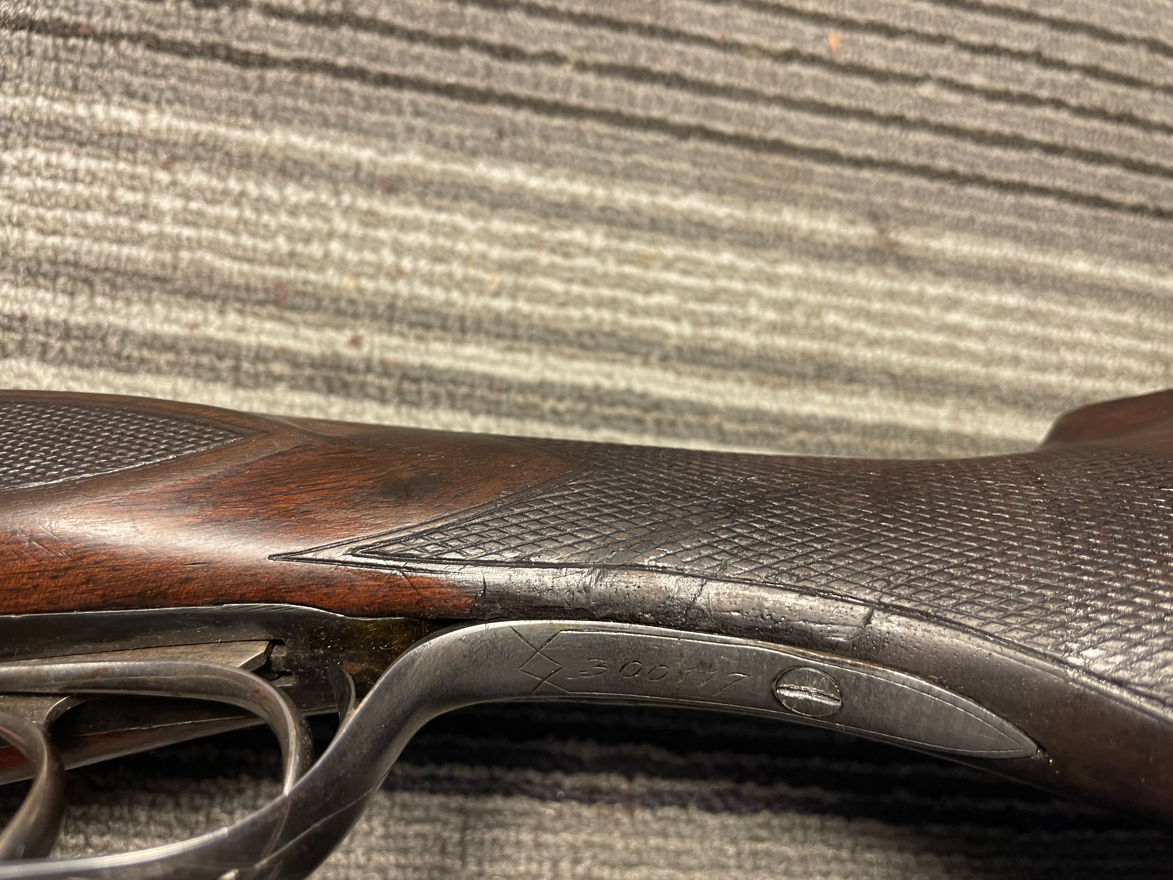

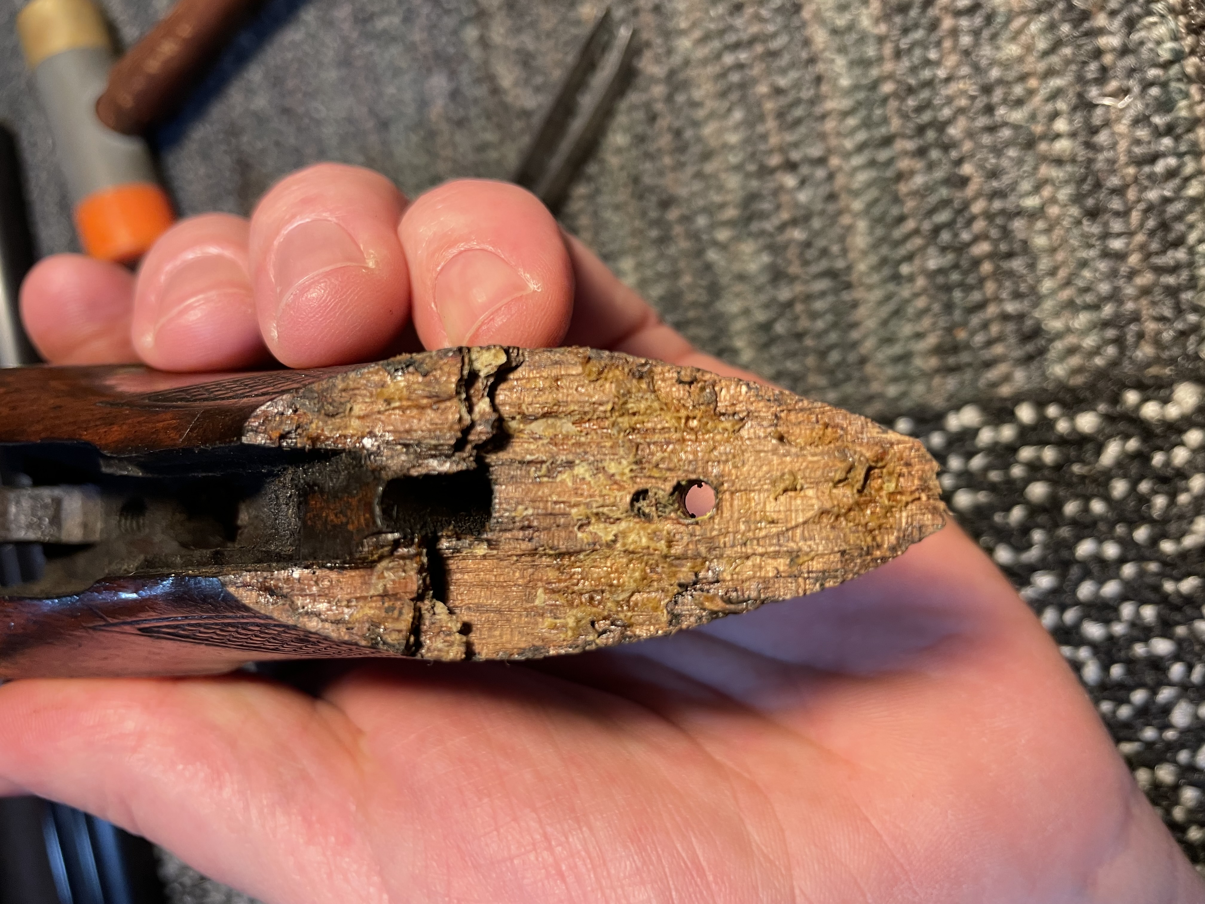

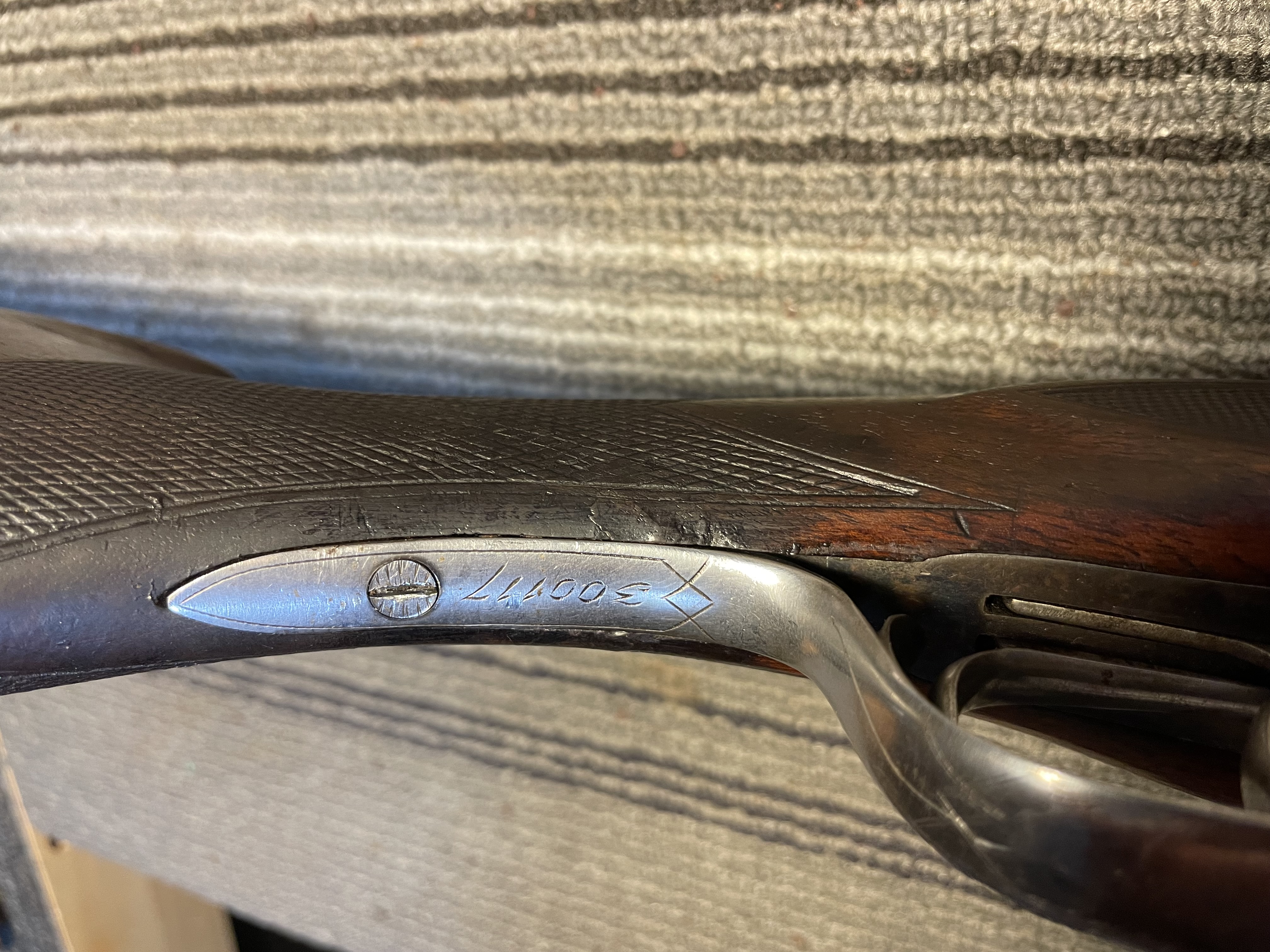

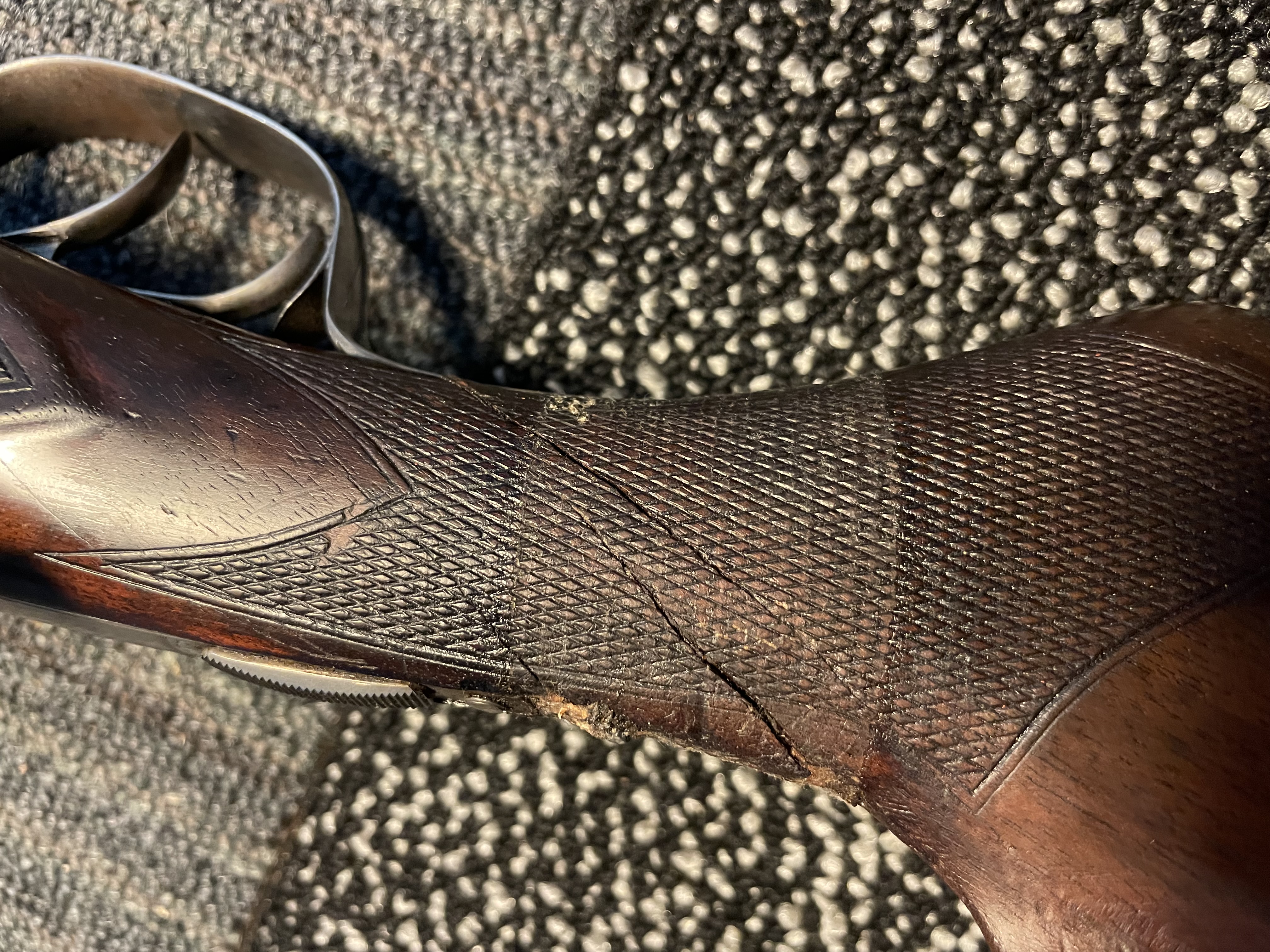

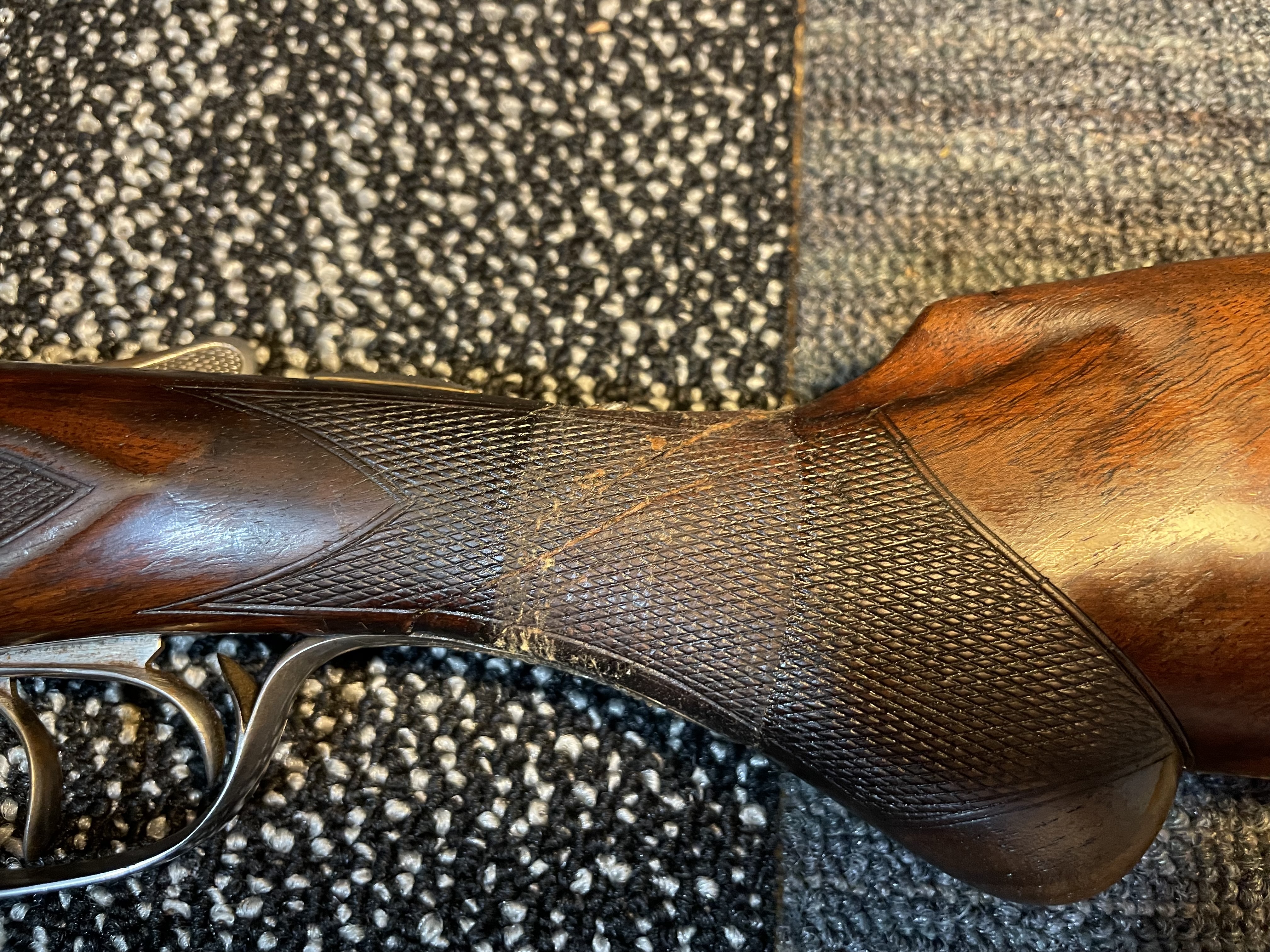

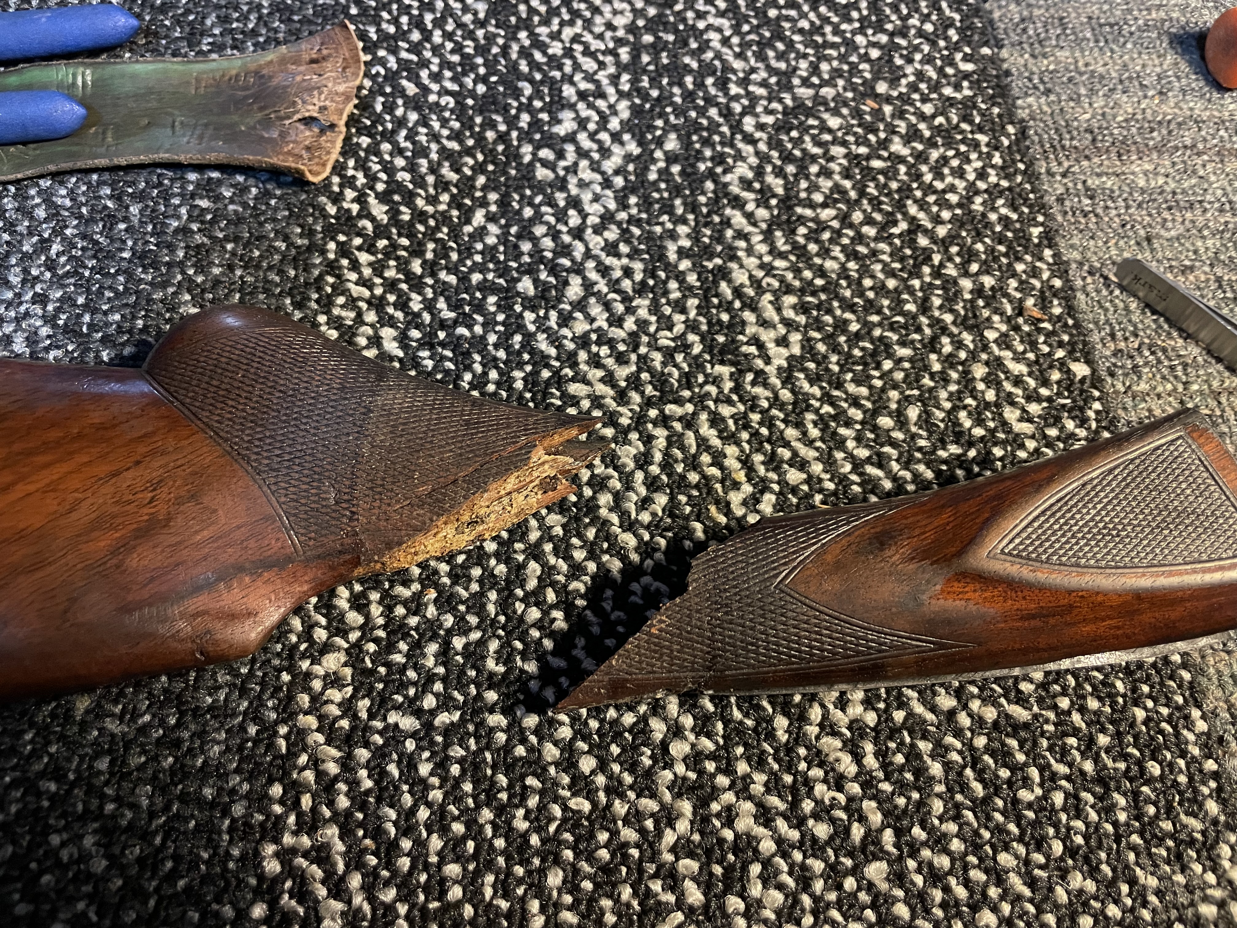

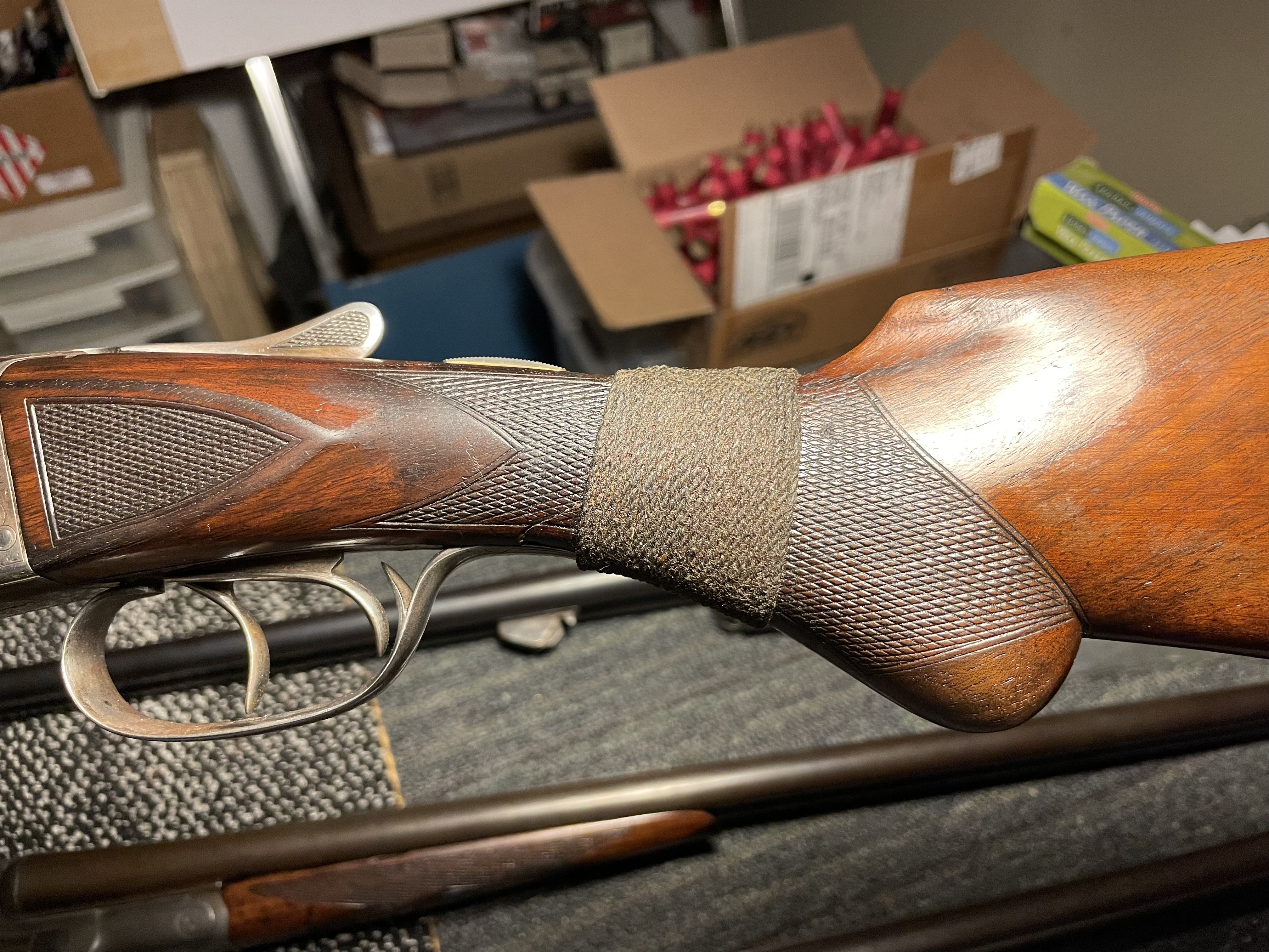

Here are some before and after photos of the repair I did to the stock. Pretty happy how it turned out considering where it started. Whoever had repaired the broken stock initially was likely not the same person who cut the barrels, as the barrels seem to be done with an eye to attention/detail, and the stock was clearly not…
The last repair person working on the stock also removed original wood from the crack, unfortunately. Had they not, I think the repair would have been invisible. In any case, I am quite happy with the repair and was able to put in two steel rods through the wrist to stabilize it.
Happy to have this gun and it’s story, warts and all, join me in the grouse woods next year as it was built to do.

This card was provided by Toolman as his free lookup for this year on the following post on the "Member's Only" forum because of the unusual engraving pattern for a B grade. "Unusual early B Grade 16 gauge engraving."

Adam, I noticed those pictures on Facebook this morning. I think you did a very impressive job. A 16 ga. with 26” barrels will be a delight to carry in the woods and those open chokes will be great for close range grouse and woodcock. I hope you’ll post some pictures of that gun “in the field” this fall.

Yes, all considered, an excellent repair. Just a thought, I know you mentioned steel rods. A heavy hickory dowel (set with acraglass or similar) is good additional reinforcement if you can fixture the stock to drill a hole for it long-axis from the butt end, into the wrist and ending just behind the back tang screw hole. A complex drilling setup to be sure, and to avoid the drill bit coming out somewhere unintended, but if the stock ever needs additional repair any steel rods inside it will complicate things immensely. Heavy hickory ramrods are available from muzzleloading supply sources.SxS1913 wrote: ↑Tue Feb 18, 2025 8:52 am

Most importantly SxS1913 did a great job of repairing that stock and sharing the before and after pics and repair process. Well done!!
