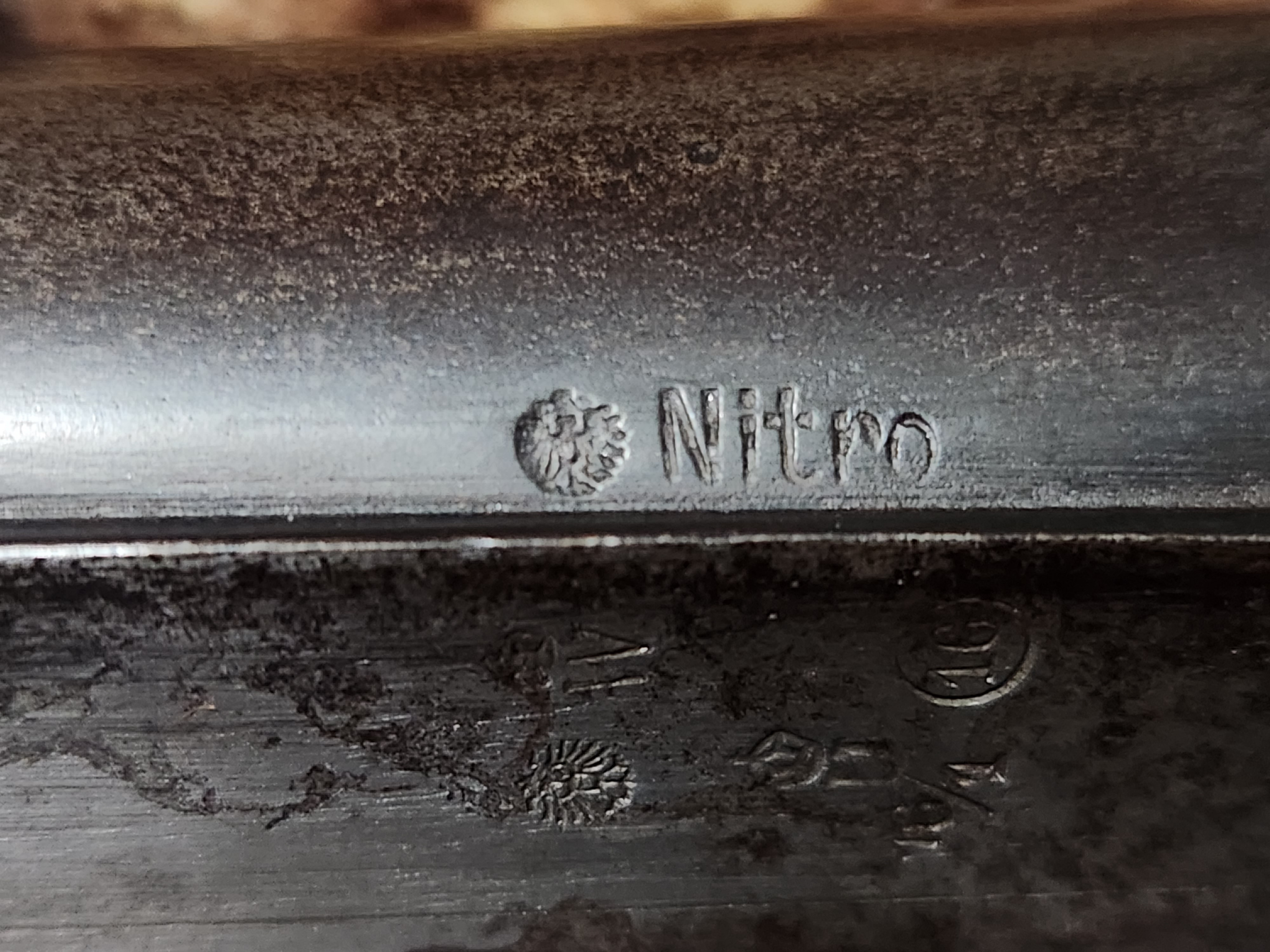

The names on the barrel I'm not finding much information on.
I think one is the maker and maybe the other an area in Germany it came from ?
It does have nitro on the barrel also.
I'll post water table pictures either later tonight when I get back home or tomorrow.
It's a pretty gun with a Monte Carlo stock that is very light weight.

Good pictures of the barrel flats, watertable and possibly the bottom of the barrels out to the forearm loop are what those who know and understand European proof marks, maker's marks and date markings will need.

Here are more pictures that I hope may help

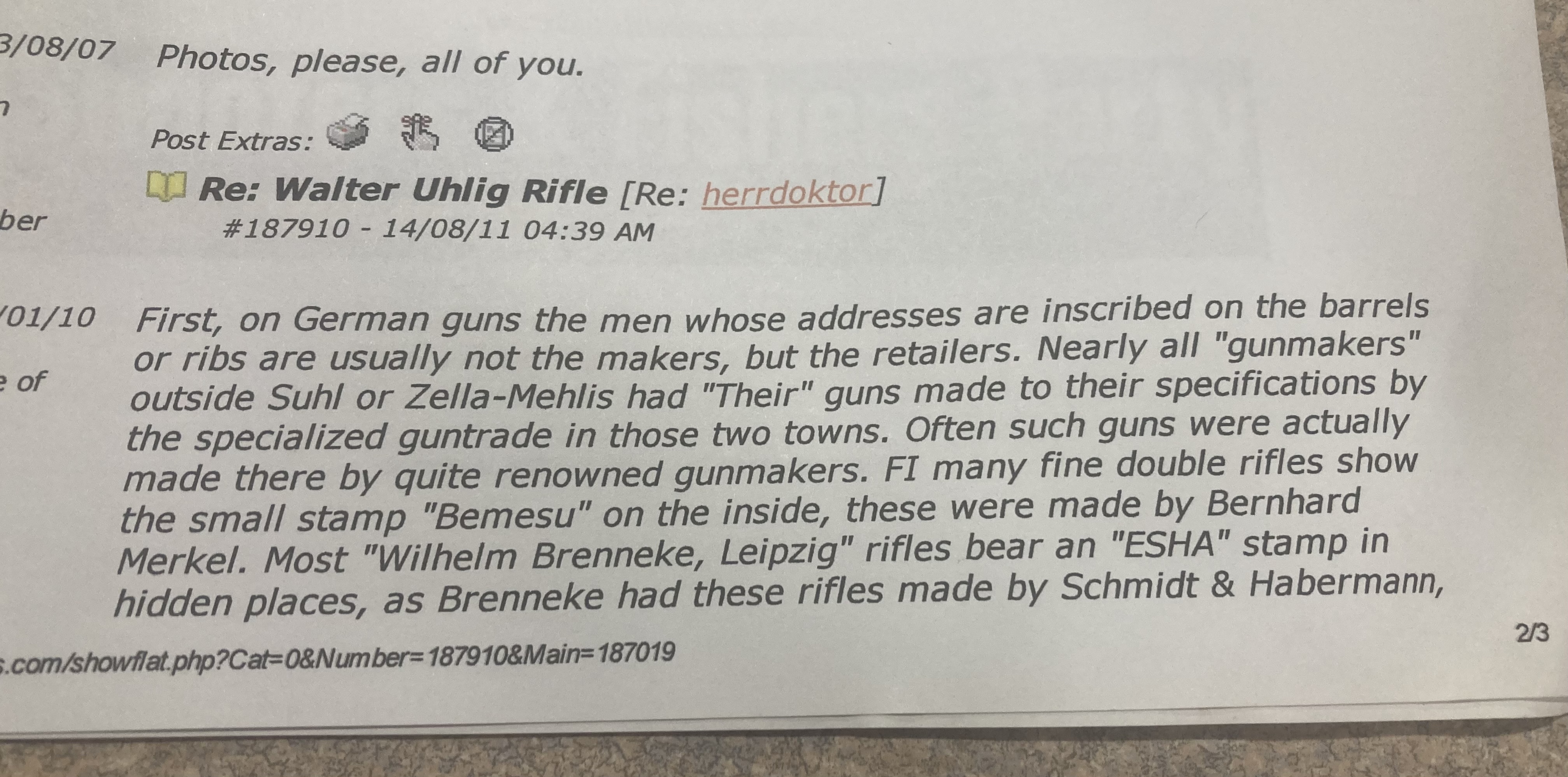

When I was searching for information on Walter Uhlig, I found this old thread that suggests that the name on the barrel is actually the retailer, not the manufacturer. I don’t know this for fact, I’m just sharing someone else’s post. Good luck with your search. I’ll bet that gun has killed a few grouse in its life.

http://shotguns.se/html/germany_1890-1945.html
Crown over U is the View mark.
Crown over W is the proof of choke bore barrel.
16 in circle is the gauge.
I suspect the 16/1 indicates the bore diameter.
No indication of a nitro proof.

The nittro I see is on the outside of the barrel on the left hand side David.

I didn't notice but both barrels are stamped nitro on the outside.
I'm not good with the stampings.
I did try to find this one and couldn't.
Anybody know it's meaning ?
It seems odd to me there would be no makers identity but I'm pretty new at any and all doubles.
