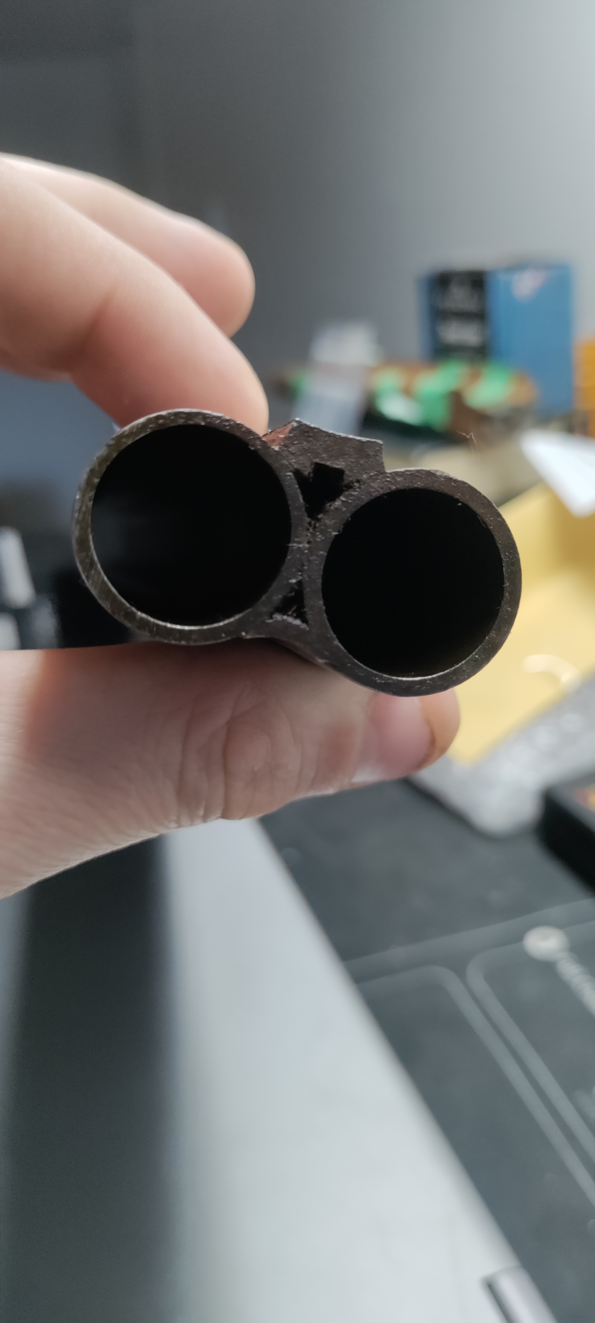

I also am having have the parts to have a barrel added to my Sterlingworth. I do have some questions. I think I found a person to do it, but wonder what will be needed besides parts for the proceedure. Gun seems to be in good order.
One question stands out is " how are the ends of Fox barrels finished?"
Are there little triangular pieces put at the end and soldered in place? Or is it all just excess solder? I want to thank Jason at Ahfoxparts for the barrel. It rings like a bell, and looks to be in good condition, but seems to be missing the end though. Great guy in my opinion, and thank you again for the trigger guard screw!

I believe you are referring to barrel keels as the little pieces of triangular steel that into the ends of the barrel along with solder.

Thank you for the link. I have read it in it's entirety, and am aware that these barrels have been shortened ½". Jason and I couldn't conclude why, perhaps for another model of Fox coming out.
I was just hoping to know. 1. The keel information( this is good information by the way thank you) and now
2. Will this prove to be a problem to solder one in? Will it unsolder the rest of the rib? Can it be done by a competent smith or better left alone? Are keels installed when the rest of the ribs are installed?

29.5" corresponds to 75 cm which was/is a typical metric barrel length. Possibly Fox made up these barrels for a foreign order that never materialized or was cancelled.
Keels were soldered in place after the ribs were done. I'm familiar with keel replacements and I use mild steel fillers and an oxyacetyene "soldering copper" which applies high heat just to the localized area rather than using a torch and risking the barrel ribs there at the muzzles. Quick high heat and a good soldering flux are key. Once soldered in place the keel(s) are easily dressed down with a file and I'll finish with emery paper before faux age coloring. Note that I'm not in the biz and this reply is just for info and to say I'm not looking for work. Also I can't help with a good gunsmith recommendation because I do all my own Fox mechanical work and occasionally for friends. Hopefully one or more members will step up with names based on their personal experience with keel fitting work. Lastly, I wouldn't recommend most gents trying to do steel keel replacements themselves. frank
