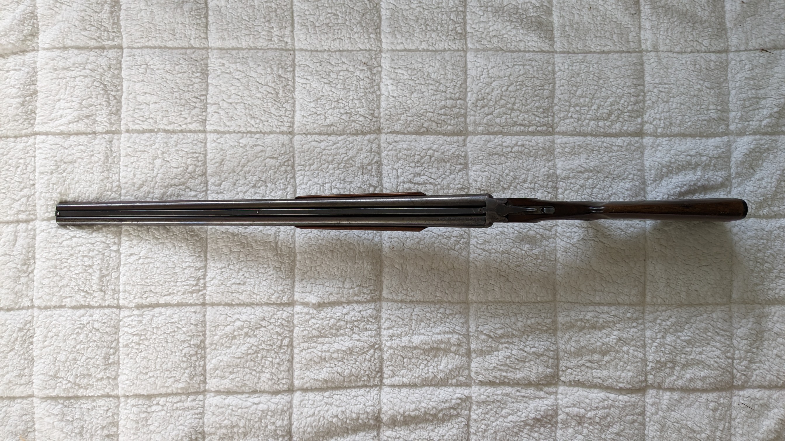

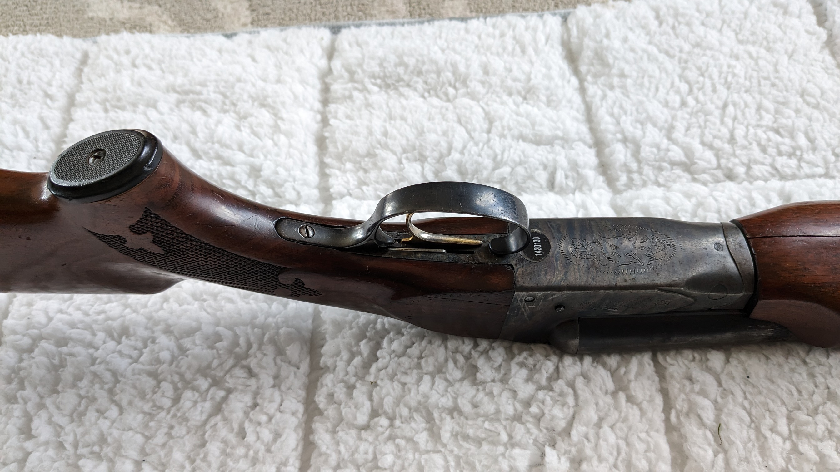

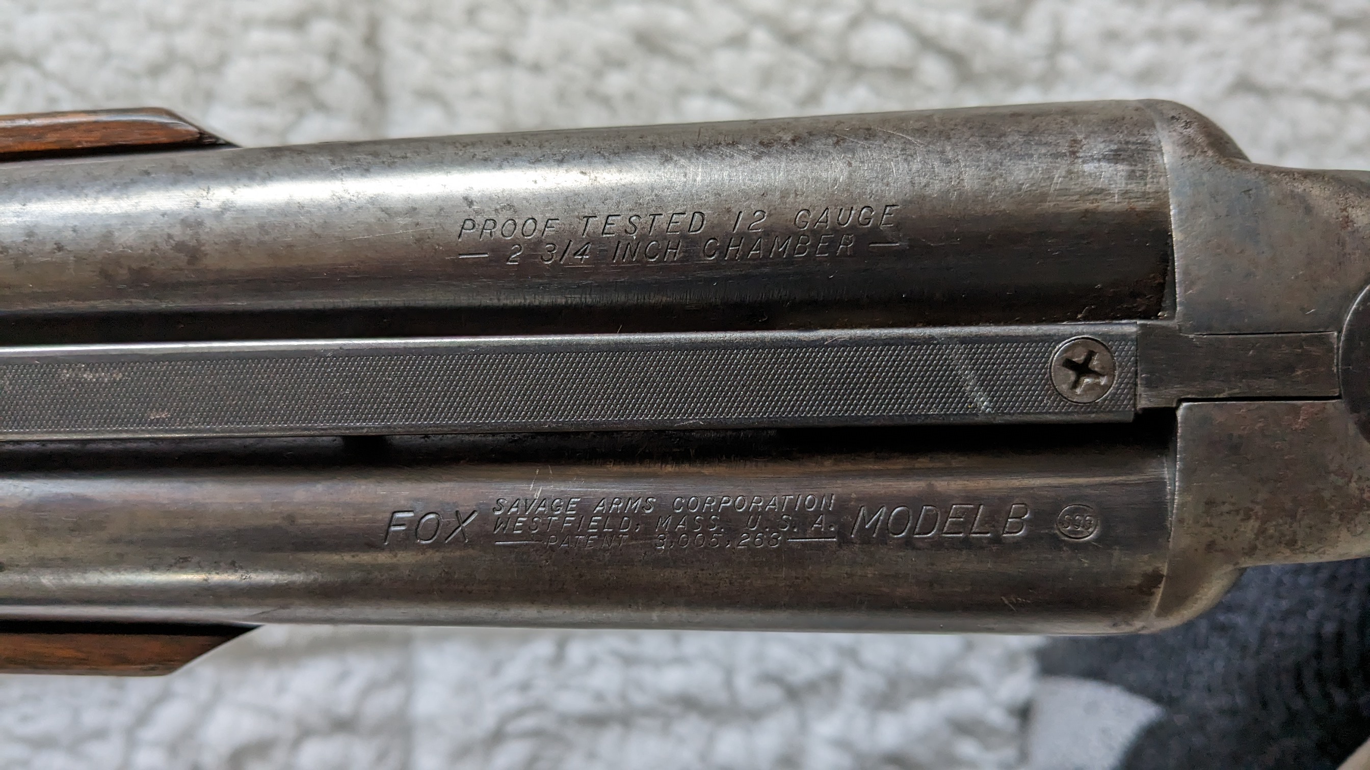

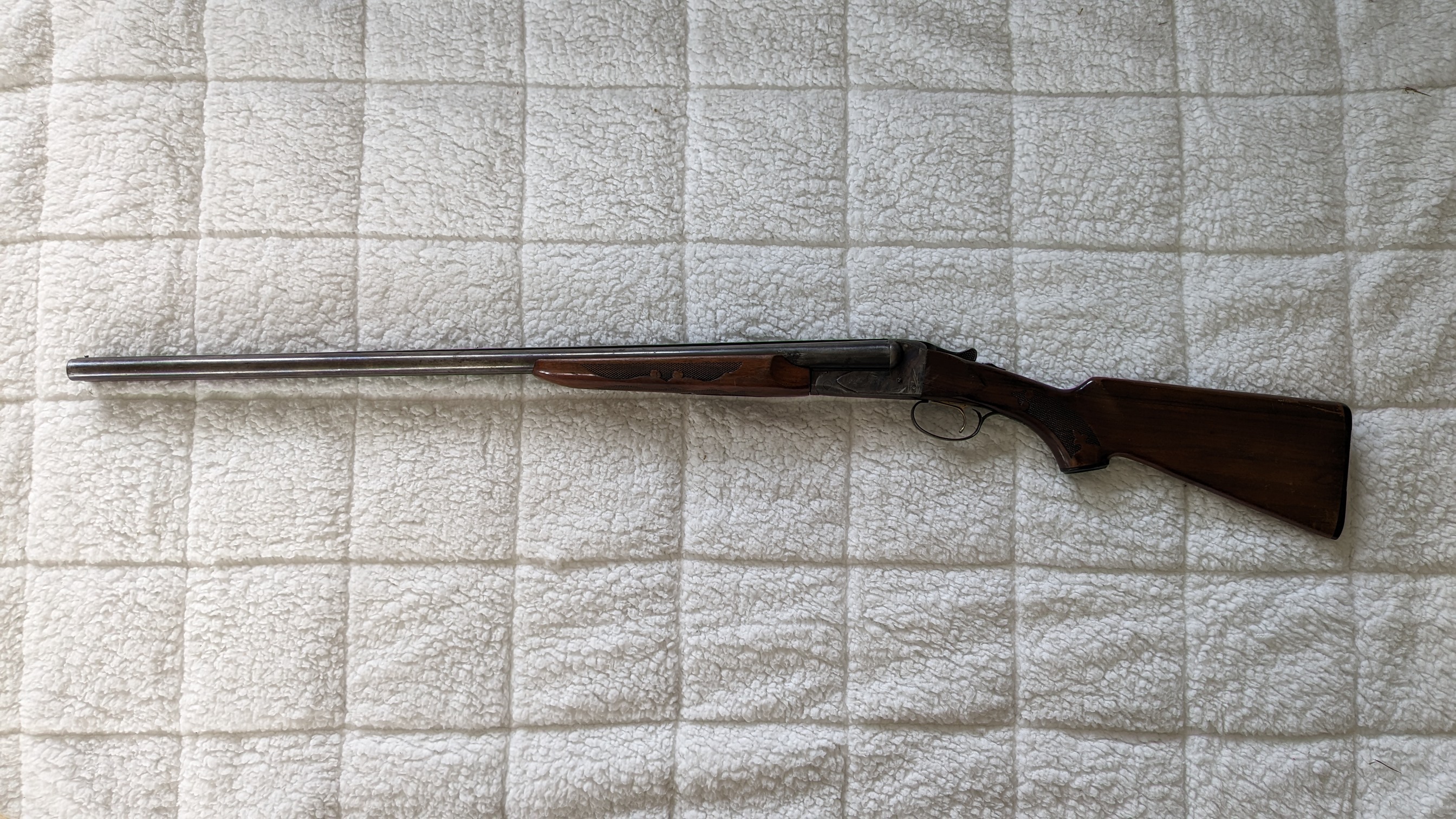

I have inherited a Model B Fox from a friend of my Dad's, and I admit do not know much about this type of shotgun. I was wondering if anyone could provide some information concerning it's age, and dos and don'ts in terms of ammunition it can fire. I do suspect that it has been modified from a double trigger to a single, and it does have some type of choke. I would think that I would not shoot slugs, or perhaps steel shot? Anyway, any info would be helpful. I am glad I stumbled into this forum.

That is not a real Ansley H. Fox double, the subject of this web site. It evolved from Savage's J. Stevens No. 530.

That little oval with 28S in it on the bottom of the frame is a date code. Savage's year codes started with A = 1949, B = 1950 .... I believe a couple of letters were skipped so S would be about 1964 or 5.
Your gun was made well before the federal requirement for non-toxic shot for waterfowl and I'd advise against ever using steel shot in it. It was made for lead shot. Some of the softer non-toxics like Bismuth or Nice-Shot would be acceptable.
