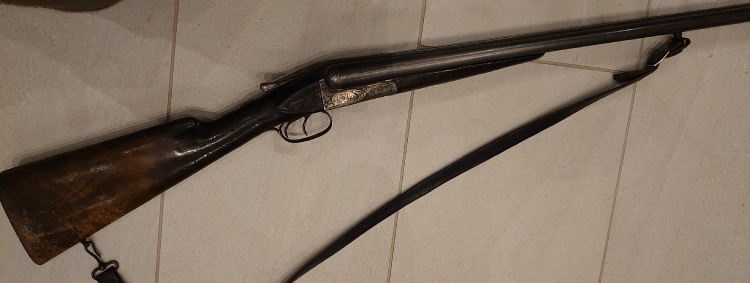

				by Stan Hillis
				This is my 12 ga. Philly Sterlingworth Ejector. The gun went to English proof (London) but I have not determined when, possibly it was when the chambers were lengthened to a full 2 3/4", as indicated by the proof marks.
 Another puzzling thing about it is the "2550T" stamping on the underside of the left barrel.
 Edited to add: In further looking into the date of the proof marks on the Sterly E, and the combination of them, I believe the proofing was done during the 1954 - 1989 time frame.

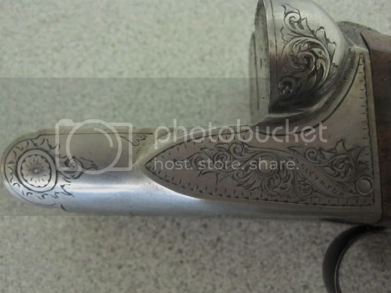

				Researcher wrote: ↑Sat Mar 18, 2023 4:43 pm
I have seen a couple of Ansley H. Fox doubles with English proofs and a friend at one time had a nice DE-Grade with French proofs that the last I saw of it it was being offered for sale by Herschel Chadick, so that was some time ago.  Tom Kidd did an article on a 20-gauge CE 200316 that went to England in
The Double Gun Journal, Volume Six, Issue 4, pages 47 to 53, but he shows no pictures of the barrel flats or watertable to show any proof marks.
Most of the production cards I've seen for Ansley H. Fox guns going "out CONUS" are to L.H. Hagen in Norway, so many that they got their own engraving patterns for the A-grades they got.
See the January 2011 Card of the Month and the April 2021 Card of the Month.  They often ordered no engraving on the barrels.  The middle gun of three XE-Grade 12-gauges Hagen ordered recently surfaced in Norway on one of the other gun boards.  It has been out there in the world, not languishing in a gun safe --
A lot of guns also went to our territories, Martin Kohn in Havana, Cuba and Squires Bingham in the Philippines.

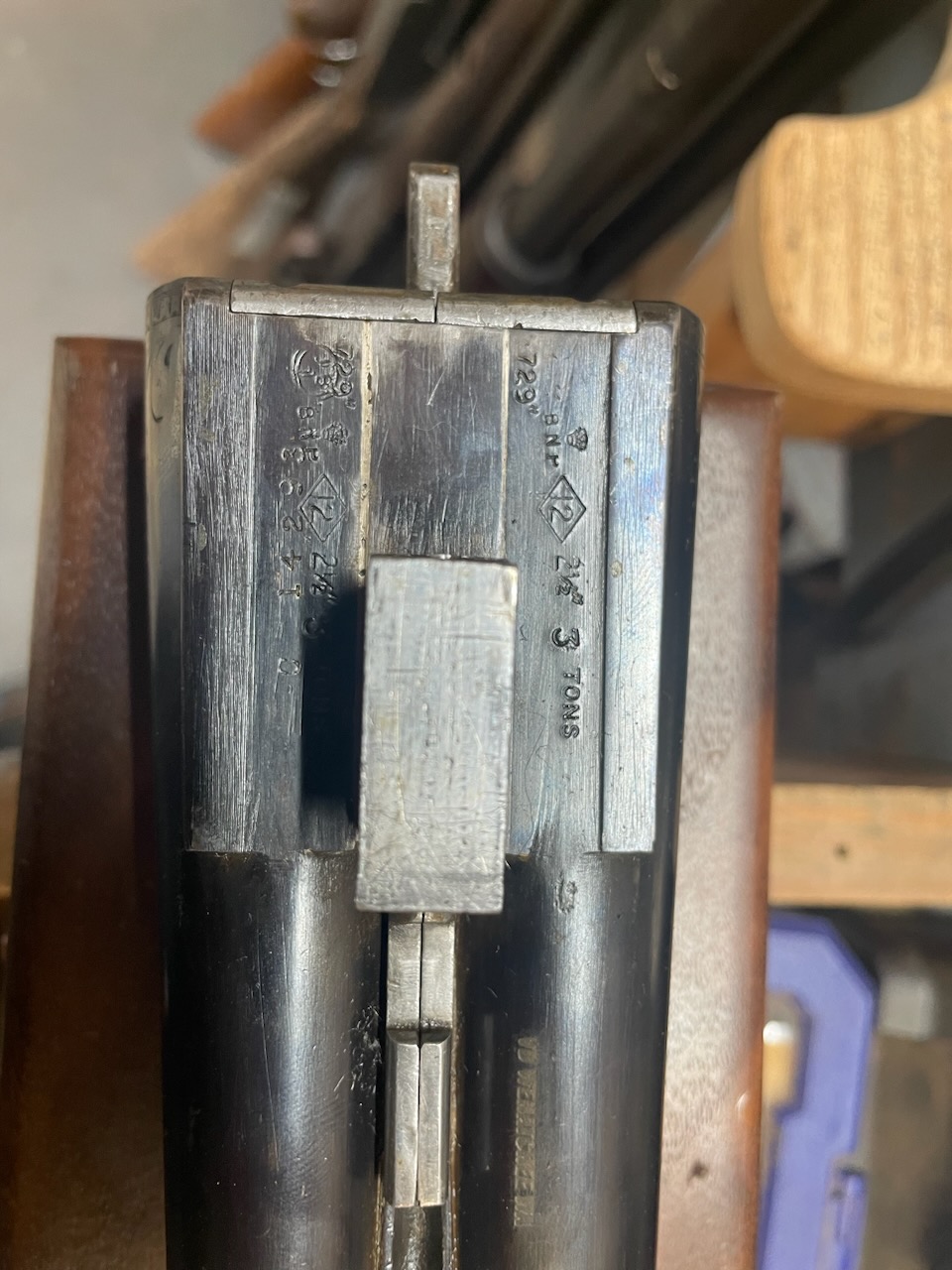

				by MIGrouse
				Below is a picture of the barrel flats of the shotgun I am looking at.  Hopefully you can read the proof marks.
				Re: English Proofs
				Posted: Wed Mar 22, 2023 7:02 am
				by Stan Hillis
				Nitro proof, done in Birmingham for 2 1/2" loads at 3 tons, or 8,960 psi (618 BAR), according to Burrard's formula for converting to psi.

Both guns carry 1954-1989 Proof Marks
Stan's was London Proved in 1975
				Re: English Proofs
				Posted: Sun Jun 18, 2023 7:37 am
				by Stan Hillis
				Thanks, Doc. I do not know how I had overlooked that tiny mark all this time.
