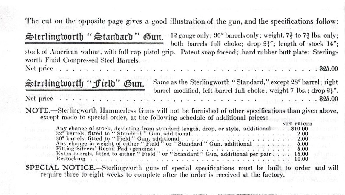

That is the assumption, but we don't know for sure. The catalog text doesn't say --

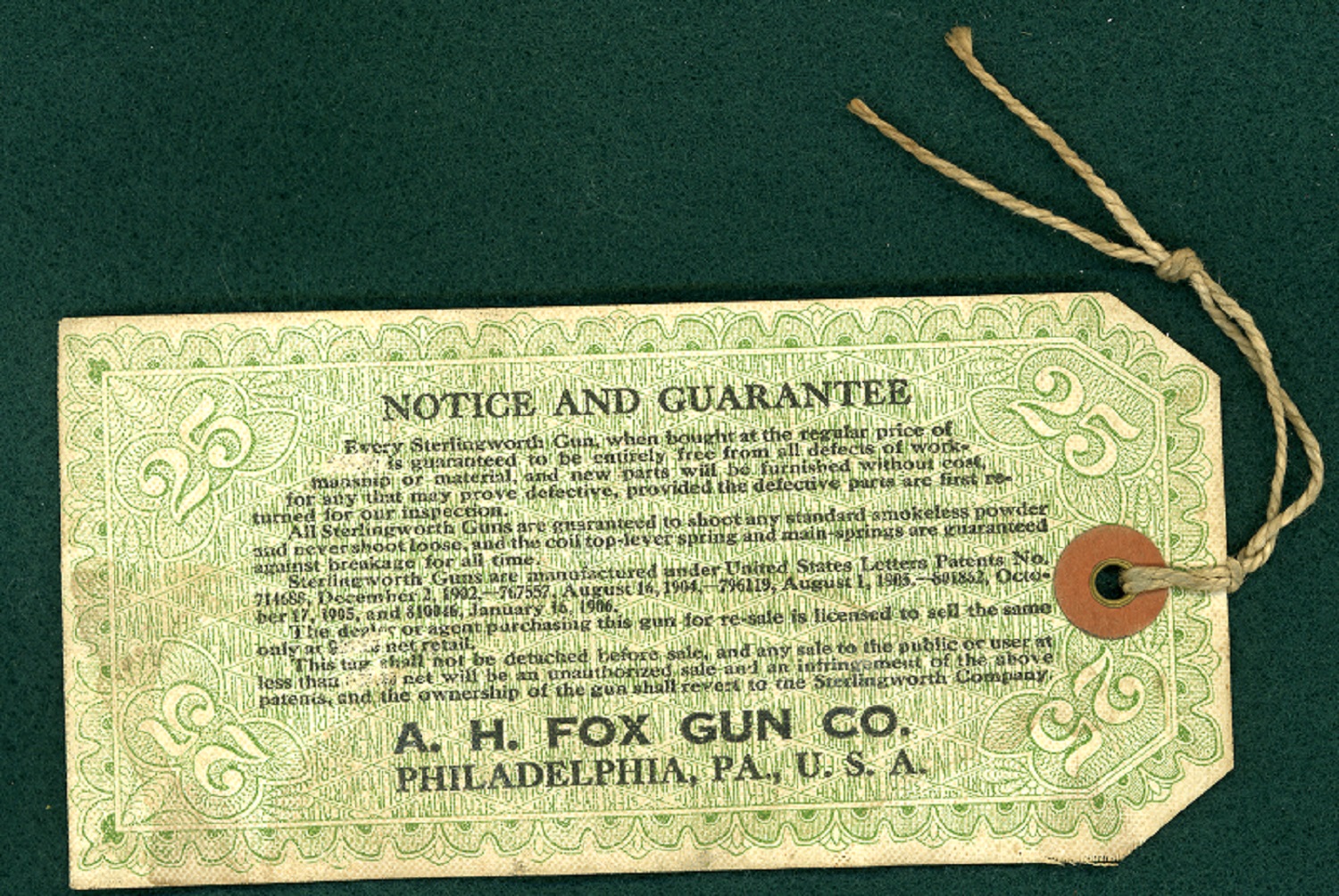

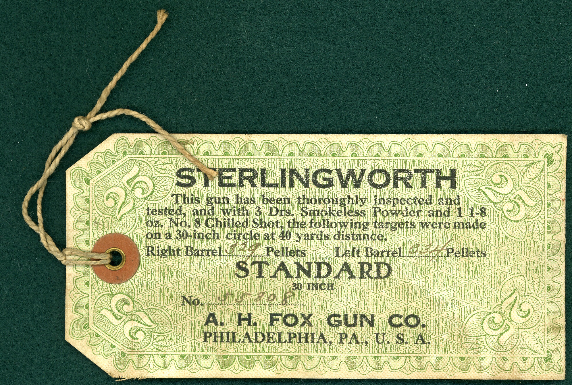

The earliest Sterlingworth hang-tag that I've seen is into the A.H. Fox Gun Co. time, but the text on the back and the tag material seems to be from The Sterlingworth Co. time. At any rate, no mention of chamber length.
The 3 dram, 1 1/8-ounce load of #8 shot that 55808 was targeted with could be had in any 12-gauge shells from 2 5/8-inch on up. The next Sterlingworth tag I've got a picture of is 77086 and that gun was targeted with a 3 1/8 dram, 1 1/4-ounce load of #7 1/2 shot which was only available in 2 3/4-inch or longer shells.
