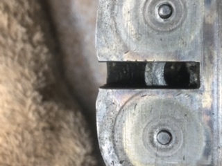

by readgriff
See attachment of firing Hammers wear
Re: Firing pins are flattened
Posted: Mon Dec 21, 2020 4:47 pm
by Silvers
It's hard to tell for certain from one pic but it looks to me that the right hammer tip has been ground flat and maybe a scootch on the left one, probably to make your Fox easier to open after firing. JME but I can't see how "wear" would cause that. The hammer tips are pretty hard, as in Rockwell C number. Again I think if the Fox is functional then you're better served by leaving the hammer(s) in place; or if you're adamant to replace one or both hammers, to send the Fox to a good 'smith because replacement will carry over to the sear, trigger and safety engagements.

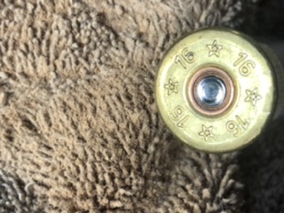

by readgriff
Primer hit
Primer hit
As you can see the hit is pretty shallow and large.
The hit has definitely changed over the years.
Posted: Tue Dec 22, 2020 8:11 am
by Silvers
Those very few of us that still try to help by answering tech questions can only go by what's written by the OP. In your first post you wrote that the Fox still fires but now you post a pic of a primer with a light strike. :?
If indeed that right hammer has .040" protrusion as you posted that should be more than enough to fire if the mainspring isn't weak, if headspace is OK, if there's no mud or field debris inside the mainspring counterbore, and if whoever ground the hammer tip flat didn't do anything else inside the mechanism to impede the hammer fall. Cheddite primers as in the last pic are easily fired. And there's no way the hammer tip became flat from "wear" over the years. At this point it seems that right hammer must be removed for troubleshooting and on that line we've seen so many times where fellas ask for videos and directions on how to remove Fox hammers, and sometimes even with directions that results in multiple follow-up "please help me" requests when the frustrated fella can't put things back together and/or the replacement hammer is misfit to its sear and causes other operational problems. Then the helpful guy who gave the directions feels obligated and gets sucked into more and more effort and time to reply. Again I strongly urge you to send your Fox to a good Fox 'smith.

ThankYou all for your replies
I looked at the hammers fireing pin on my other fox and they protrude farther and are rounded.
I’m not sure what I’m going to do at this point keep shooting until they don’t hit or take it to a gunsmith see what his thoughts are or try to remove and see if they can be reshaped.
I really like to fix things but maybe this out of my expertise.
Thanks again
Dave Read
Posted: Tue Dec 22, 2020 10:09 pm
by Stan Hillis
If I'm understanding correctly you have not said that you have had any misfires, or that you have had any light strikes. The pic you showed appears to me to have a very large and unusual indentation, typical of what I would expect after viewing the pics of the gun's non-typical firing pin "noses". I would expect a striker shaped like that to yield such an indentation. Frankly, I've never seen firing pins, or primer indentations, like those.
You're probably not getting any pierced primers because of the shape of the firing pin "noses". So, as long as you're getting 100% reliable ignition with the shells you're using I'd just keep shooting it like it is. If it gets unreliable on you then you can decide who to send it to for proper repairs. As you have been advised, it is a tedious repair that requires considerable expertise.
Best, SRH
Posted: Wed Dec 23, 2020 5:43 pm
by readgriff
Stan
I have not had any misfires yet but the way they look hitting the primers they are really shallow and large.
So I’m trying to address this prior to having light hits and no fires.
This is why I posted this to get information and see if anyone else has seen this problem and what they did to resolve it.
So thanks to everyone with there thoughts on this issue.
I also should mention I have probably shot 3 thousand shells through this gun.
Mostly light reloads Fiochhi primers.
