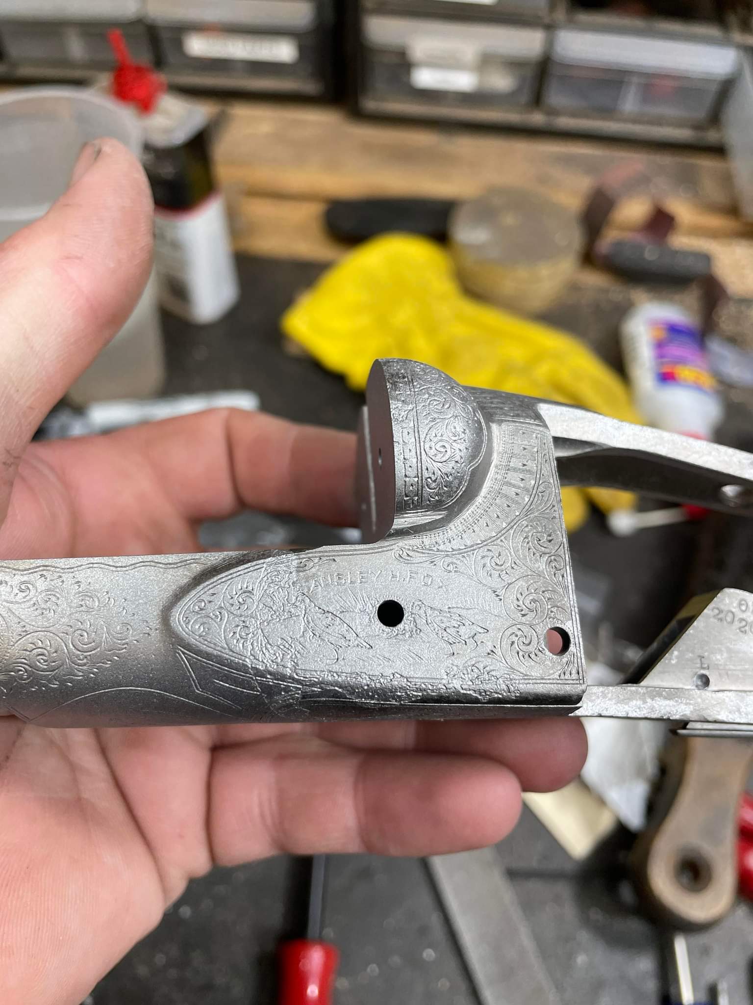

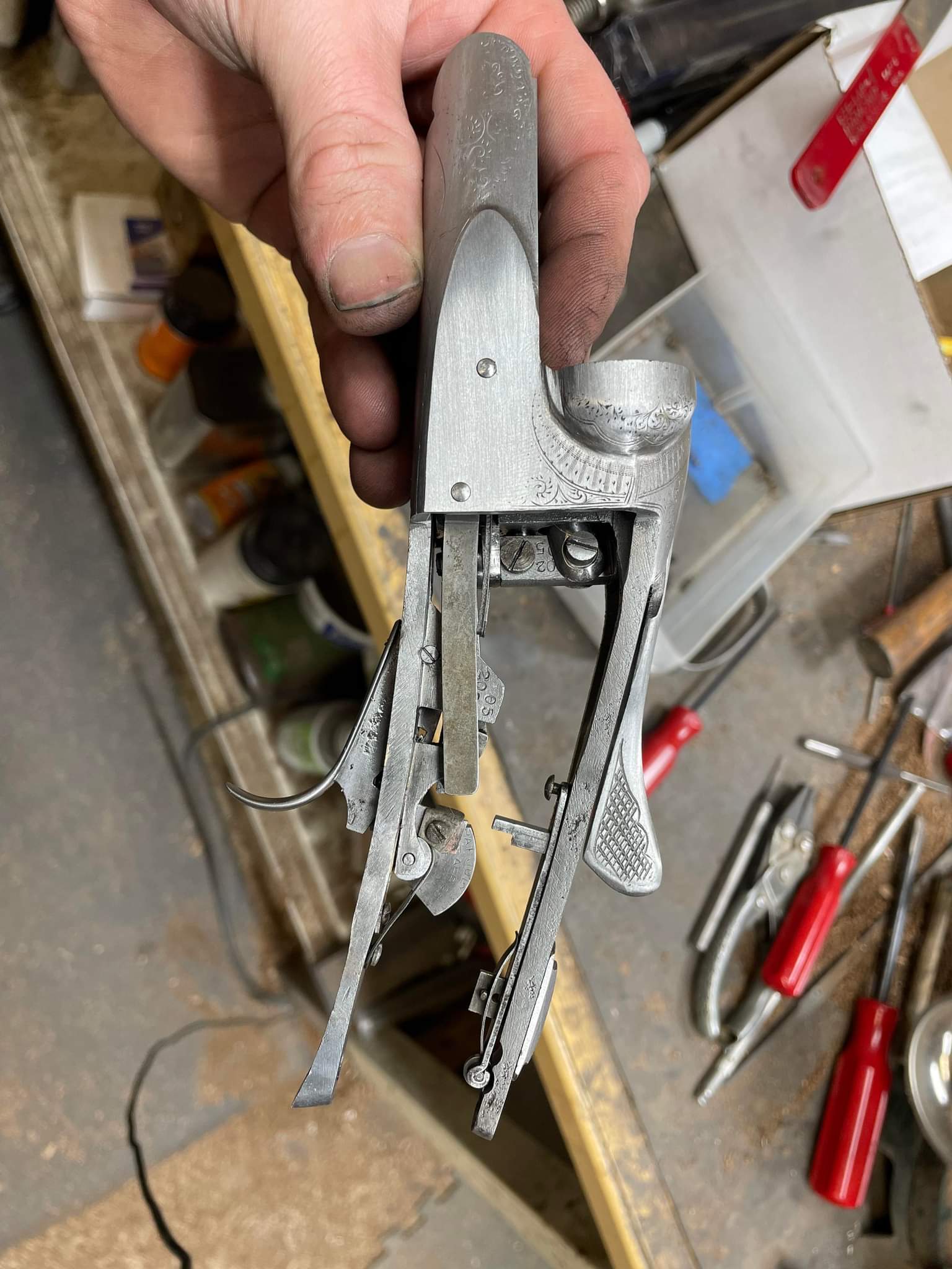

Fred when all is said and done I have a new name for her that I'll reveal. Just give a tease, here is the receiver after it was annealed and prior to be micro tig welded and filed in prep for Gournet to recut the engraving. All metal work was done by Matthew. There is a reason I think he will be accepted into the Custom Gunmakers Guild early next year. He is that good.

Kind of interesting, first pic in the preceding post shows the head of a screw instead of a pin for the trigger pivot. First Kautzky I saw without a trigger pin. Also the "shoe" - for want of a better word - that the safety slide block bears against when ON SAFE, is mispositioned. I assume your 'smith Matt knows that.

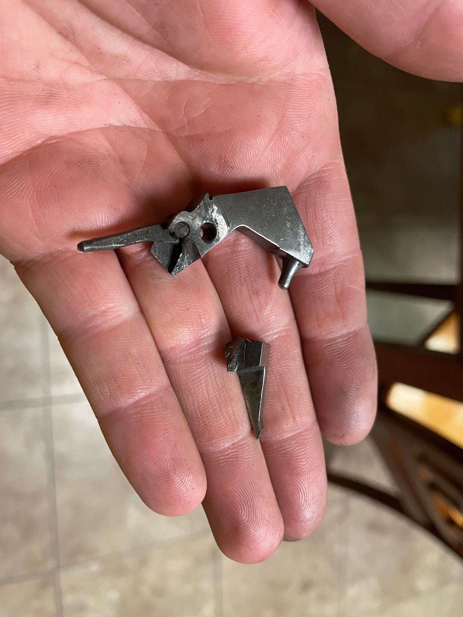

Tom, I've been told by a comrade that pics of the broken hammer along with a narrative were posted on FB (?) or some similar platform. Possibly those of us not on FB can look at the same here? Me, I’ve personally seen only one broken hammer over many years of fooling with Foxes. That one had a cocking lever that was broken off. Actually it’s still here in my parts bin. frank

Good questions Frank. Matthew told me that some of the parts or pieces of the Kautzky were messed up and that he had the parts to fix it. Believe he got those parts from Jason B, but not sure. I know he told me the trigger wouldn't reset after being pulled. Regarding the pic of the broken hammer here it is.Silvers wrote: ↑Mon Nov 20, 2023 7:40 am Kind of interesting, first pic in the preceding post shows the head of a screw instead of a pin for the trigger pivot. First Kautzky I saw without a trigger pin. Also the "shoe" - for want of a better word - that the safety slide block bears against when ON SAFE, is mispositioned. I assume your 'smith Matt knows that.

Thanks Tom, the cocking lever is broken off and curiously it looks like the small end of the lever - lower piece in the pic - is slightly deformed, expand to max to see. And if so I'd surmise that interference could have caused the breakage. Something for your man to check out. frank
