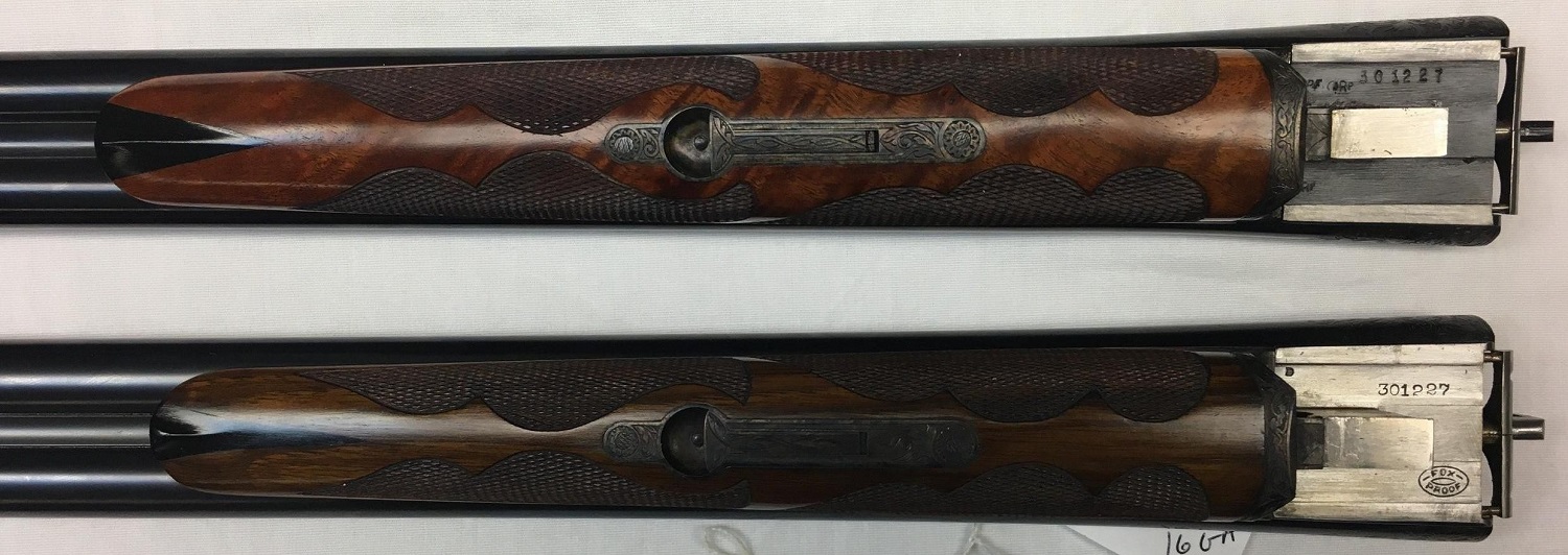

A couple of years ago, over in North Idaho, I looked at a 16-gauge, AE-Grade, 30-inch, 301690, that had gone to California Hardware, circa 1923. At some point, probably not too long after, it was likely back to Philadelphia for a set of 32-inch 20-gauge barrels that fit the breechballs perfectly.

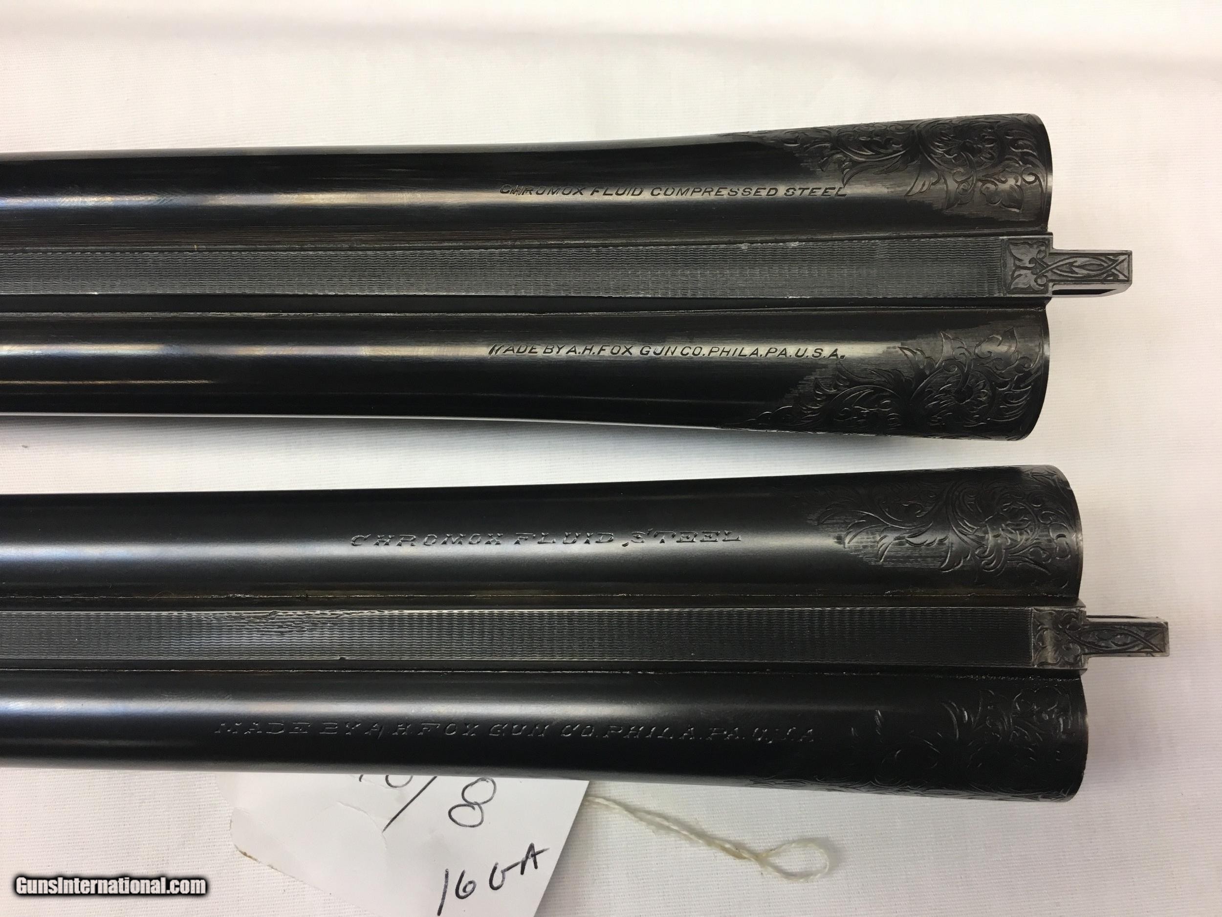

Serial number 301227 is a 16-gauge DE-Grade that went to Bob Smith Sporting Goods. It was on the market a while back, fully refurbished, with a set of 20-gauge barrels that have the roll-stamping on the top that smacks of Mitzie to me. The original 16-gauge barrels have the engraved legend on the top typical of many D- & F-grades.

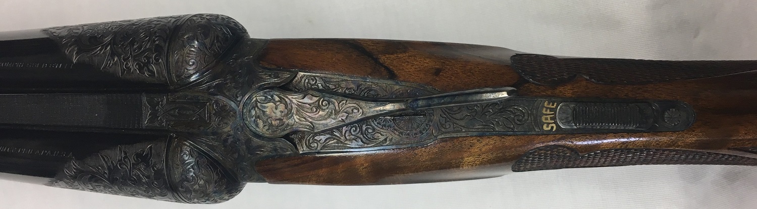

With the 20-gauge barrels in place --

Yep Dave, easily done in the factory setting when fitting a rough/in the white 20g barrel assembly to a frame that had been furnished with 16g barrels. My post related to someone’s vision of making a two gauge set with 20g finished barrels from one Fox and trying to fit to an existing 16-gauge Fox.
Hard to see on Dave's second pic of 301227 even when expanded but the proof stamp appears to be sRp/oval instead of the typical Savage-Utica SP/oval proof stamp. Mitzie’s work ..... maybe. I've seen that sRp/oval stamp before but don't recall the particulars, and I doubt Mitzie when working on his own would be using a recognized stamp to fake a factory proof. Those other small glyphs on the barrel flats also add to the mystery. Kind of interesting to speculate but nonetheless the 301227 barrel story is likely lost to the mists of history.
Back to fitting 20g barrels on frame furnished with a 16g gun; methinks the factory on order would have lathe profiled each rough turned tube so its breech would match the 16g frame, thence to the barrel assembler, then to matting, striking etc. The resulting 20g barrel set would of course be somewhat heavier than a 16g barrel set with a similar down-tube profile, but not that much heavier. And besides, the weight increase would start between the hands and along the entire run of the tubes, making for good gun swing dynamics. Kind of on the opposite end of the range as compared to ultra light Foxes that swing like buggy whips. :roll:
All this is JMO here gents. frank
