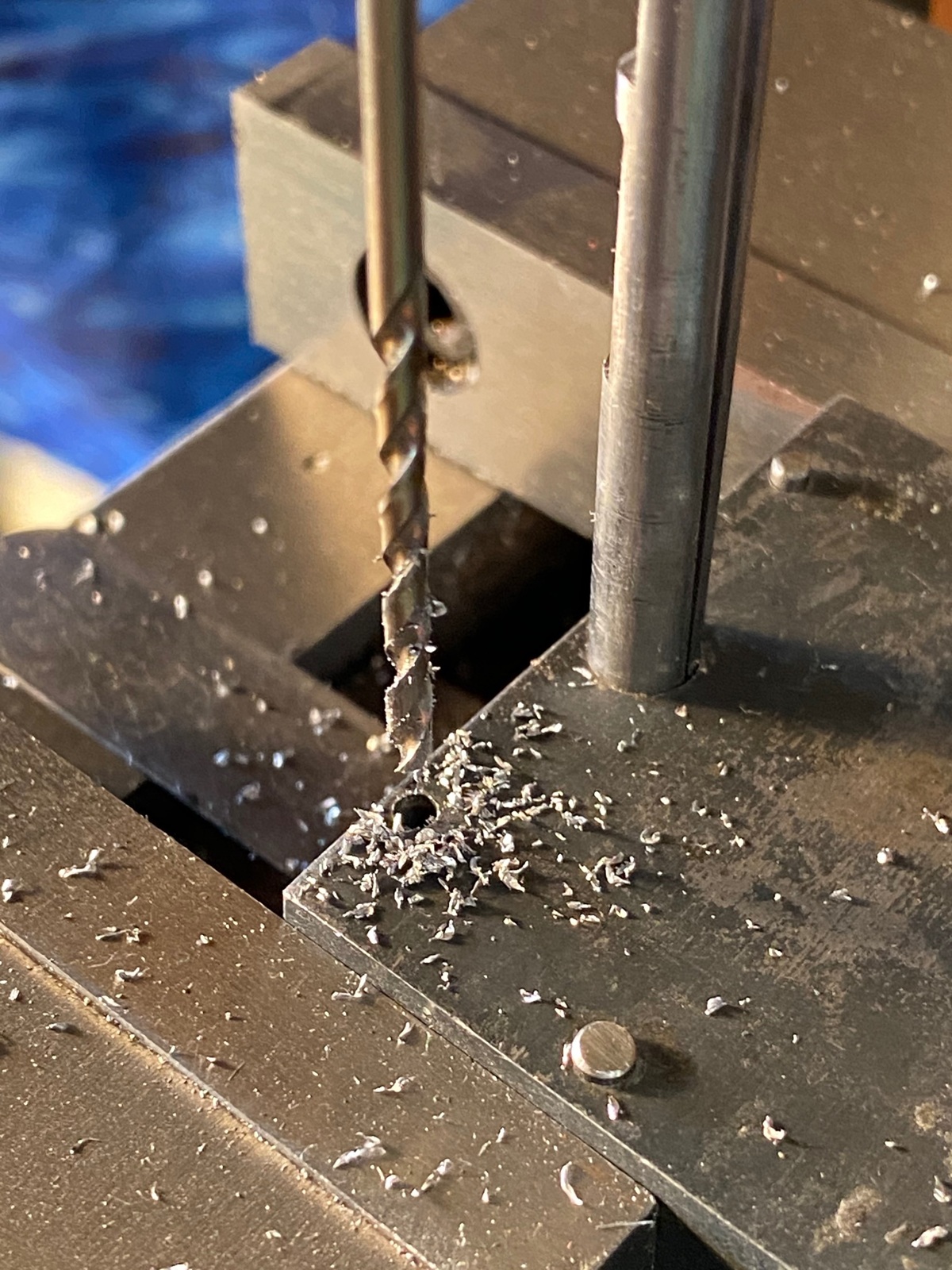

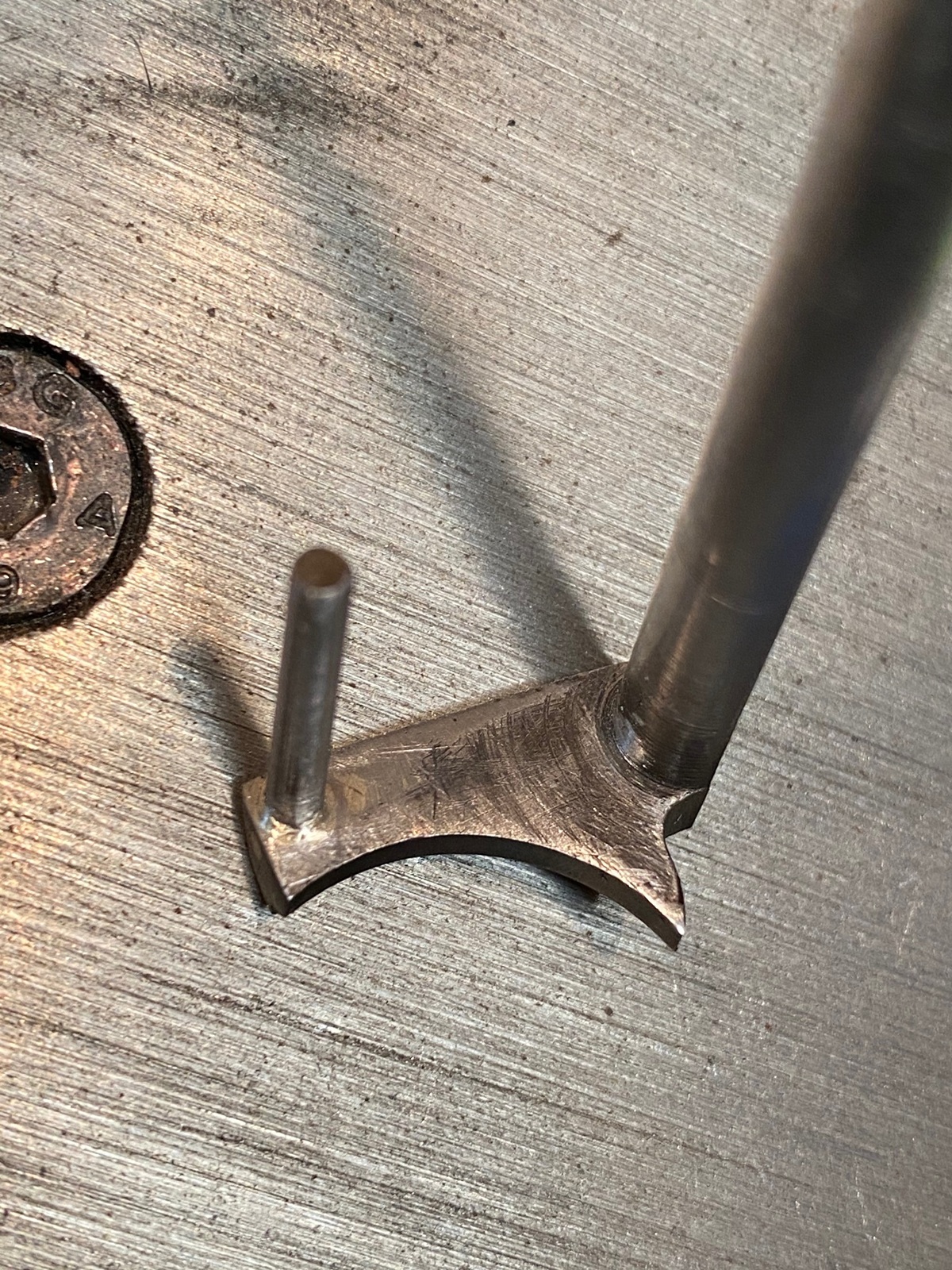

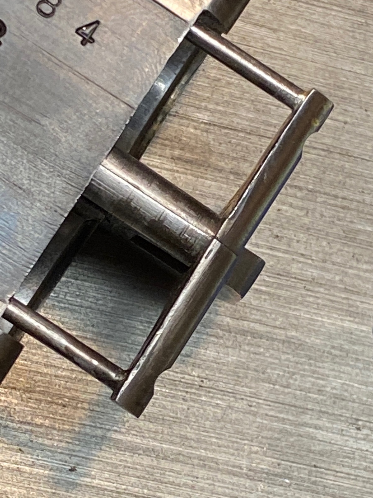

Some time ago I started doing guide pin replacements using high temp silver braze (not common silver solder) which negates the problem of trying to micro weld and possibly melt/distort the edge and face of the ejector. That’s by drilling a blind hole dead nuts on location, using a new guide pin, and silver brazing that pin and also a tiny cross pin at the same time. I’ve never had one pull out or break again. Sorry I no longer do commission work but my method has been copied by others. But it might be hard to find another ‘smith to work with a faulty past weld repair. When you do find one I suggest you ask about the repair method and how he keeps the ejector face and edge from getting distorted. Usually all that's needed by the 'smith are the barrels; no need to ship the complete gun. Hopefully some of our members will step up here with proven names. frank
Using my jig to drill on the exact location of the broken pin; ejector stems are sticking up in this pic .
Brazing complete, finished and faux colored .
Ready to shoot; repaired left ejector at the top in this pic
