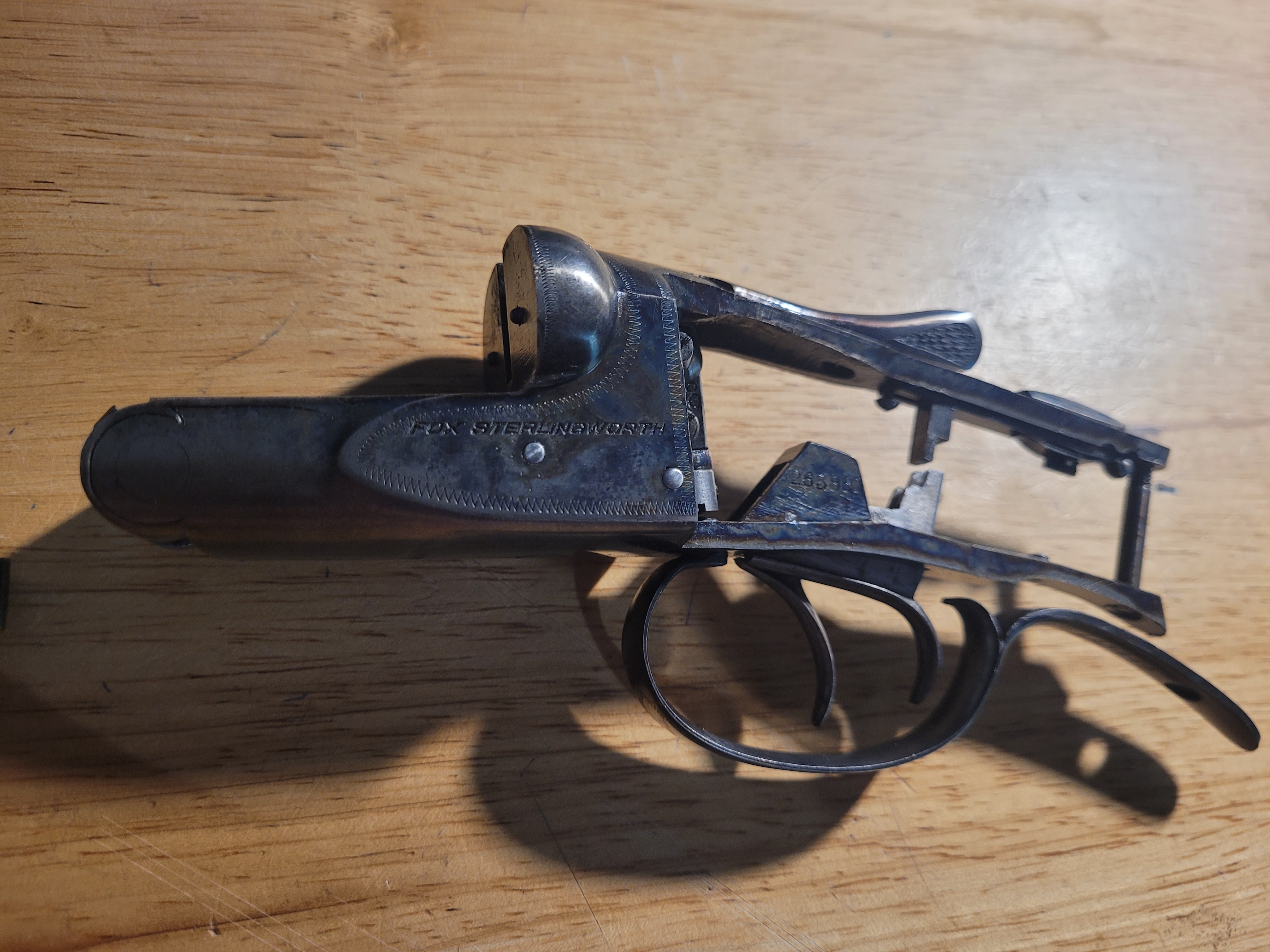

I've never used an acetone soak and ultrasonic cleaner on Fox parts or any other maker's for that matter. Just wondering, what's your experience with the case colors on the frame before and after? And how do you keep the re-assembled parts from internal rusting over time? Like this one, a Graded Fox.
My technique FWIW is to soak the parts in mineral spirts in an aluminum throw-away bread baking pan, and then blow off the parts with my air compressor with nozzle set at very low pressure. Pan and spirits go back into the container and are reused. This will remove grunge quite well and leave some mineral spirits in the microscopic pores of the metal for long term corrosion protection. frank

Immediately after removing from the ultrasonic I air blast them dry and then soak in a an oil bath. A mineral spirits soak is good too. I never give the parts time to rust before oil soak. I have not had any issues so far but I have only been doing this for a couple years now. Also I usually do not soak in acetone but as these had a layer of finish on the metal I started with acetone to remove the finish.
I am open to suggestions. This is not a business for me just a hobby so I learn as I go.
As far as color, I have only seen a better color after what I am doing.

Ok I got the 12 Ga fully disassembled but not with out incident. For three days I have been soaking and wrenching on the bottom plate screw and after a couple broken tips I resorted to gorilla tactics. I drilled out the screw. OH well it came out without any damage to anything else so not too bad.
I am editing my post above with gun specific information.

Silvers wrote: ↑Fri Jun 13, 2025 7:28 am I've never used an acetone soak and ultrasonic cleaner on Fox parts or any other maker's for that matter. Just wondering, what's your experience with the case colors on the frame before and after? And how do you keep the re-assembled parts from internal rusting over time? Like this one, a Graded Fox.
Frank, I recognize this picture from that great article you wrote for the DGJ 25th Anniversary issue (Winter 2014) "Right Move ~ Wrong Time" "The Road not Taken". My Fox brain is working pretty good this morning, funny because I can hardly remember what I had for dinner last night.
I agree that no matter how you clean the internals, a good oil soak is important before reassembly.

An alternate for a tight trigger plate screw: I’ve never failed to remove a tight one by clamping the frame upside down in a padded drill press vise, using down pressure on the spindle and using a 12" Crescent wrench to turn a hex sided arbor that's in the chuck and holds the Brownell’s bit. I need three hands to do that; one (my wife’s) to hold the vise with stocked frame from turning, and with my right hand on the spindle crank and left hand to turn the wrench. The screw is typically under tight tension, not held by corrosion, and the setup I described here makes it easy to break the screw loose. I’ll do everything I can to keep the original trigger plate screw intact because it was perfectly contoured to the plate during factory assembly, and so hard to fit/time and then engrave another one and have it look good on an otherwise original Fox. The same setup as described here can be used to re-tighten the trigger plate screw so it indexes to 12-6 o'clock.
All this FWIW. frank

12 GA all cleaned up, reassembled and is just needing a little more wood finish. What a great learning experience. BTW you can put the sear spring in the gun upside down and actually fully assemble the rest of the gun and then only know something is wrong because the sears will not cock.
I got the bottom plate screw timed, contoured and in and have a friend that can re-engrave the head for me. I will show that when done.
