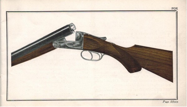

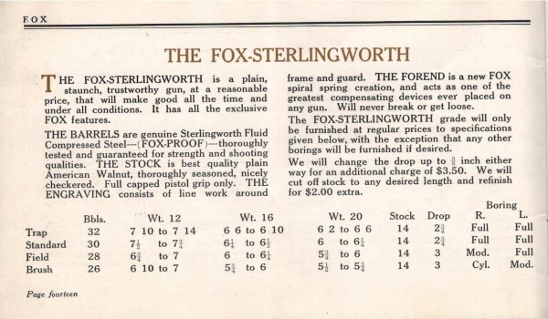

I'm 99.44% sure that 24-inch Sterlingworth barrels were cut after market. The Sterlingworth was an entry-level gun made to "standard" specifications. The factory strongly discouraged such out of the norm items for the Sterlingworth. From the 1927 A.H. Fox Gun Co. catalog --
You can get a letter on the gun from Cody to see how it left North 18th Street.
Detailed measuring of the bores and chokes will likely confirm the barrels were cut.
A handful of 24-inch barrel graded (A- to FE-Grade) Ansley H. Fox doubles are shown in the surviving production cards.
