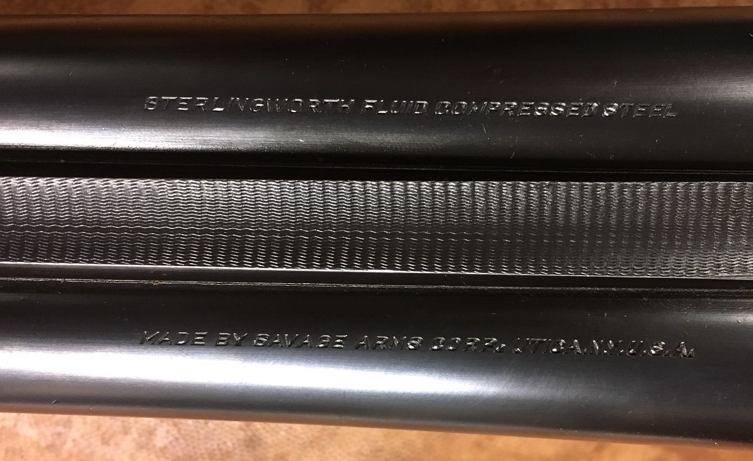

That is pretty odd! The 128xxx serial number range is where we see the transition from 12-gauge Philadelphia Sterlingworths to Utica FOX STERLINGWORTs. Also, a small nest of Utica guns, mostly 32-inch, in the 122xxx range.
I've recorded a few 12-gauge FOX STERLINGWORTHs with that large lettering on the sides of the frames in the 128xxx and low 129xxx range. The others I've recorded are marked MADE BY SAVAGE ARMS CORP. UTICA,N.Y.U.S.A. on the left barrel.

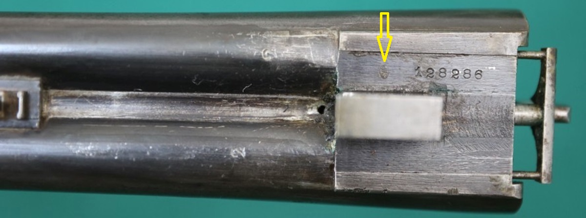

The gun in question doesn't have the FOX PROOF on the barrel flat and does have a strange proof mark to the left of the serial number on the barrel flat. That is where we often see the SP in an oval Savage Proof mark.
I can't quite make it out but it looks like SA? in the oval.
