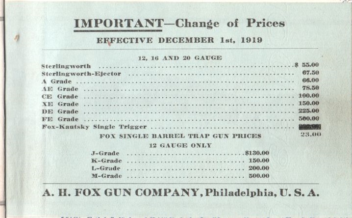

The Sterlingworth was introduced in 1910 as a $25 net selling price gun to compete with the Hunter Arms Co. L.C. Smith 00-Grade, Lefever Arms Co. DS-Grade and Remington Arms Co. K-Grade all of which sold for $25. Inflation, fueled by the unpleasantness in Europe, began driving prices up and during 1916 the price jumped to $30 and by December 1st, 1919, the price was up to $55.

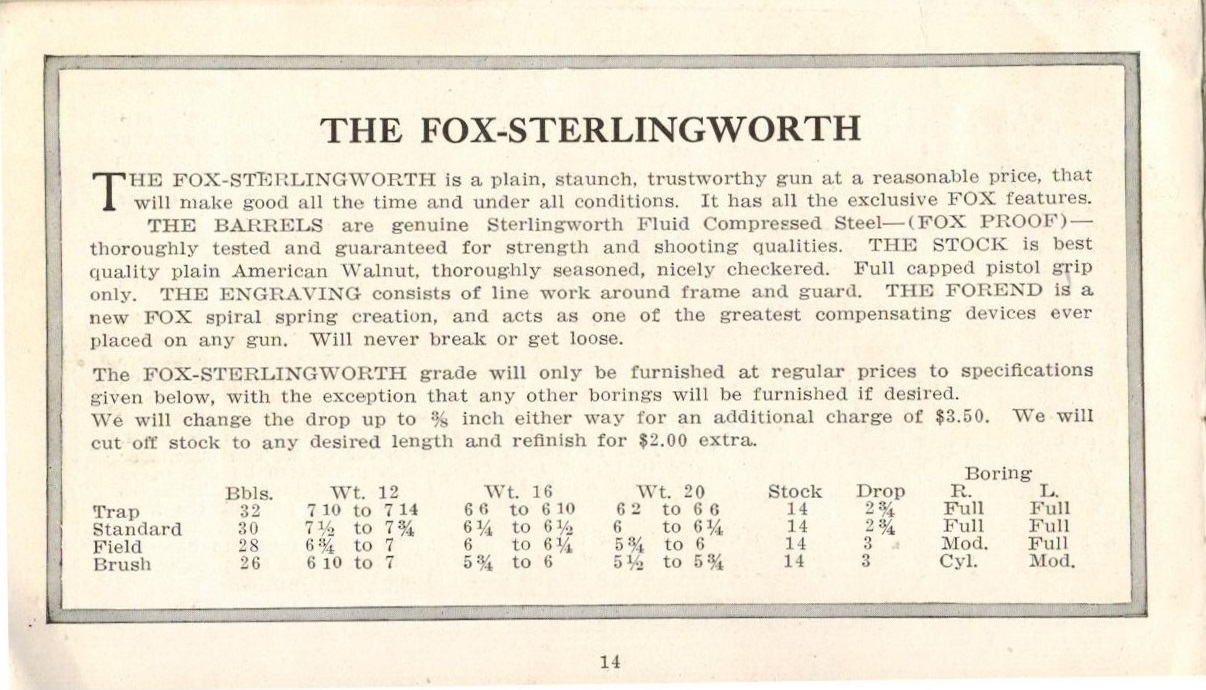

The Sterlingworth listing from the 1920 A.H. Fox Gun Co. catalog --
