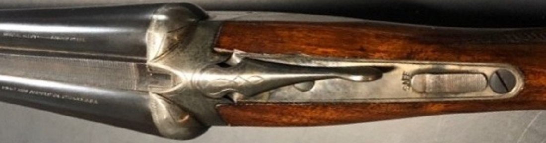

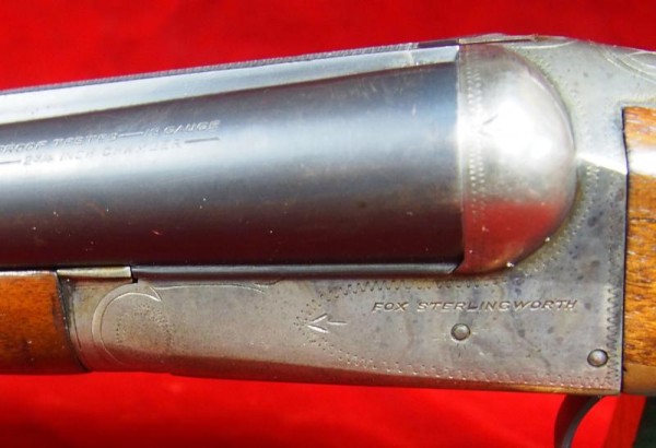

I haven't recorded any "Drawbolt" guns in the 132xxx range. The guns I've recorded from 132649 to 132927 are all Fox-Sterlingworths built on the flat-sided SP-Grade frames --
The "Drawbolt" guns have a wide top-tang with a slotted screwhead at the back. They are mostly in the 133xxx range 30-inch --

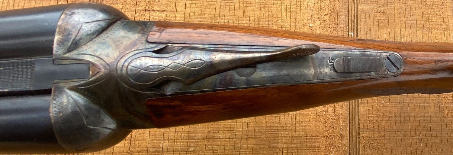

the 143xxx serial number block, mostly 28-inch barrels --
and the 161xxx range with 26-inch barrels --
