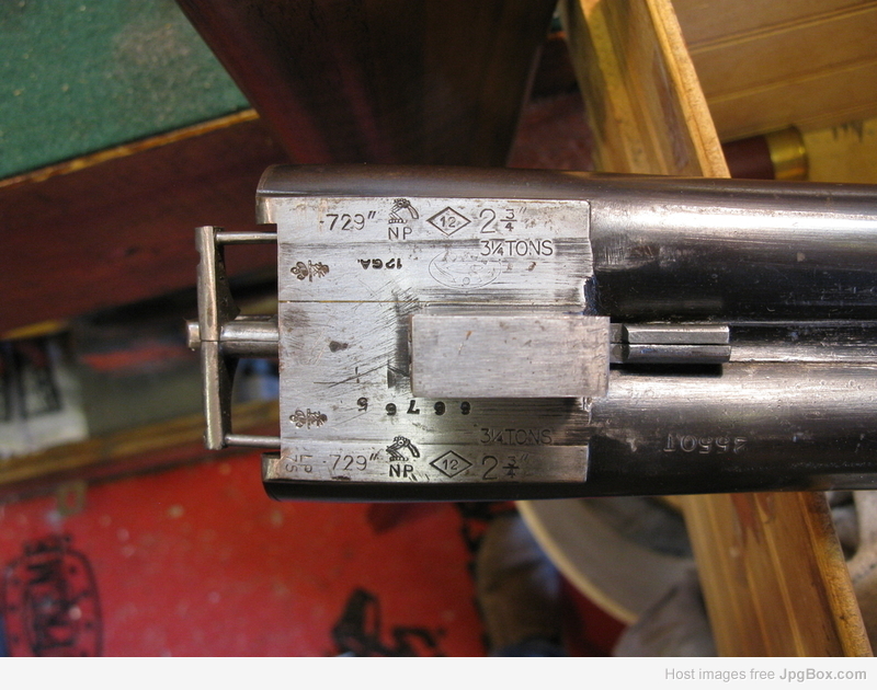

Below is a picture of the barrel flats of the shotgun I am looking at. Hopefully you can read the proof marks.
Posts: 2842
Has thanked: 895 times
Re: English Proofs
Nitro proof, done in Birmingham for 2 1/2" loads at 3 tons, or 8,960 psi (618 BAR), according to Burrard's formula for converting to psi.

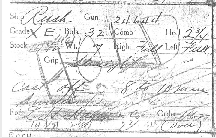

Here is the card for my 32 inch XE. Don't know what HOLD means but I think it might have been a cancelled order as my gun has standard barrel engraving and no swivels. It looks like some of the specifics were scribbled out.

the XE also has a round knob rather than a straight grip. Can anyone tell what it says between the date and serial number on the back of the card, looks like like Fox ------ -------?
Posts: 2842
Re: English Proofs
"Fox forend latch" ?
