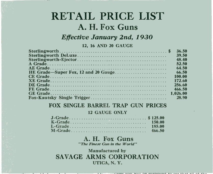

and a January 2nd, 1930, Retail Price List --

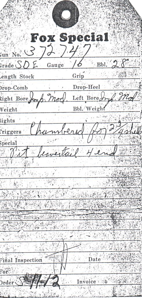

Deluxe was just a package deal for the options of a recoil pad and twin ivory sights. Even before they acquired A.H. Fox, they had been offering such a package on their J. Stevens Arms Co. and Springfield Arms Co. doubles. The guns were not marked in any way as a Deluxe, so the only way to be sure a Savage era FOX-STERLINGWORTH is a Deluxe is by a letter. When I got a letter on mine, John Callahan included photocopies of both cards. It was apparently originally built full & full with a slim forearm --
but an order came in for a gun with a bit less choke and a beavertail --
Very seldom when this sort of thing happened did both cards survive.

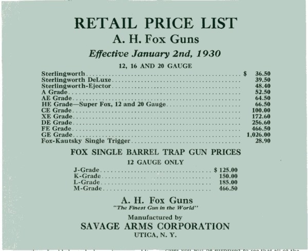

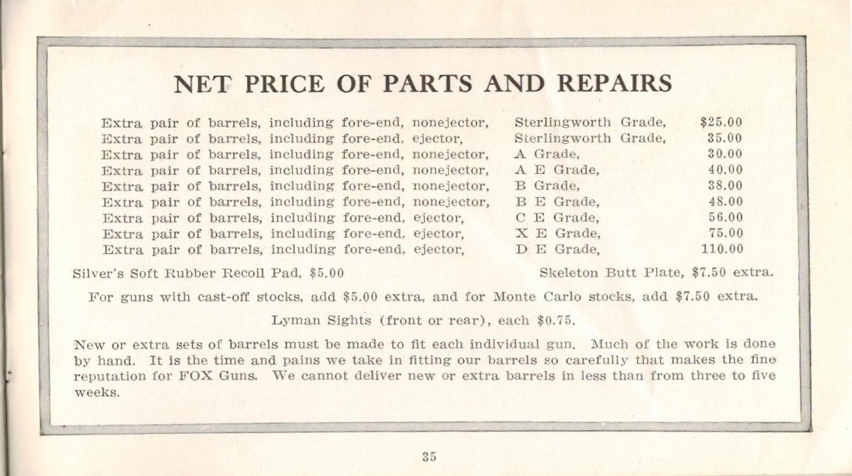

Some other observations. If the second set of barrels was done at the factory, each set would have its own forearm. If the gun was ordered new as a two-barrel set, they would be numbered 1 and 2 near the serial number on the barrel flat and on the forearm iron. If the second set was added later at the factory, only the new set would be stamped 2. See Tom Kidd's article on two-barrel sets in The Double Gun Journal, Volume Nine, Issue 3. Also, the mid-bead as I see them on the gun in the auction catalog are not in the location the factory would usually put them, they are nearer the breech. A Cody letter might say they were ordered there.

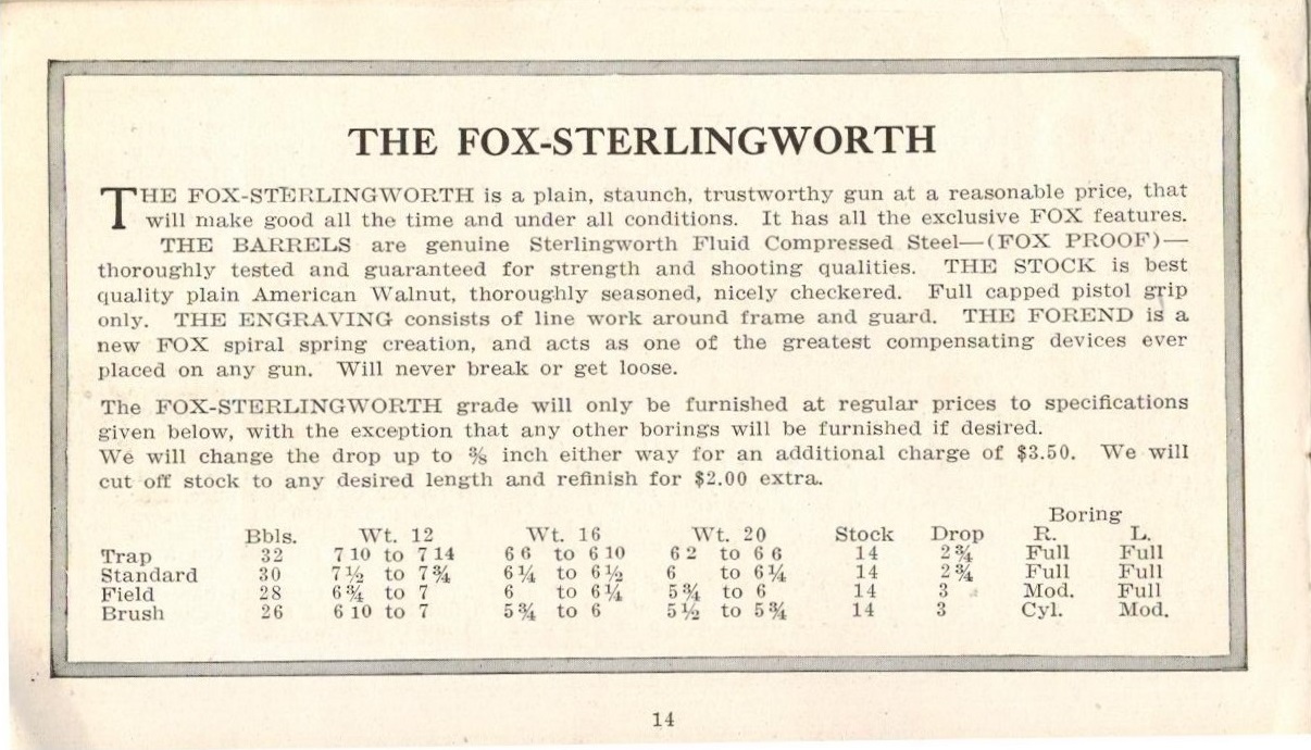

For your reference, here are the Fox-Sterlingworth pages from a 1920 A.H. Fox Gun Co. catalog --
and here is the page covering extra sets of barrels, Lyman ivory sights, and recoil pads.
