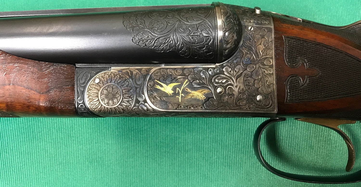

A nice bunch of NIDs just listed on GI yesterday.

Some nice ones for sure Dave,
I was discussing the number of Grade 7 NID’s produced with a friend the other evening.
Walt in his book had it down as being approximately 22 Grade 7 NID’s in all gauges, I believe that Keith Houtling may have helped Walt put these numbers together and of course, none of these numbers are concrete numbers, since you never say never.
There seems to have been a fair amount of Grade 7 NID’s have came to the surface recently, so we were really wondering if there may be more than 22? I was thinking of writing down the serial numbers of the different 7’s we’ve seen recently and in the future, just to see what comes to light.
I’m thinking you probably have this all covered already??
Thanks,
Stan

Re: Ithaca Super Ten
Those numbers come from a compilation of high grade NIDs, smallbores and magnum-frame NIDs done by someone at Ithaca in the 1960s and published in a Gun Digest.
As for No. 7E NIDs, I've got --
429598 -- 32-inch,12-gauge
443594 -- 32-inch,12-gauge
448878 -- 28-inch, 12-gauge, double triggers
448900 -- 12-gauge
457439 -- 32-inch, 20-gauge
457447 -- 20-gauge
461809 -- 28-gauge
467662 -- 12-gauge, double triggers

Dave,
I have 3 that I’ve seen to add.
454439 30” 12 gauge fully optioned
454486 30” 12 gauge fully optioned
467670 28” 20 gauge double trigger SF
Thanks,
Stan
