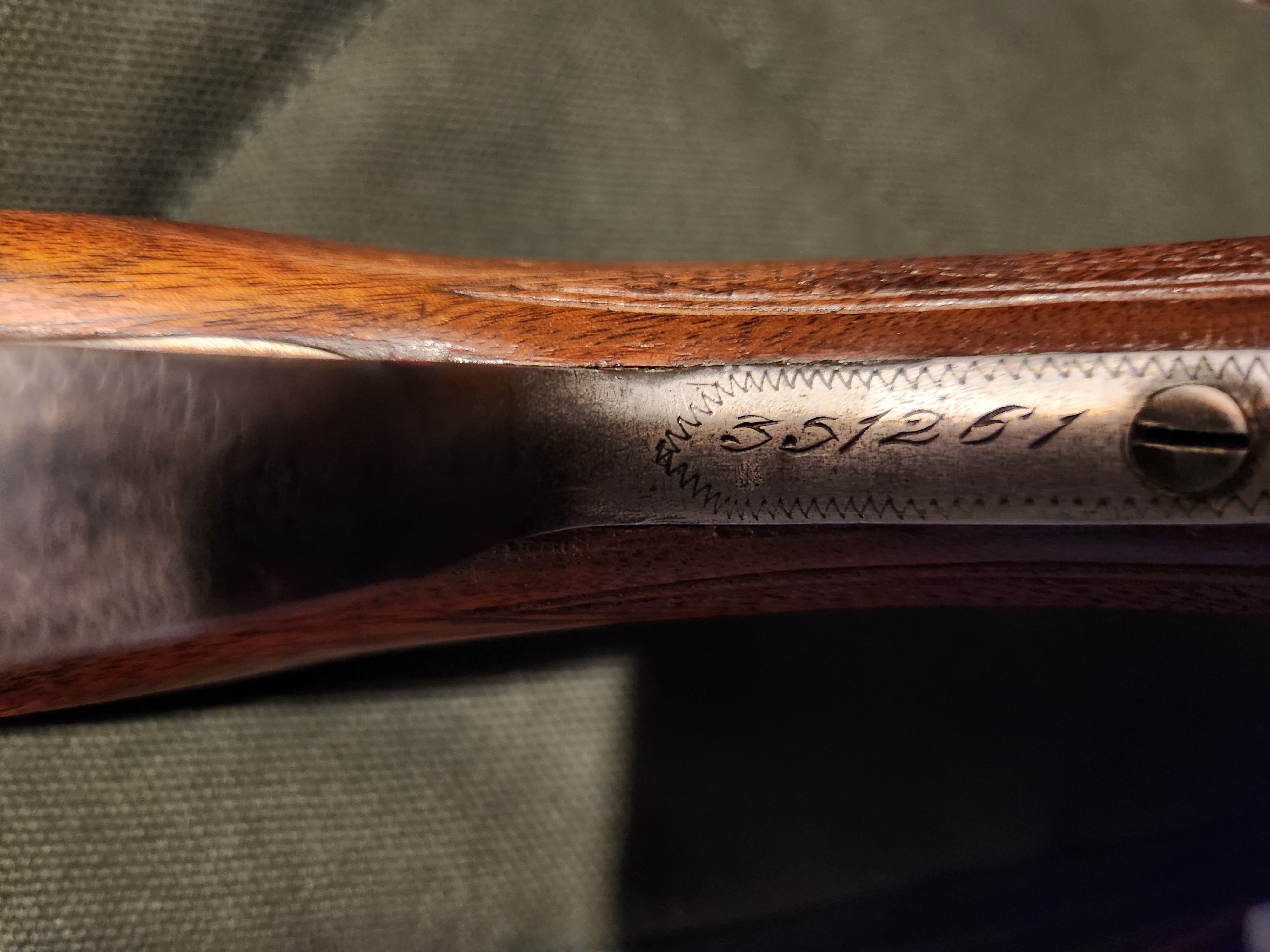

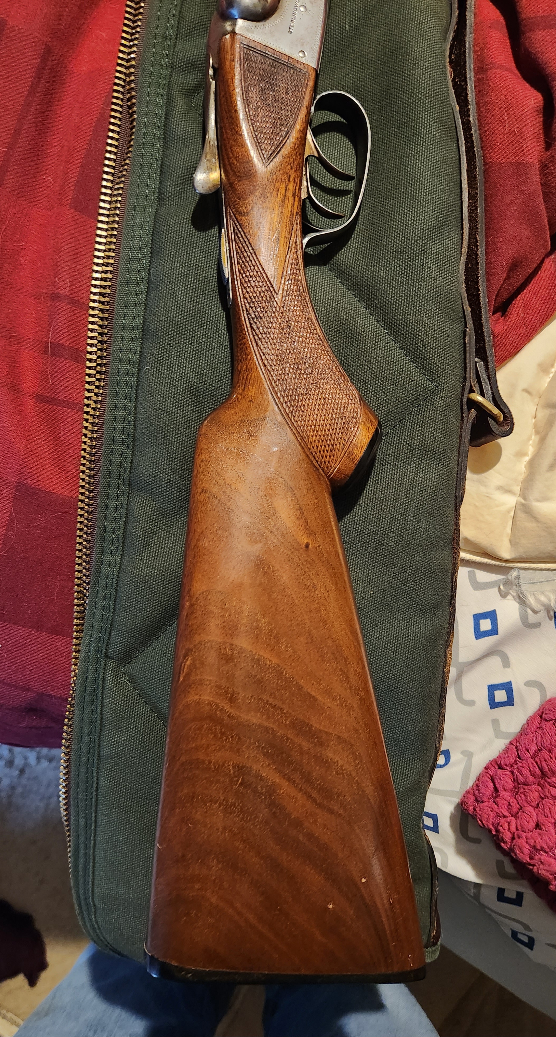

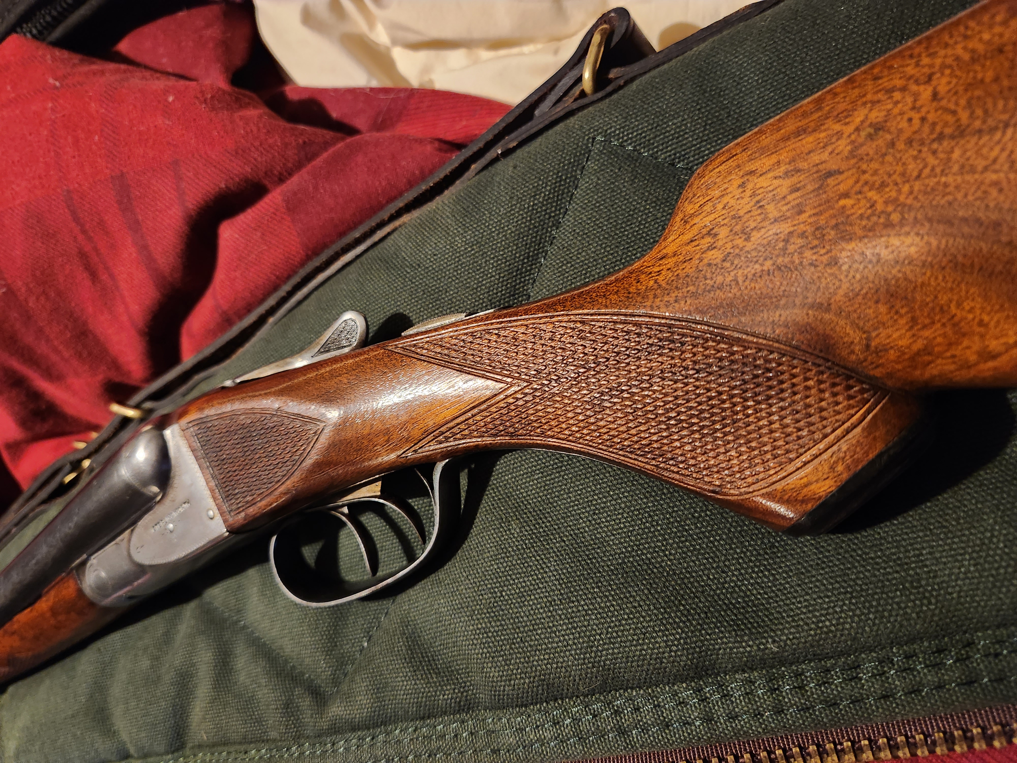

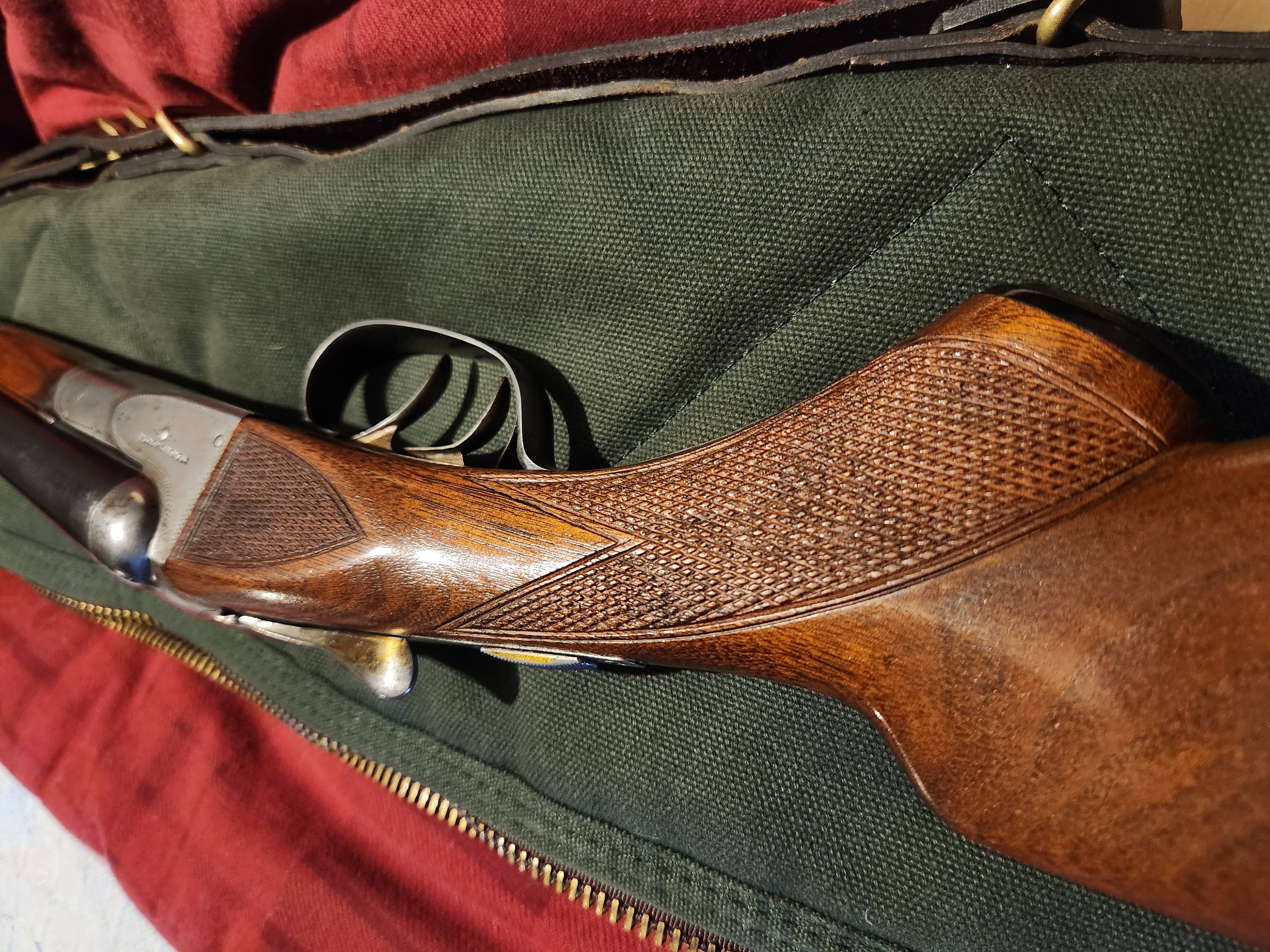

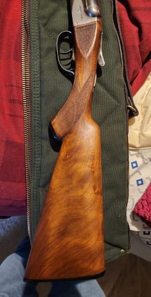

So I picked this gem up the other day. Nice early 16 gauge Sterlingworth. I bought a 12g Sterlingworth a few weeks ago from my local gun shop. I immediately fell in love with these guns. After I read that the 16g was built on a smaller frame I knew I had to have one as I mainly shoot 20's and 28's. Gun is in great shape with nice clean bores. It looks like maybe it was restocked with a nicer grade of walnut as my 12g Sterly is a plain straight grain stock. It also has checkering on the fences I believe they are called. The checkering matches the checkering on the stock which is why I believe it was restocked maybe at one time. Maybe someone can tell and shed some light on this as I am knew to the Fox guns.

It does look to possibly be a restock, but if so, nicely done. The checkered cheek panels are not a factory option on Sterlingworths. If it fits you, and you like it, a restock is infinitely better than a busted original, IMO. I shoot a restocked BE grade that is one of my favorites.

A Sterlingworth 16-gauge is a great gun for the uplands. Congrats!! A 16-gauge of the Philadelphia era would have had to have started life with 2 7/16-inch chambers intended for the then "standard" 2 9/16-inch shells.
