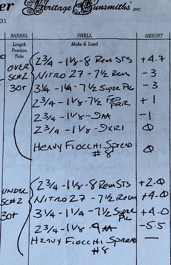

The OVER barrel of one of my Perazzis had a POI range of minus 3" to plus 4.7", and the UNDER barrel was minus 5.5" to plus 4". That was with five different commercial shells and three shot composites per barrel. And that was with an over/under. A side by side would likely have wider ranges due to horizontal torque from the recoil.
Net, we're shooting shotguns not rifles. Do some paper patterning with a range of shells and chose the one that regulates well in your Fox or whatever. Also I think anyone who makes blanket statements about Fox barrel regulation should be able to tell us about number of guns tested, gun details, shells used, etc. frank

Forgot to mention that we did the testing at 35 yards for his "Eyster #2" barrel boring and choke in both barrels, and thus the POI divergence (inches minus or plus) would be greater if shot at the regular 40 yards. Here' a snippet from the test report on one of the Perazzis.
