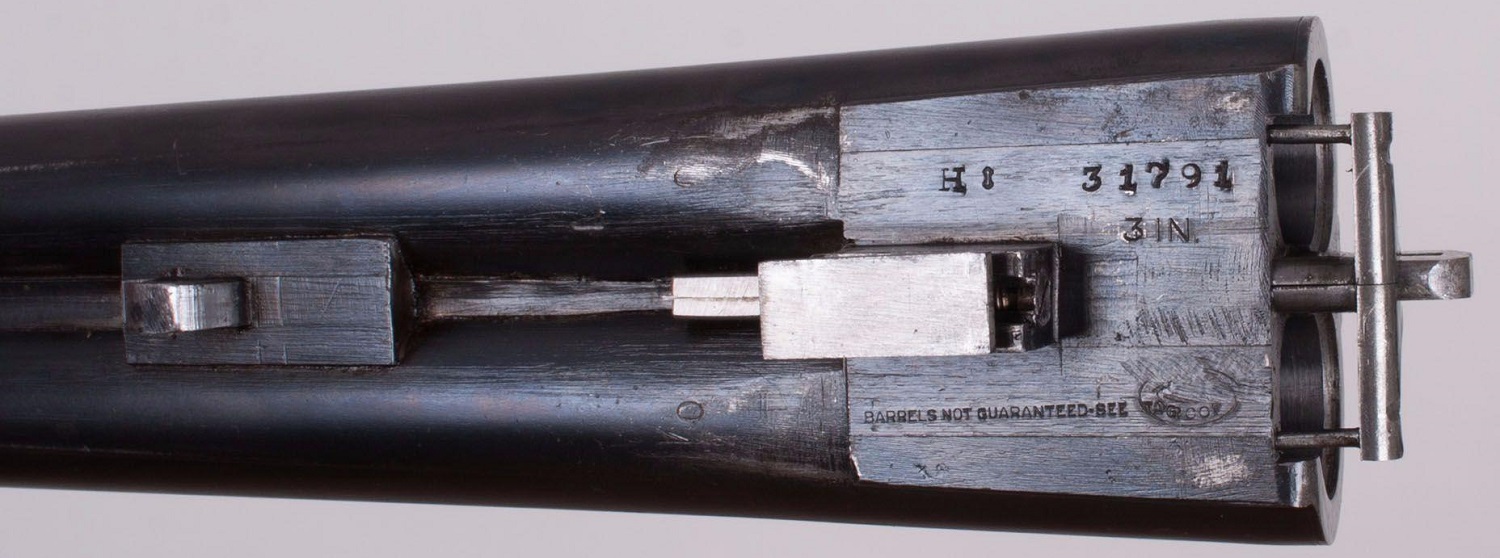

From the Super-Fox guns I've saved pictures of it appears the BARRELS NOT GUARENTEED SEE TAG stamp was used through guns made in the 325xx range. When they started the next batch of Super-Fox guns in the 33xxx range they didn't use it. Seems odd that yours doesn't have it. Guns near your serial number do.
Still waiting for someone to come up with the Super-Fox TAG.
