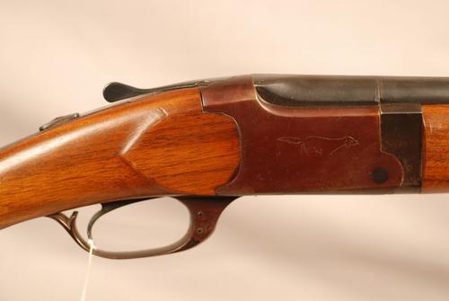

I don't know the answer, but we certainly see that from some attempts to reblue Winchester Model 21 and Marlin Model 90 frames --
Single trigger and Frame pre-War 16-ga.jpg (14.96 KiB) Viewed 5026 times

thank you for reply. it really does not look bad. hope no bad chemicals under ribs. i dont think it was re blued but have no way to know. :?
