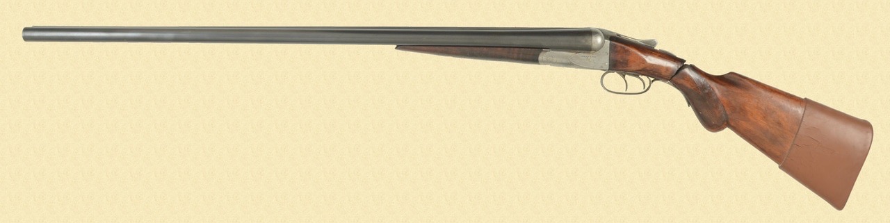

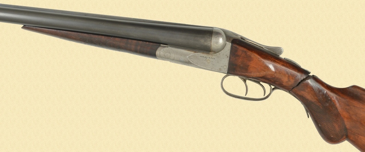

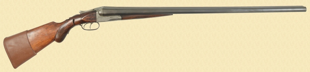

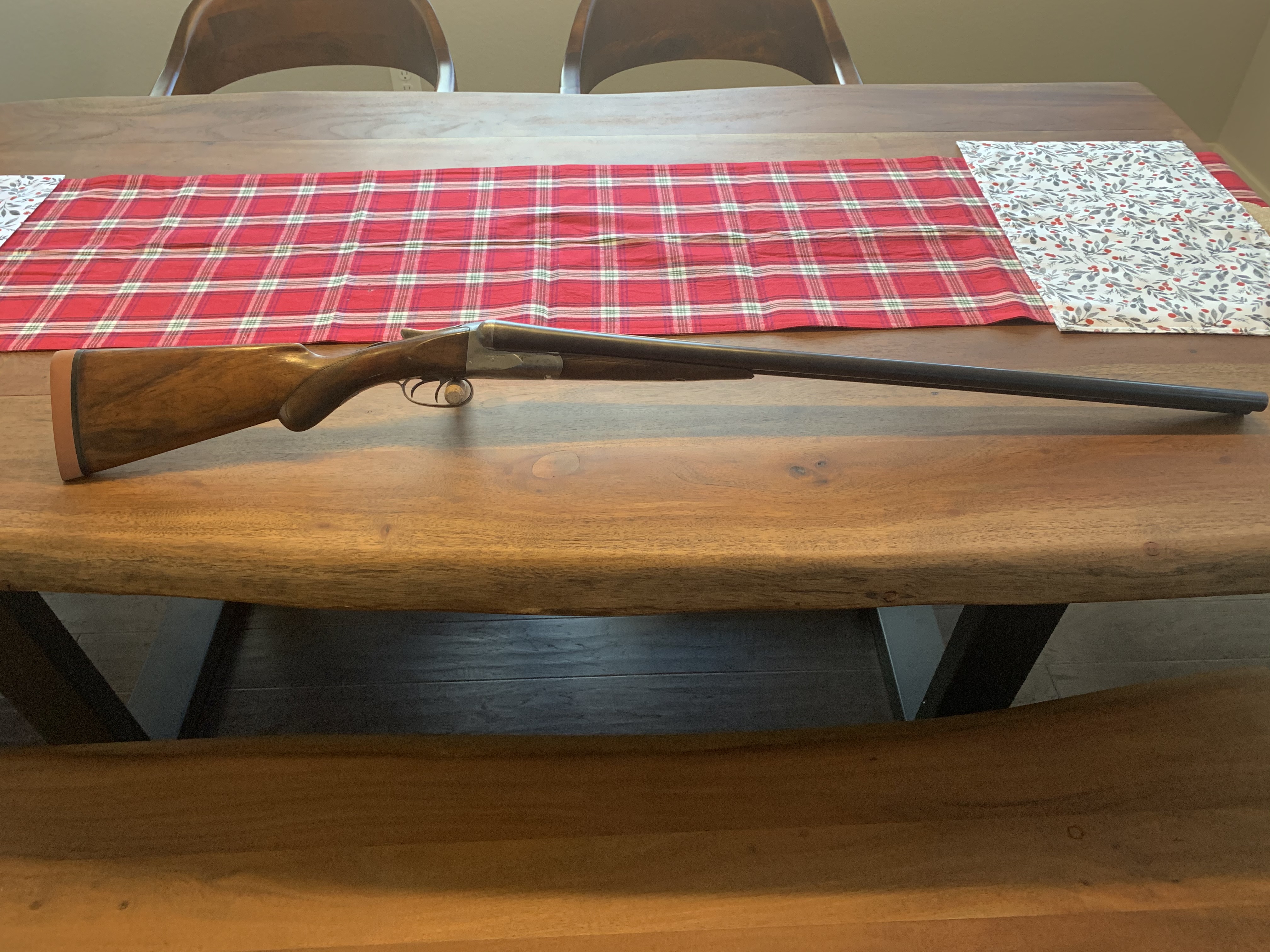

I purchased this Fox in November and just finished repairing the stock and getting it cleaned up. It is an early A Grade with 30" barrels and 2 5/8" chambers, choked imp modified and full.
Before (after to follow)

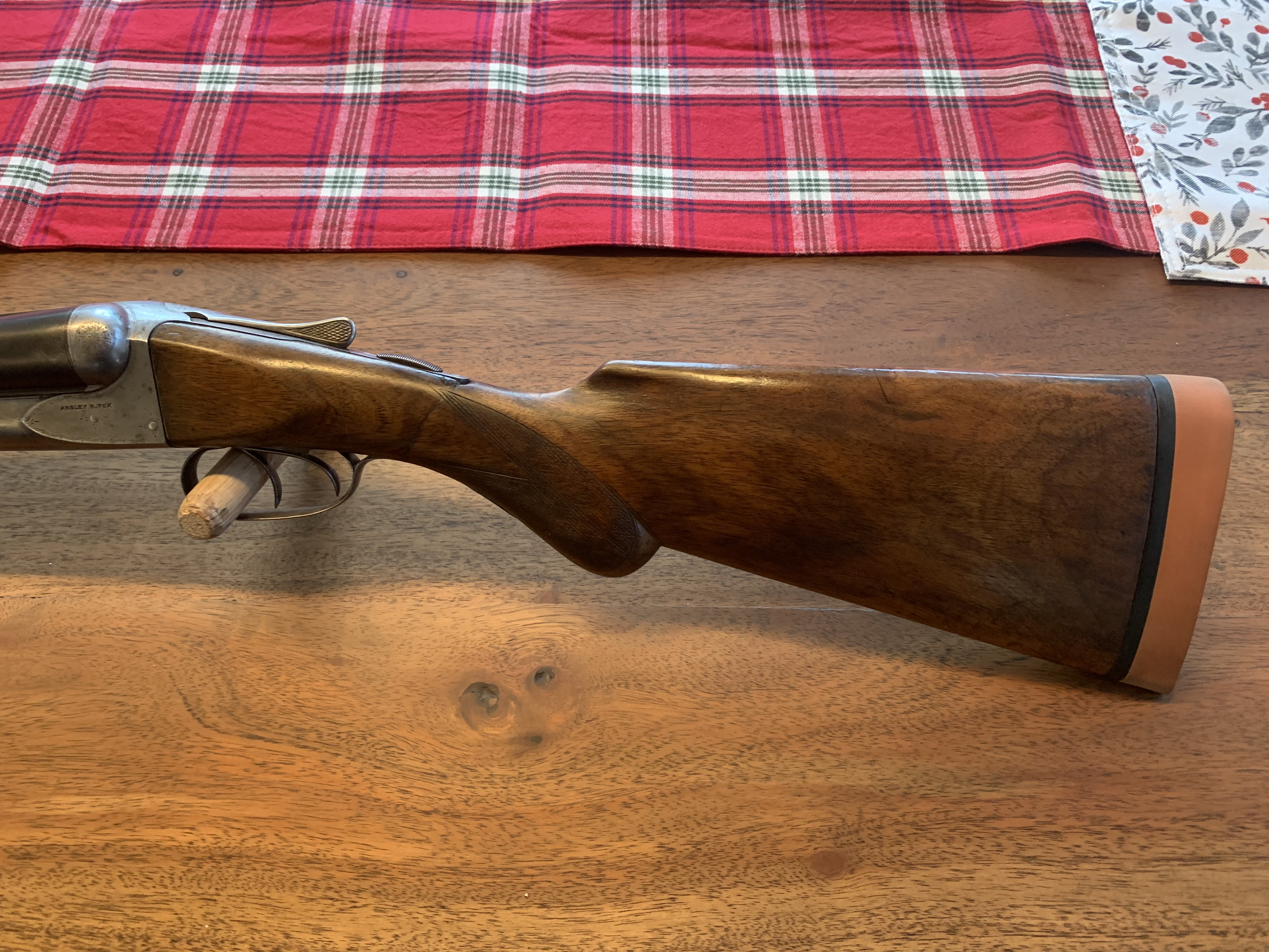

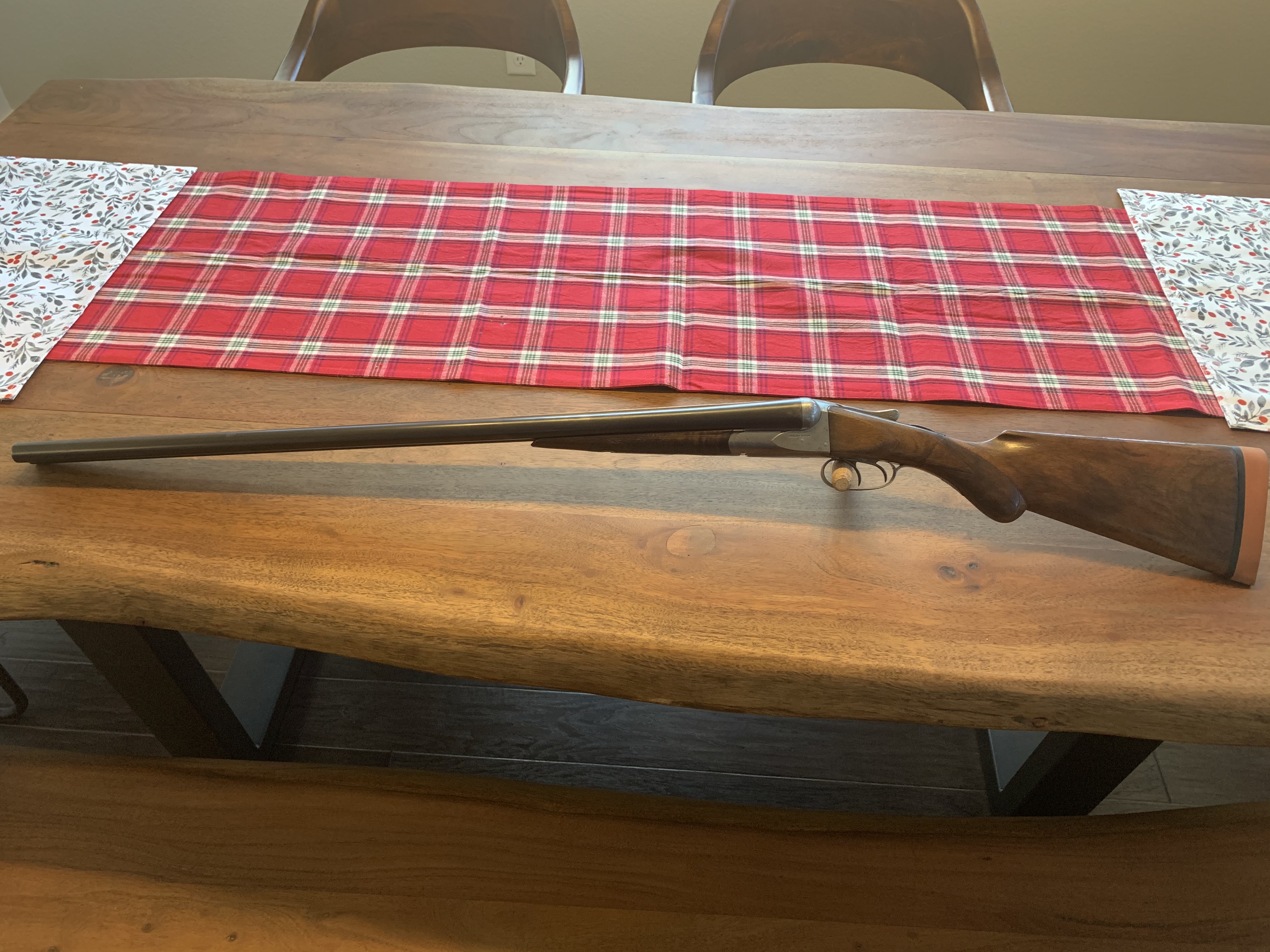

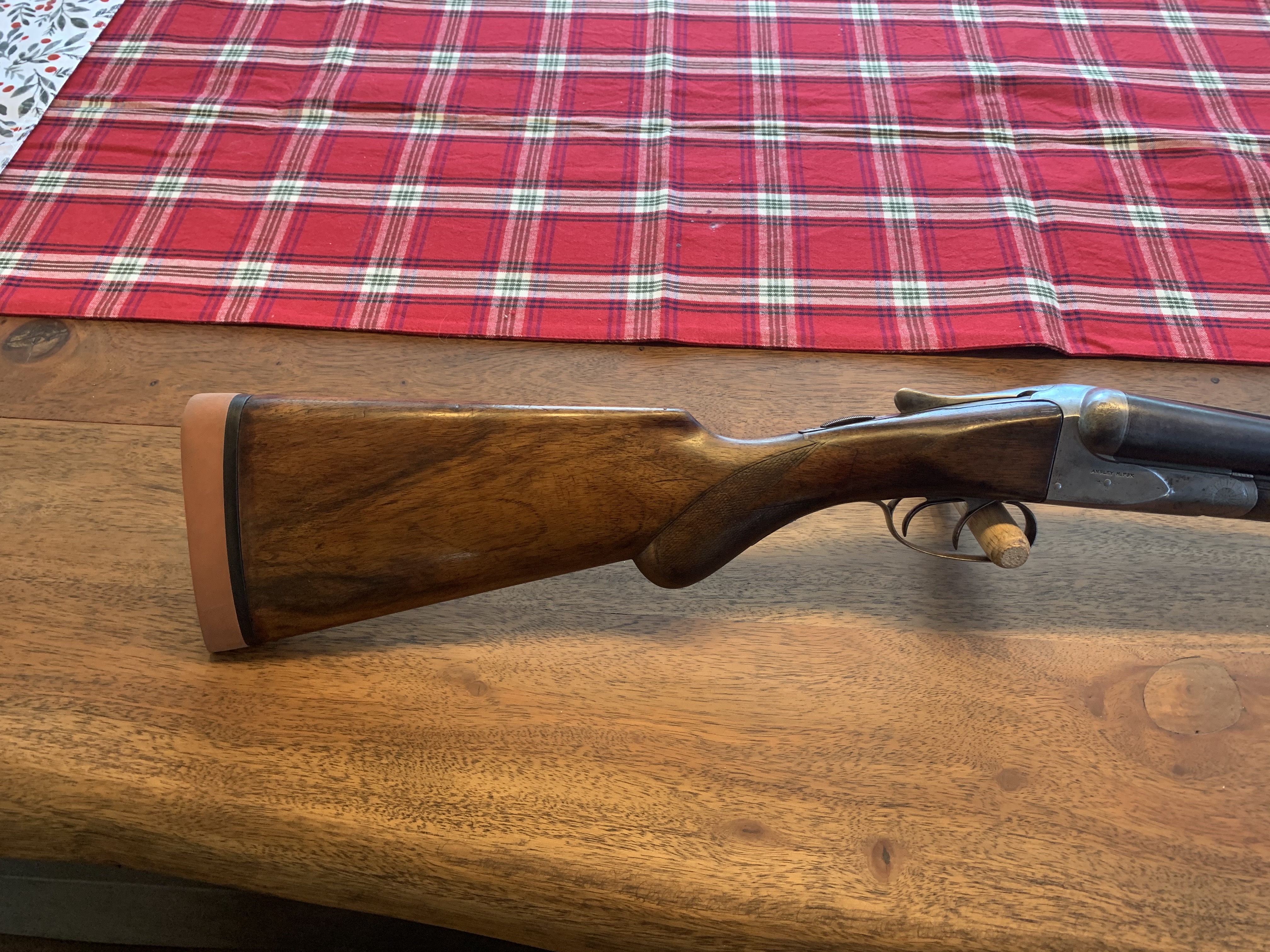

After

did you put a rod into the grip for strength?
Has thanked: 2882 times
Been thanked: 1791 times
Re: First Fox Early A Grade 12Ga
Great job "saving" an old shotgun. A "restock" looks pretty, but sometimes it's nice to keep them original. You did good, and obviously you've got talent that I don't possess :).
Chris35w
Posts: 7
Joined: Sun Mar 31, 2019 2:31 pm
Location: Loveland, Colorado
Post by Chris35w »
Thanks for the kind replies. There are 4 brass pins in the repair. I stripped off the remaining finish, it had been revarnished at some time as well as reblued. The new finish is French polish (shellac) and a new replica Silvers pad installed. My intent was to maintain the look of a 110 year old gun with all or most of its character.
