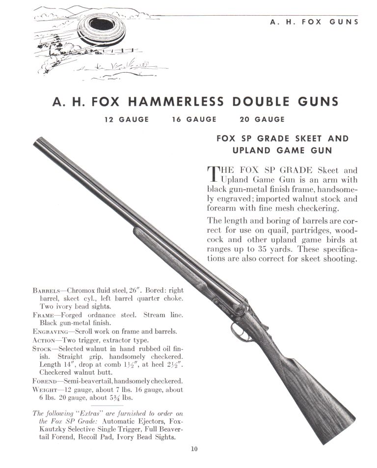

From the introduction of the SP-/SPE-Grade Skeet & Upland Game Gun in 1935, it came standard with twin ivory sights.
1935 catalog
1935 catalog
The twin ivory sights were optional on the Fox-Sterlingworth Skeet & Upland Game Gun when it was introduced in 1935 --
1935
1935
