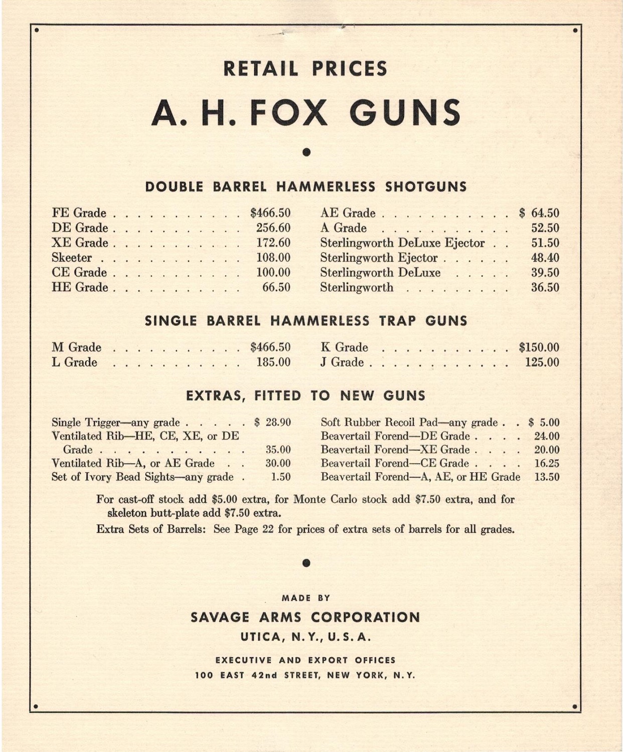

A beavertail forearm was never cataloged by the A.H. Fox Gun Co. during the Philadelphia years. The first Fox catalog to offer beavertail forearms was the Savage issued catalog with the Lynn Bogue Hunt cover picture that was used from 1931 to 1934 --
and the January 15th, 1931, Wholesale Price List and the undated RETAIL PRICES that equates to it --

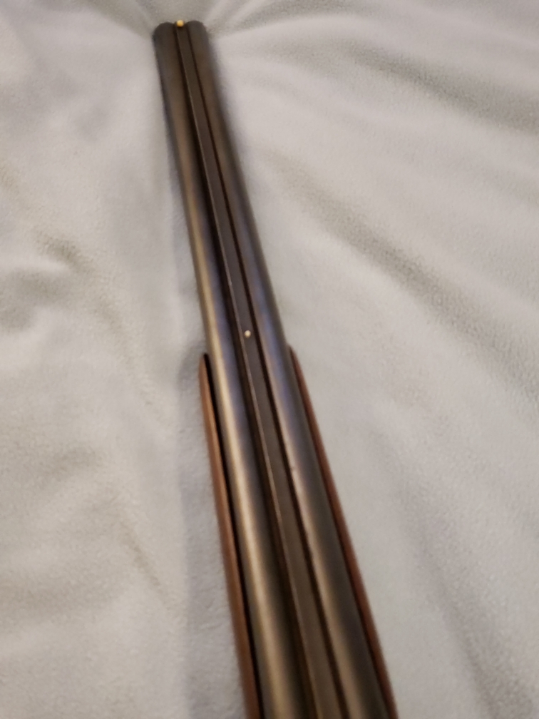

Will do. The shotgun is off getting some minor mechanical and stock work. I took a few pictures before I sent it off

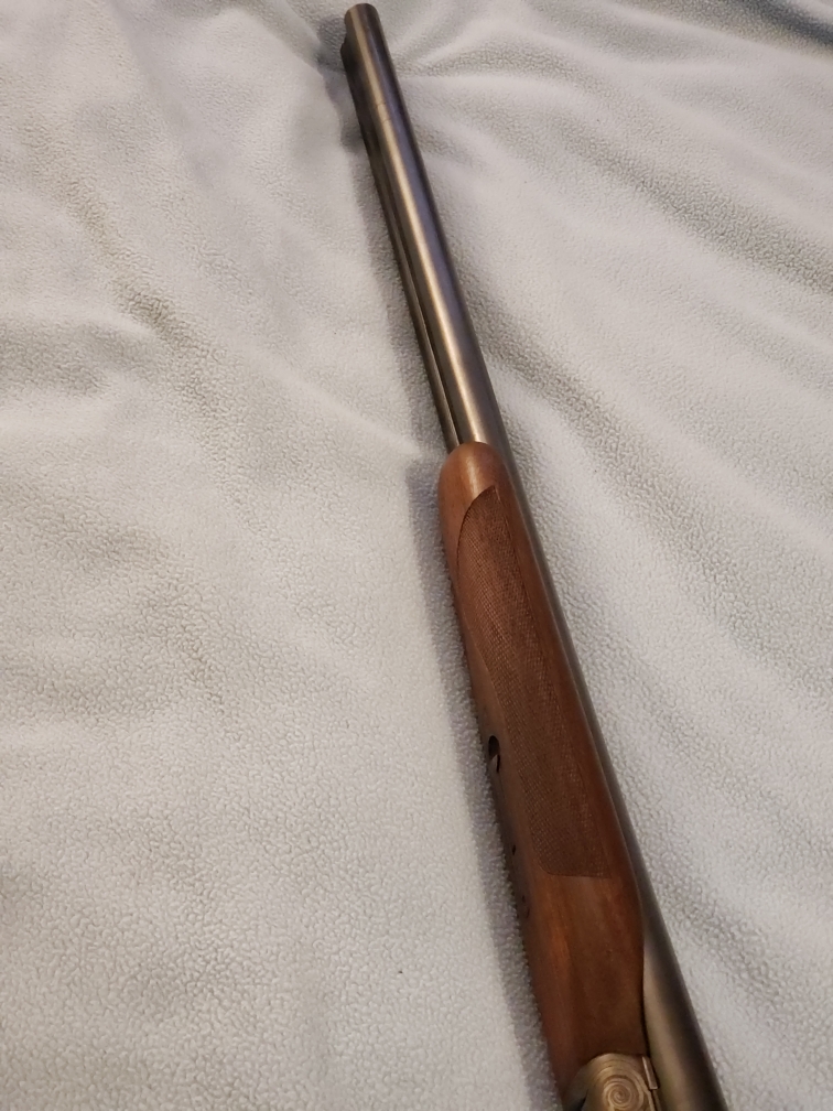

Beavertail

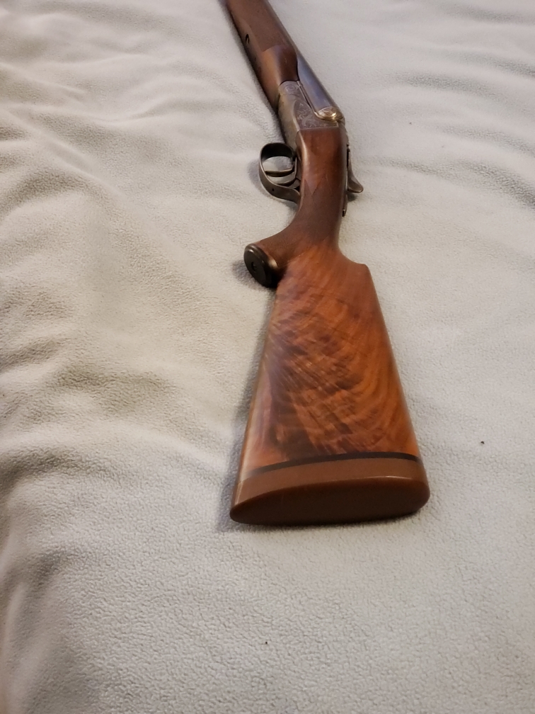

Additional photos
Has thanked: 1232 times
Re: Fox A with Beavertail Front Stock
Nice work; looks like a front and back end restock to me.

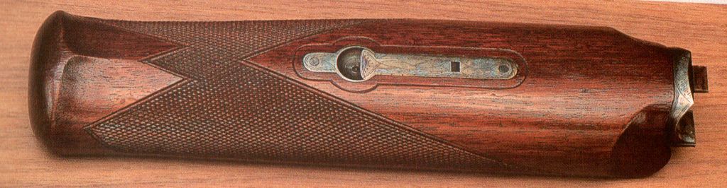

From what I can see in those pictures, the gun has been restocked both stock and forearm. Looks like the stocker got very close to a Savage-Era Skeet or Field beavertail forearm --

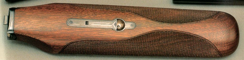

This is the Savage-Era Trap style beavertail --

I had questions based on anothe Fox A that I own (1923) with a splinter stock. Whoever did the stock work used decent wood and did an excellent fit on the recoil pad. I bought the shotgun to grouse and quail hunt so I'm very happy.
Thanks fot the help!!
