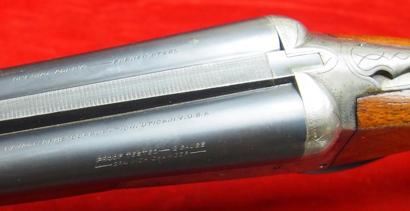

In answer to your question, a standard 12 ga. Sterlingworth of that vintage would normally have 2 5/8' chambers. The only way that would not be the case is if it had been sent back to Savage, after they took over A H Fox, and they recut the chambers to 2 3/4". Or, if someone else lengthened them. They were usually marked so if Savage did it. The chamber length will likely not be stamped unless they were lengthened by Savage.

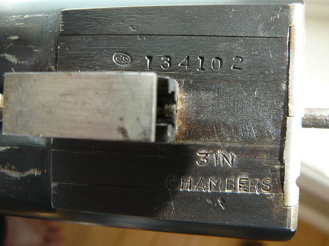

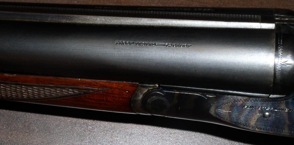

The SAAMI meeting where it was "suggested that our manufacturers start marking the chamber length on their guns was in 1937. Some Fox doubles that letter as shipping in 1938 have the chamber length markings and some don't. By guns that shipped in 1939 it is pretty constant.
The apparently didn't have a 3-inch roll-stamp, so did the Fox-Sterlingworth Wildfowls this way --

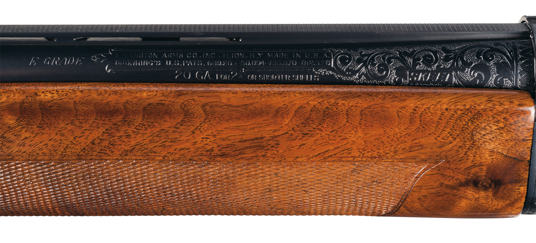

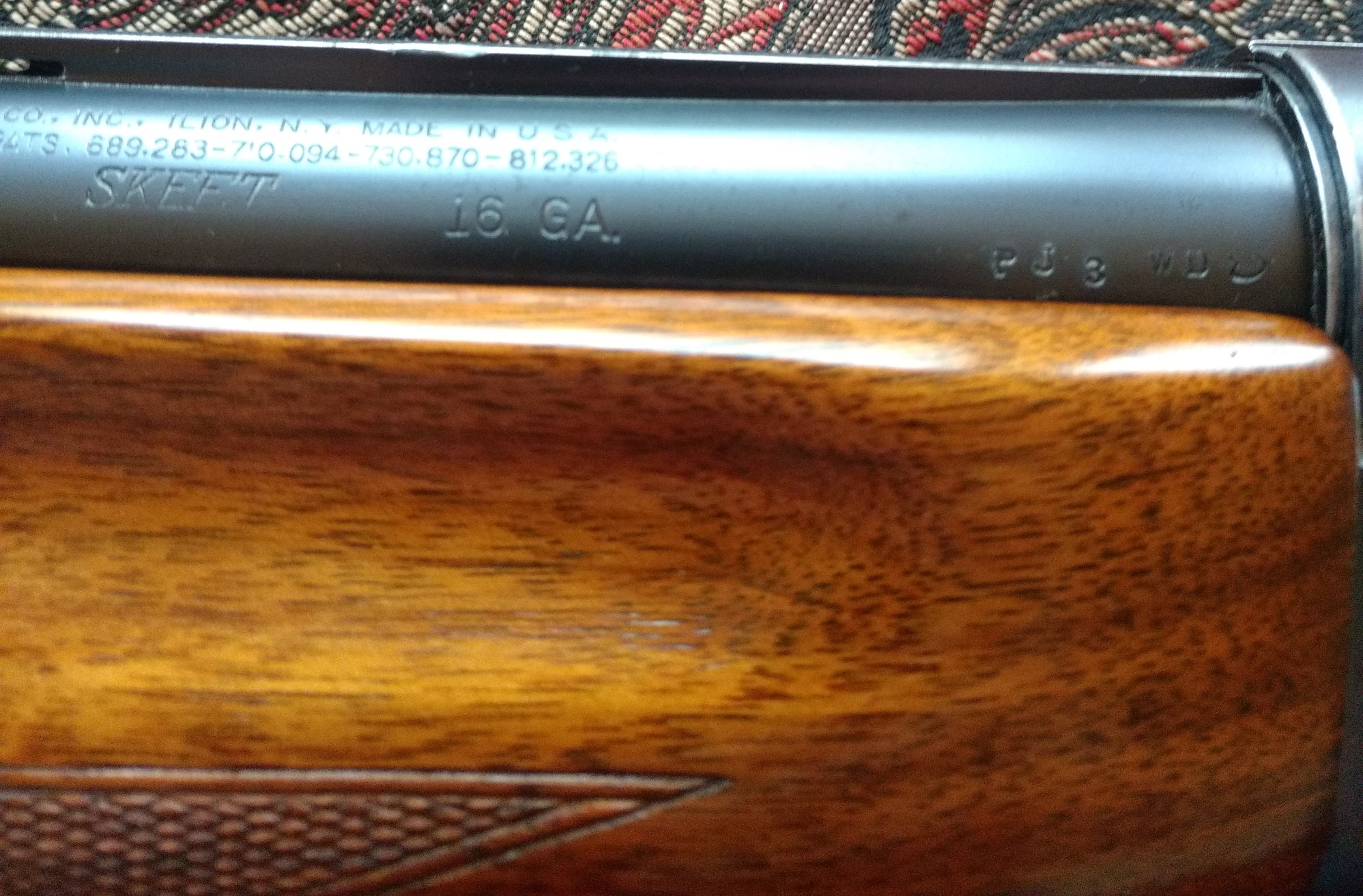

You find the same thing on Remington Model 11 & Sportsman autoloaders and Model 31 pumps. Up to about 1939 they are just marked with the gauge --
but by 1940 they are adding the chamber length --
Before the lawyers got involved our manufacturers believed their customers knew what they were doing!! Throughout the Philadelphia years if the customer requested longer chambers than standard, the only place that was marked was on the production card and possibly on the hang-tag that came with the gun, but I've never actually seen a hang tag for a long chambered gun. The exception was the Super-Fox and if it was chambered for the 3-inch shells the barrel flats were stamped 3IN.
