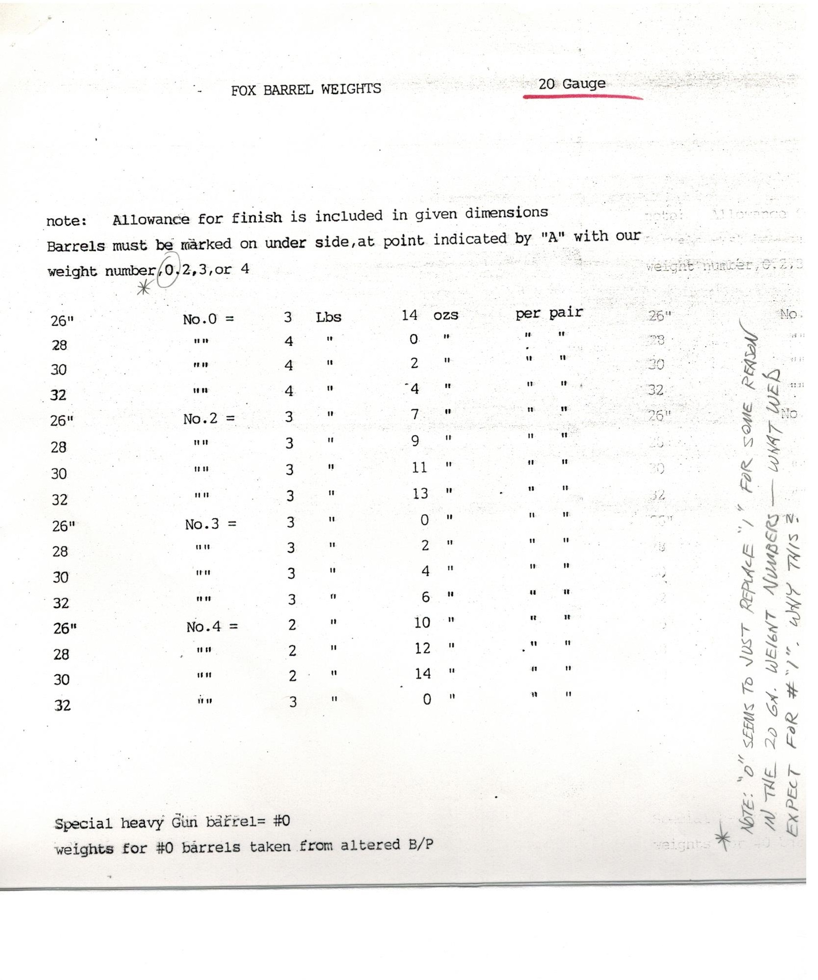

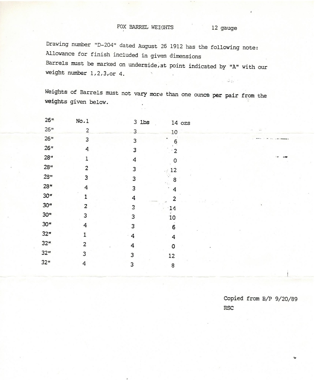

- Posts: 6123
- Has thanked: 427 times
- Been thanked: 2283 times
Re: MM's chart of barrel weights
It has long been my opinion that if Roe Clark had thrown those damn barrel weight charts in the shredder when he found them we would all be better off. They were only of interest to a worker in the Fox factory selecting a rough barrel set to get the finished weight he was working towards in the finished gun with the least amount of striking. All much ado about a number that may or may not remain on the bottom side of Fox barrels, and means far less now than it did when a Fox factory worker selected a rough set of barrels to make the gun.
FWIW, here are the photocopies of the original charts that Roe Clark provided to the Headricks back in 1989. When we were working on "the book" Bill Headrick provided copies of the charts to McIntosh and me.
Take note that on page 154 of the First Edition of "the book" the bottom line, for the 20-gauge 4-weight 32-inch barrel, should be 3 pounds 0 ounces.
I assume you're referring to 20-ga. barrels weights. Perhaps there was a typo in the 1992 1st Edition of the book, my revised 2nd edition is correct per the above chart.Researcher wrote:Take note that on page 154 of "the book" the bottom line, for the 4-weight 32-inch barrel, should be 3 pounds 0 ounces.
The statement "Allowance for finish is included in given dimensions" is confusing. What do you suppose it means? Could it mean that allowances been made for polishing, rust bluing, rib matting, beads, ejector/extractor slides or even striking?
Thank you for taking the time and effort to post the charts.
