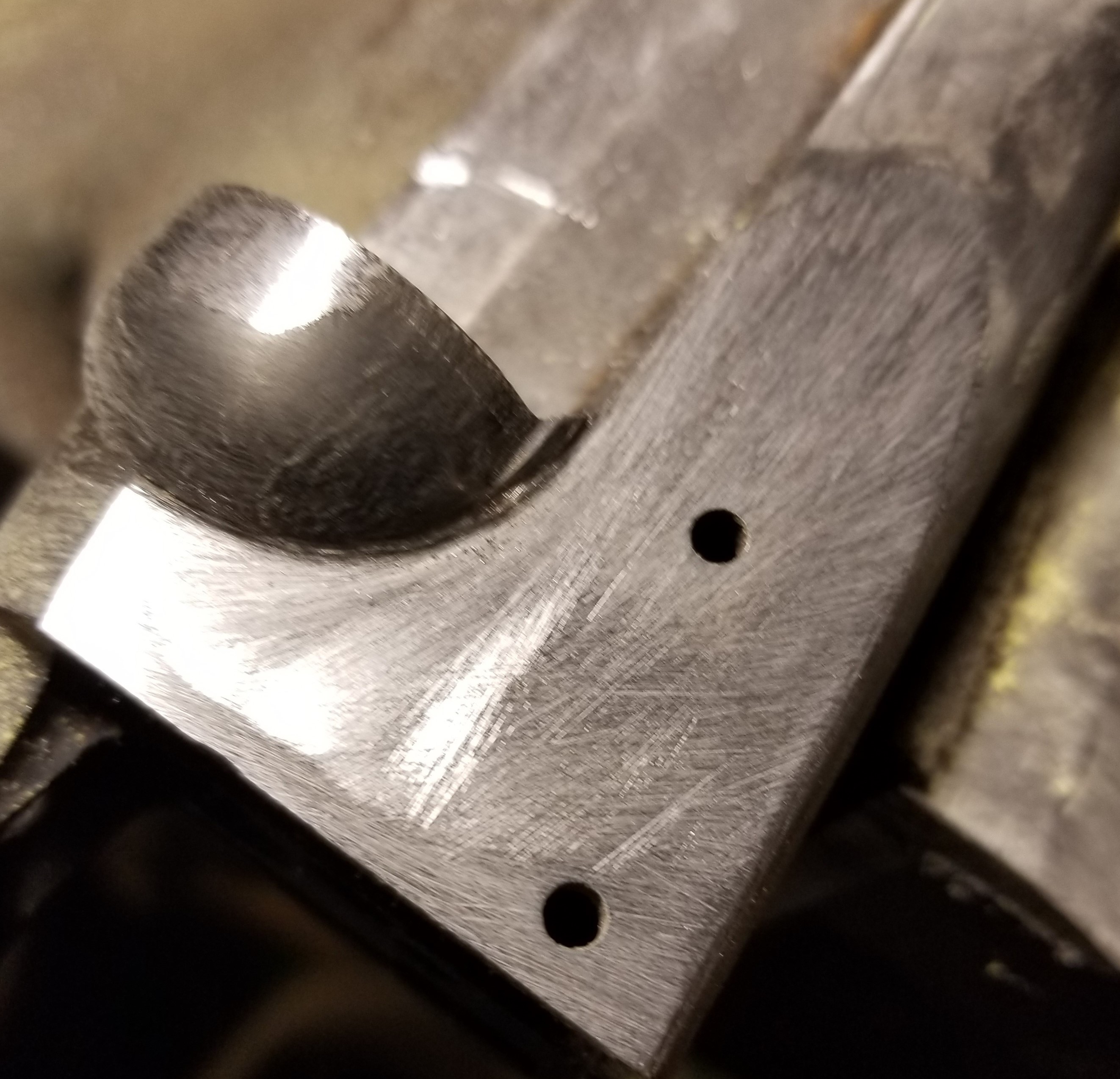

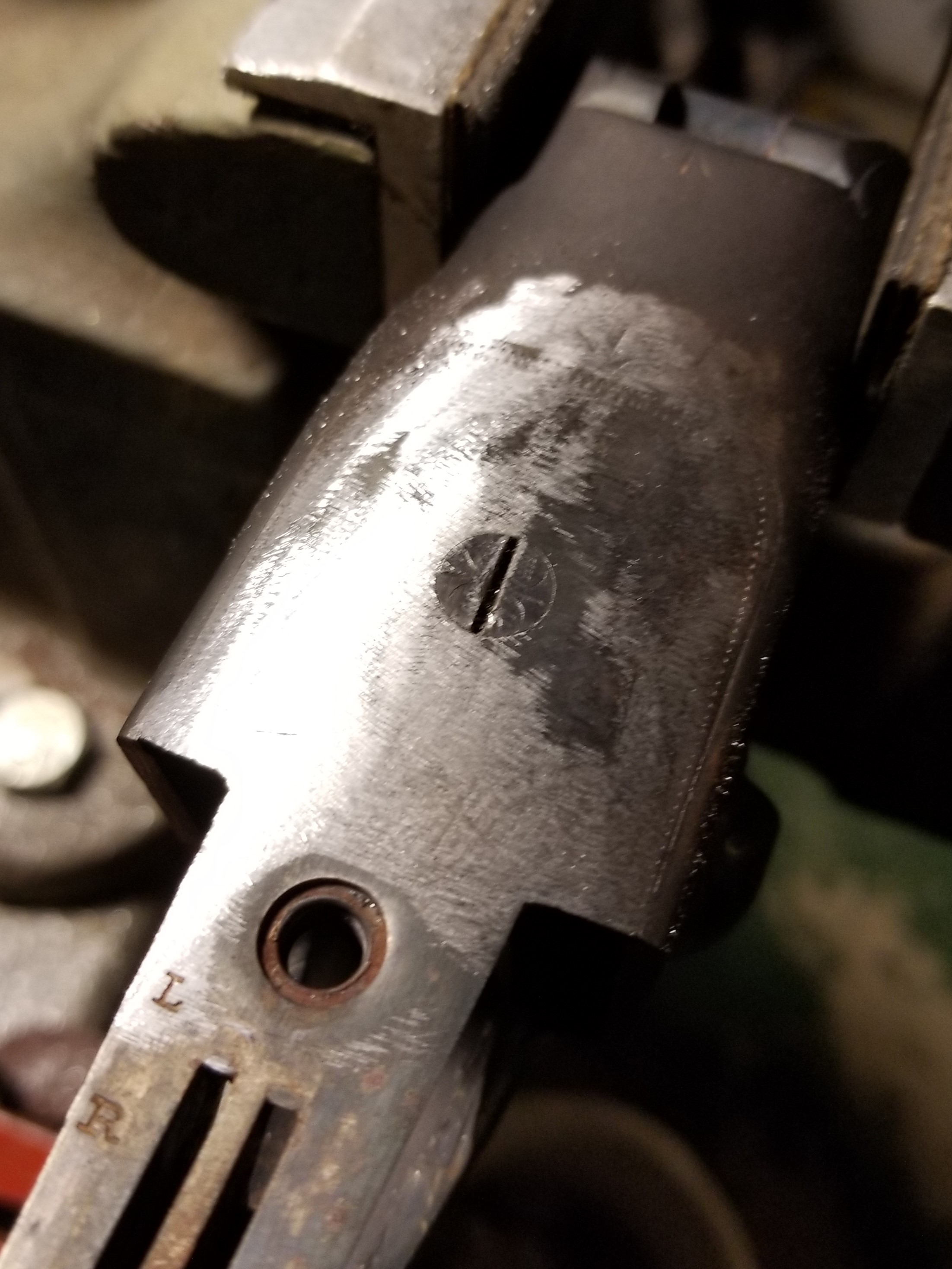

Here is the 20 gauge Sterlingworth made into a modern XE pattern. I had to do a lot of filing and sanding before I could even start the engraving. The leaf pattern was inspired by another upgraded gun I saw on this forum. I will be sending it out for case coloring soon. I will have to see how much of the engraving detail is lost after coloring. May need to french gray it, but that is up to the gun owner. The owner plans to upgrade the wood in the future. I will post some before and after pics. Enjoy, Tim

That turned out beautiful! Those Sterlingworth stamps looked rather deep and would require removing a lot of metal to get the frame down. Did you anneal prior to filing?

Yes the metal was annealed in my kitchen oven. Just running it through the cleaning mode is enough to soften up the surface.
