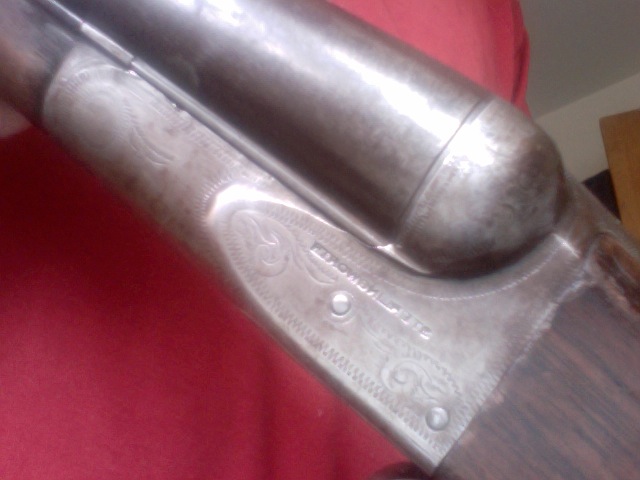

I recently purchased a 12 gauge Sterlingworth, with exactly the same "upgrade" engraving. It found it in Texas at a gun show in Jan 2012. The serial number shows it to be a 1913 model and it has 30in barrels, non ejector. It is in poor condition, not horrible, but I think I would keep it in original found condition. Will restoration hurt it, any thoughts from the group? I will add pictures if anyone is still active on this topic and would like to see it...

At the risk of catching the rath of some who might think otherwise, I'm glad that Fox did not standardize that bit of extra engraving if in fact it is factory. I think it looks awfully ametuerish and am thankful for the late style of engraving found on the higher grades. Still, from a collectors standpoint, I'd buy one if presented with the opportunity but would not pay a premium for it unless someone proved that it was a special run and factory original and therefore a rare variation.

Thanks for the reply Romac. I agree, the quality of the engraving is less than desired, but it is a Sterlingworth and not a graded gun so it should be spartan. I can't help but think it is factory due to the similarity among the few that have been identified across the country. But, I also agree that without proper verification of a factory testing of "upgrade engraving" possibilities, it will be hard to justify a premium price for these rare sterlingworths. I saw it, offered the guy a "low-ball" price, and he accepted. It is rough but safe and I have shot it several times with the same satisfied elation I have from my other sterlingworths. I didn't know if anyone was still following this post string, but since you did reply, I thought I would post a picture (not the best quality but you can get the idea of the engraving similarity to the 16 posted above). Thanks again for the reply...it helps us all keep the Fox guns alive!
