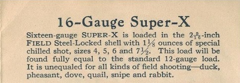

When Western Cartridge Co. added the 16-gauge 1 1/8 ounce Super-X load to their offerings in 1923, it was put up in their 2 9/16 inch FIELD shell.
From my research of Western Cartridge Co. catalogs I don't see a 2 3/4 inch 16-gauge Super-X load being offered until 1938. However, as soon as the Olins took over Winchester and changed the Winchester "Speed Loads" to the Super-Speed they were putting up these 16-gauge progressive burning powder loads in both the 2 9/16 and 2 3/4 inch hulls.
The 2 3/4 inch 16-gauge shell really began to get some traction when Remington Arms Co., Inc. introduced their Model 11 and "Sportsman" autoloaders in 16-gauge in 1931, chambered for 2 3/4 inch shells. While Remington's regular Nitro Express 16-gauge progressive burning powder load was put up in a 2 9/16 inch hull with a load of 3 drams equiv. pushing 1 1/8 ounce of shot, for their new 16-gauge autoloaders they introduced the slightly faster Auto-Express with a 3 1/4 drams equiv. charge pushing 1 1/8 ounce of shot --

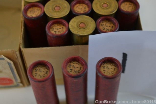

While I don't see extra length cases offered for their progressive burning powder loads by Winchester, Western or Remington, Peters offered to put their High-Velocity loads in any length case the customer wanted.
I've never found these Remington ARROW EXPRESS 3-inch 20-gauges offered in any catalog, but here they are --
